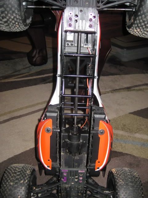

Question to a fellow 1/5 Flux owner. Does your TCS kit have all of these sideways TVPs stiffeners or did the previous owner of my buggy add those?
I want to mount my batteries inside the chassis, but two of the posts are in the way.
http://i182.photobucket.com/albums/x...x/IMG_4989.jpg
OP, more questions. What foam did you use on your roll bars and how is your battery mounted?
http://lh5.ggpht.com/_dcy74CG15Qk/S7...0/IMG_4924.JPG
thzero 07.13.2010 09:05 PM
Yes....came with lots. I only use a few. See my gallery link in original post. Has lots of pictures on how I mounted my batteries internally. I used some rubber from some wire I bought at HomeDepot.
Bmr4life 07.13.2010 10:26 PM
Thanks. I just took a few of them out including the front diagonal piece. Got it looking like yours. The battery tray should be simple enough to make. I'll be using velcro straps to hold them in place.
