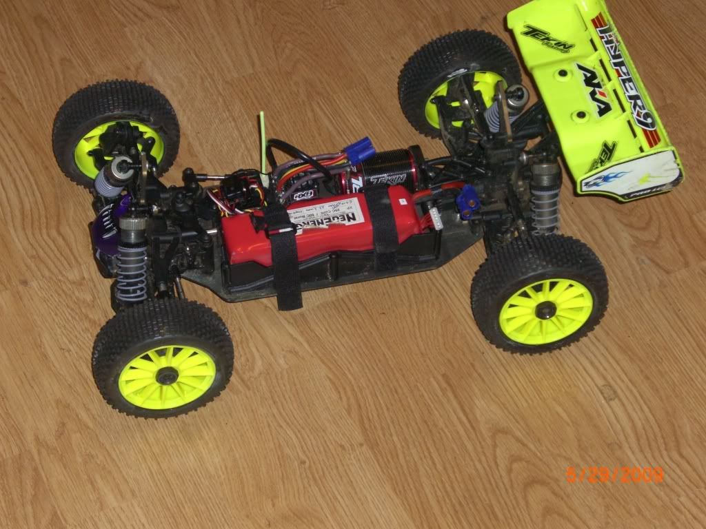

gixxer 05.29.2009 11:17 PM
Made a few changes today. Took out the receiver mount and put the esc directly on the chassis. Now with 6s pack I am just under 8lbs (7lbs 15.5oz)
