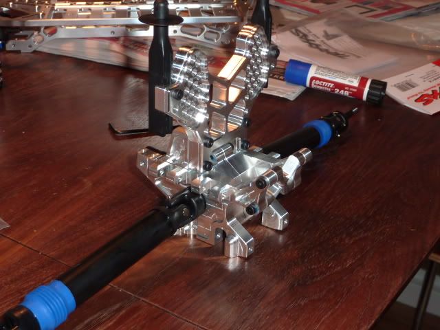

i have the 3905 tranny and FLM outputcup for the center, how do i put them together?..

Maxxrickard 11.20.2009 04:01 PM
to the outputcup i have to use one 4mm set screw but the out putshafts from the tranny have a opening to fit the traxxas stockcentershaft. the 4 mm screw will land up in the opening.
i would like to put the set screw on a flat area , but the only flat area on teh output shaft have a opening.
do you understund?or do i have to post at picture?
JoFreak 11.20.2009 04:30 PM
I think I understood...
I had the same "problem" with the tranny of my old maxx back when I still was planning to use ist. I just put the screws where the hole is and tightened them. As long as the diameter of the screw is lager than the diameterr of the hole, this shouldn't be a problem.
Use threadlock!
Maxxrickard 11.20.2009 04:36 PM
okey i will try that..maybe use a long screw and a nut?
JoFreak 11.20.2009 05:53 PM
no, only use one set screw, you want as much friction between the surface of the drive cup and the tranny outdrive, und you don't get that by applying pressure from opposite sides of the drivecup
Maxxrickard 11.20.2009 05:59 PM
okey i get it:-) maybe the opening in the outdrive is good.

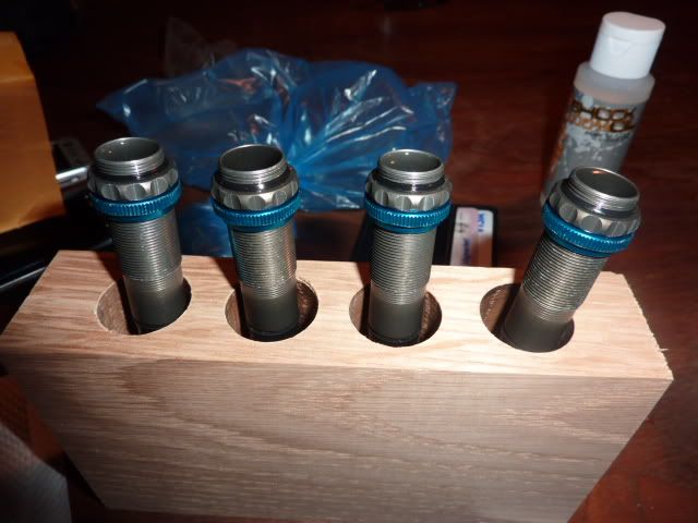

i have change oil in my diffs. 7000 in front and 3000 in rear. but the front moves easyer than the rear, i wonder if i have to little oil.
is it possible to put the diff back in the wrong way...i did not force it togheter but i wonder if the small things inside are in the right position..
suicideneil 11.25.2009 04:48 PM
When putting oil in the diffs, the best way I found is to put the spider gears in, then put the oil in until its almost overflowing, then put the ringgear/cap back on which also holds the remaining spider gear- tighten the screws in a diagonal pattern (1,4,2,3, as though they are numbered left to right, top to bottom). Assuming you didnt miss out any gears or gaskets, and you didnt also fill the diff housing itself with oil, then when you try turn the wheels in opposite directions (on the front end, not connected to the tranny), you should feel more resistance vs the rear end. There shouldnt be any/ very much backlash between the diff and pinion gear either when you rotate the pinion shaft by hand.

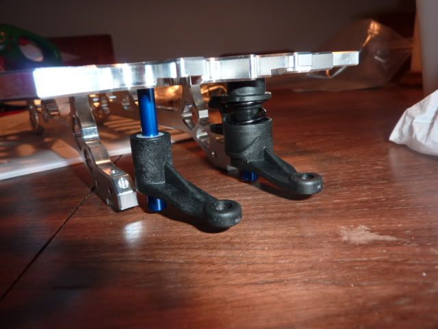

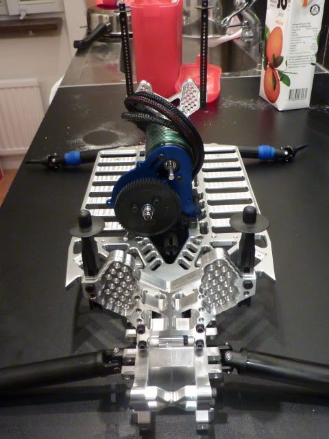

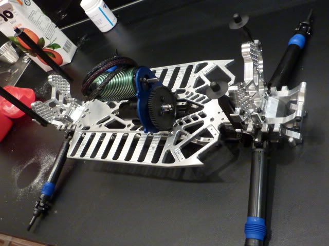

i have FLM hinge pins and RPM arms. i have to trim the arms. but what is best, trim everything on one side or little on each side?
update:
[IMG]http://i613.photobucket.com/albums/t...d/P1010070.jpg[/IMG]
[IMG]http://i613.photobucket.com/albums/t...d/P1010075.jpg
[/IMG]
[IMG]http://i613.photobucket.com/albums/t...d/P1010102.jpg[/IMG]
http://i613.photobucket.com/albums/t...d/P1010109.jpg
http://i613.photobucket.com/albums/t...d/P1010111.jpg
http://i613.photobucket.com/albums/t...d/P1010113.jpg
http://i613.photobucket.com/albums/t...d/P1010005.jpg
http://i613.photobucket.com/albums/t...d/P1010007.jpg

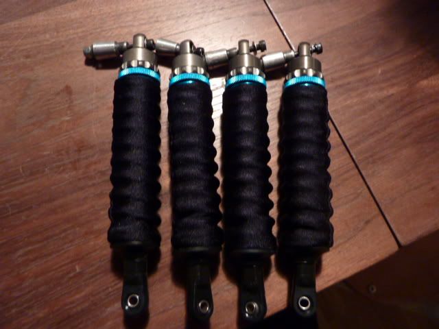

suicideneil 11.26.2009 07:26 PM
You can shave a little off each side of the arm to make it fit, probably best so that you end up with an even finish, not one side thinnner than the other (its only like 1mm so not overly critical). Nice job on the shocks, they look great, as does the rest of the truck- where did you find those really long rear posts ( square? )?
