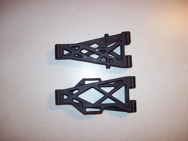

Who in the LST users of this forum has tried to flip the rear A arms around to have the shocks to the rear and a longer wheelbase? I'm curious about that.

Would it really give you a longer wheelbase? I just glanced at my Muggy and it doesn't look like it would. It would also give you toe-out, right? Unless I'm missing something.

edit: I looked again and saw the toe would not be a problem

yes I'm talking about flipping the arms but the hubs stay on their respective side. The arms swoop to the front so by flipping them, they would swoop to the back and give a longer wheelbase, close to half an inch just by looking at it. I would like to go to the track this Monday and try the truck as it is now. If it's a bit too squirrely for my taste, I might try flipping the arms.

here's what I see when I flip a set of arms:

mistercrash 05.22.2010 08:53 PM
Well it is obvious now that it would not make the wheelbase longer. :oops: If I had a set of extra arms to do what you did there on that pic, I would have seen it clearly. It must have been an optical illusion from looking at the arms while they are on the truck :whistle:
Now I wonder why some have chosen to do it :oh:
brian015 05.22.2010 09:03 PM
Me too. :yes:
edit: Maybe with LST1 arms it made a difference??
re-edit: nope, I found a set of LST1 arms in my box-o-parts - they have no difference when flipped either.
