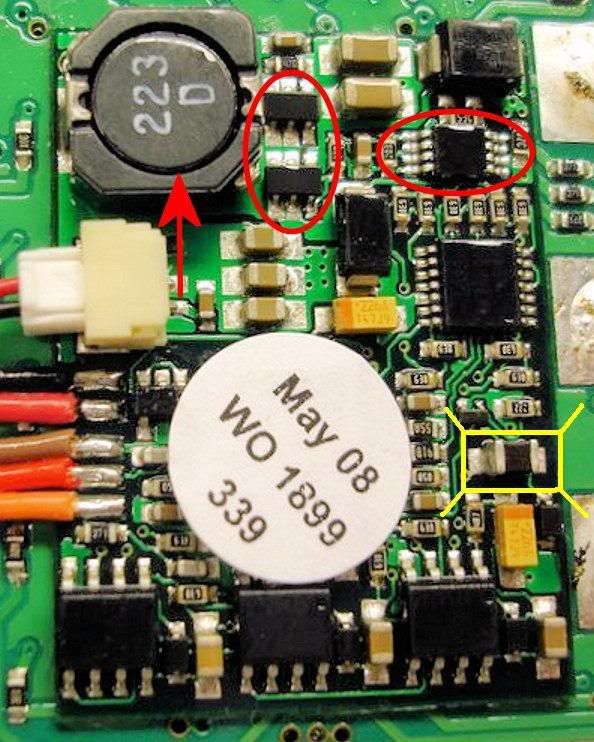

I certainly think the constant pounding the brain board takes due to the fan plug and case design could be contributing to the inconsistant component failure points on the board.

I do need to let you know you were right about my 'fishy' comment on the BEC and the Micro processor. On most of our ESCS the BEC (if they have one) and the 3.5 volt power supply for the Micro processor are separate. On the MMM the on board switching regulator does supply power to the processor power supply which ultimately lowers voltage to 3.5. So in the case of the MMM, if the BEC failes the processor quits working. My mistake.

Not to sound like a upity dumbass, but I successfully performed the mod on my MMM to remove the bec components. I did not use a soldering iron, just a single edge razor blade. After carefully removing the noted components, and triple checking the lack of any stray parts or bridges, I fired the esc up with a rx pack. No problems, and I ran the truck for a hard 20min bash session. Still works fine.
I would definately not suggest this mod for most people. I am very good at fixing small items, and have extremely steady hands. I am sorry to hear about the voided warranty, but I wanted to have a working truck and was not having much success with CC over the phone. I am supposed to be contacted by CC tech about this issue for a few days now. I just figured that they would send me a replacement MMM with some sort of return envelope for the other one, as I have already paid to ship one back... Oh well.
Still think that CC products are pretty good overall. The case design of the MMM is very poor, and the wires are not protected well enough in the case or as they exit. I would prefer to see the board screwed to the case a la MM...

Bernie, JHautz linked post about the fan connector is right on the money as one of this products issues (there may be more issues, maybe not). I also have worked in integrated electronics manufacturing (23 years in silicon valley). This mechanical design for the fan, fan wire routing & the plug are all a big NO NO on a unit that will see lots of vibration & mechanical shock.
#1) The clearance between the fan & the fan cover is too small.
#2) The fan wires will ALWAYS get the insulation rubbed off by the edge of the board the way you have them now.
#3) The SMT fan connector connection to the board is nowhere near strong enough to take the beating it gets on the bottom of that board.
I have had that plug break off of 2 MMM's in 2 different vehicles (1 V1 MMM & 1 V2 MMM)
I love the smoothness of this controller but I'm on #4 & the fan, the fan wires or the fan connector has failed on 3 before the BEC later failed & now #4 has a broken fan & connector has fallen off the board. I understand that the trends seen on these forums are not an accurate reflection of the real failure rate & have argued that point on this very forum but I no longer believe the failure rates provided by CC. I've sent my concerns about the mechanical issues with the fan & connector to Patrick (on Version #1) & again to Thomas recently & now you. Hope someone is listening, sure would hate to ask for a refund & go buy from Losi.
