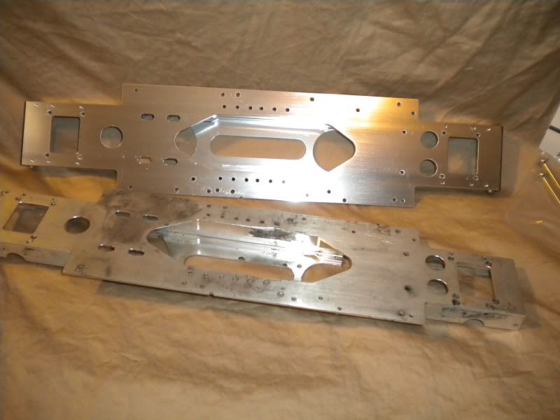

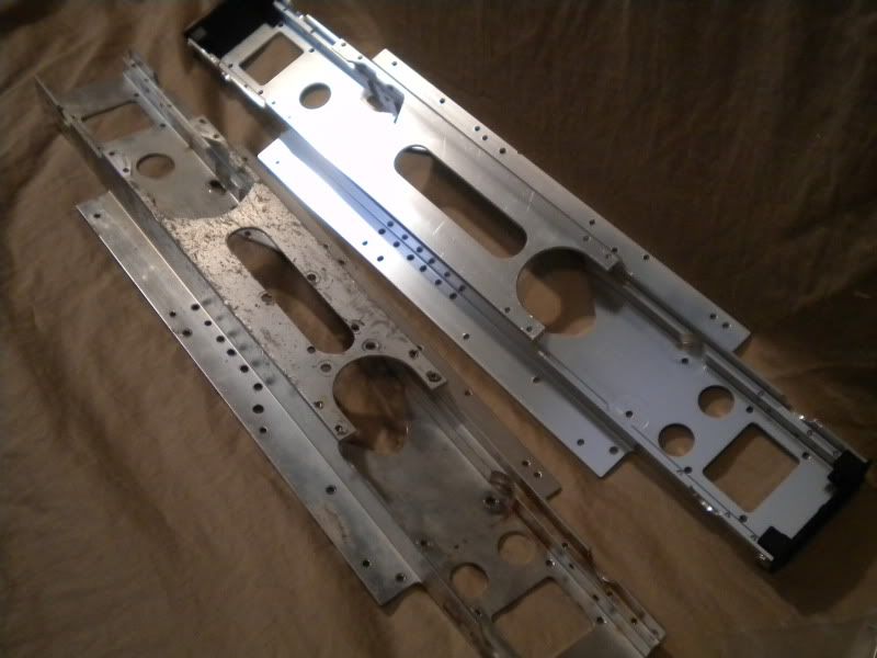

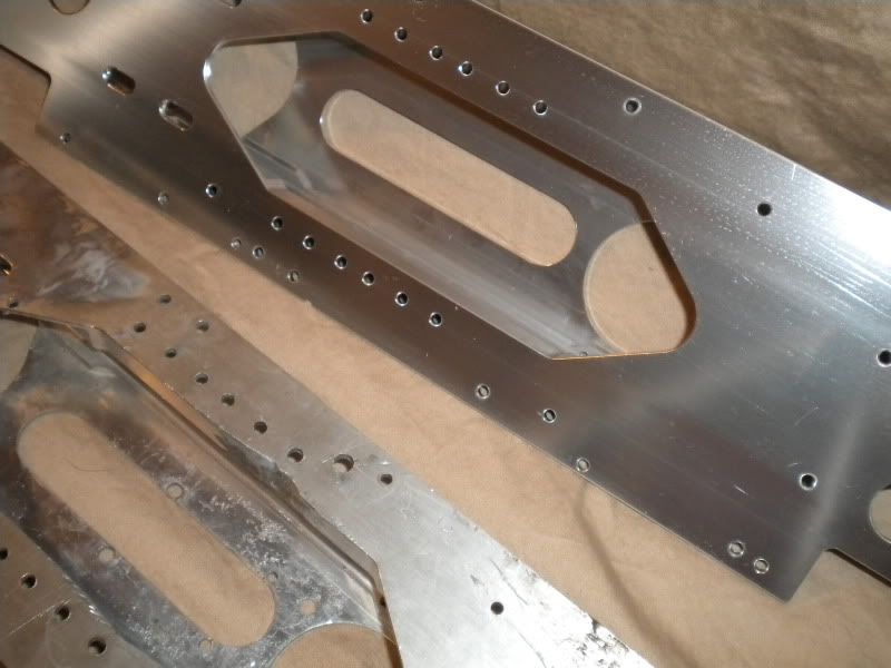

Got my new chassis and dog bones in the mail today, putting the truck back together now. Nitrohouse fails though, they don't measure dog bones pin center to pin center apparently, so I bought a 115mm dog bone assuming that it was pin center to pin center length, and it's not, so now I'm thinking it isn't going to be long enough, but I better finish assembling the truck before I jump to conclusions here....
Anyway, here are a few pictures of the new chassis next to the old one -

So this Hyper 9 1.o dog bone is too short for sure, just put the truck back together with the center diff where I want it and it's about 5mm short.... I spoke too soon about them being perfect I guess. However, I am going to blame nitrohouse for this one since they do not specify if they measure shafts from pin center to pin center or from tip to tip, and the "normal and most used" method is pin center to pin center, and they measure from tip to tip. I need a dog bone that is 113mm to 115mm pin center to pin center. And this Hyper 9 1.0 shaft is actually 107.5mm pin center to pin center. So the search continues......
