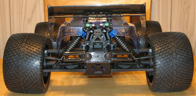

I just noticed your shock towers what are those can you post some close up picks? Is that a hellfire wing mount brakets on there?
SATAYO 06.26.2008 06:22 AM

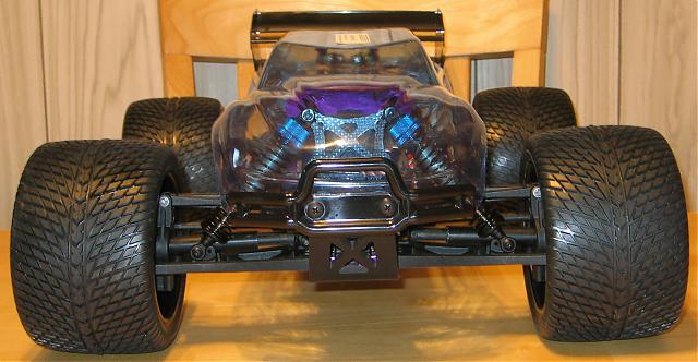

2 Attachment(s)
Droopy,
I was told the MM was not intended for 1/10 4WD applications... I agree, I don't want too much power, I want to race this... but under control and smooth.
I updated my first post, but yes, that is a Hellfire wing and wing mount. The shock towers are MT2 CF units, doubled up.
