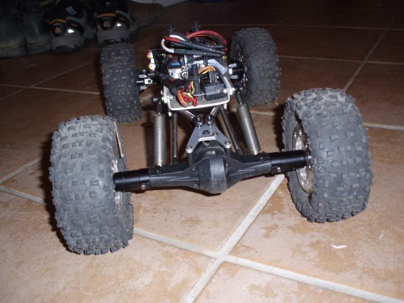

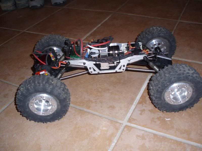

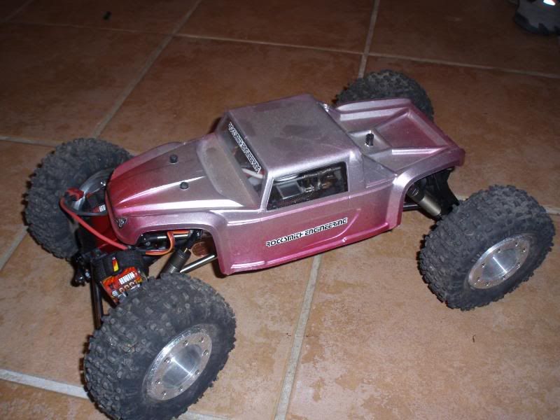

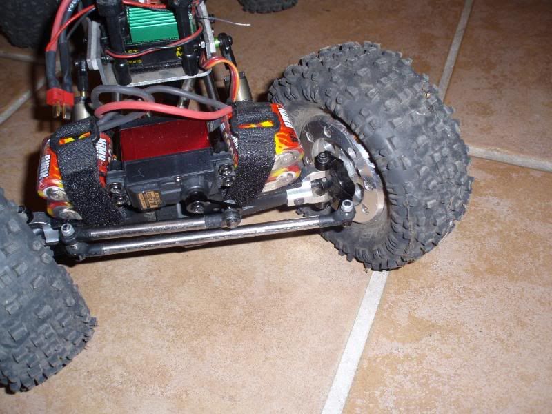

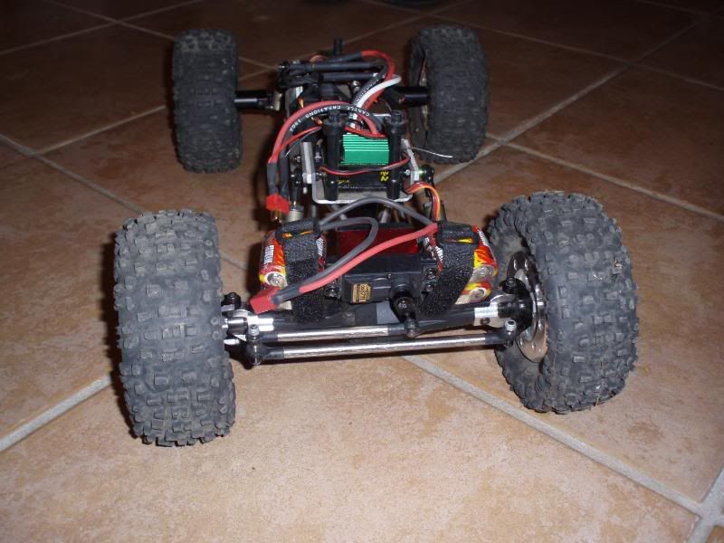

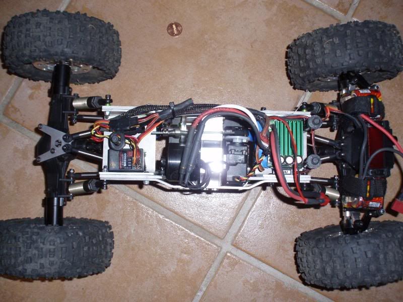

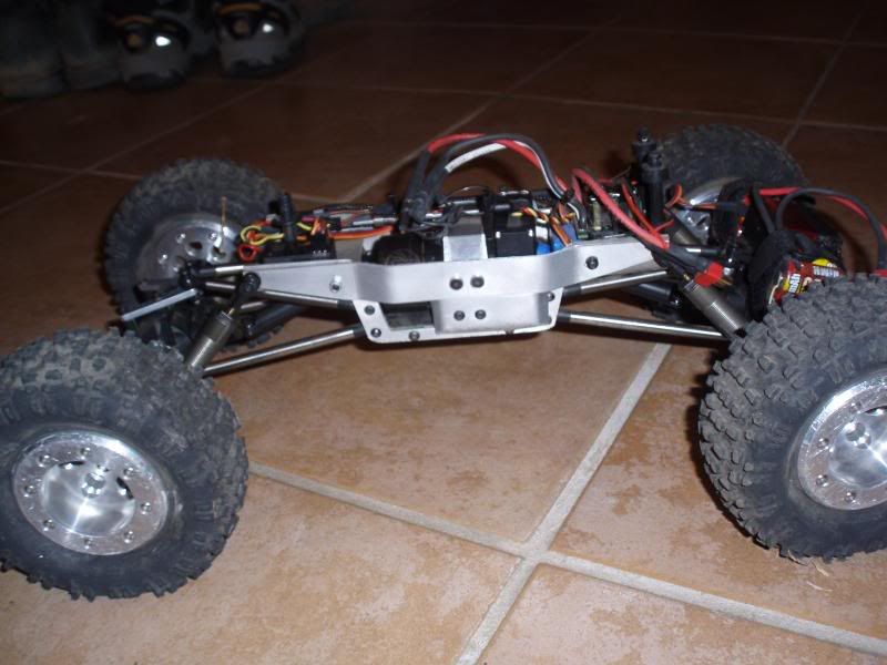

Here is the replay I received”
Hmmmmmm
Well lets see. I have a custom state of the art 2.2 crawler you might be interested in.
Axial base, although all thats left of it is the axle housings
Blackjack chassis, with custom gusset and skid plate
RC4WD R2D trans with Rocksmith teflon shift bushings for dig
Holmes hobbies Crawler sport brushless outrunner, 1000kv
RCP Alum c's
RCP alum knuckles
Rocksmith titanium lockers front and rear
Rocksmith titanium links all around, lowers, uppers and steer, with axial rod ends
RCP rear alum lockouts
RCP SS one peice axles for rear
MSD Six shooter billet beadlocks with Proline badlands and NWtractech memory foams
Stock axial wheels cut and narrowed with new Losi claws and foams
TCS Rear upper 4 link plate, alum
TCS front upper 4 link plate delrin
TCS front 3 link bracket, alum
custom radio and electronice plates
Jato drivelines
TCS dig servo mount
JR 8711 servo for steer
Hi-tech 645mg for dig
CC external bec w/programmer module
Losi crawler shocks built as droop setup with internal springs 35w fr,40w rr.50w lr
Plus tons of stock parts, shock, links, springs and more stuff than I can post. Plus the stock chassis, extra tires and on and on.
This is a national level crawler right from the get go. It is used and scratched up a bit, but I am a machinist and all the inner working are immaculent. Would even include 2 containers of my patent pending GearJelly with the deal.
My build thread can be found here.
http://www.rccrawler.com/forum/showt...inest+insanity
Let me know what ya think.........

TDC57 08.20.2008 04:23 AM
Here are some pictures I recently received..:whistle:
http://i174.photobucket.com/albums/w...f/P8190578.jpg
http://i174.photobucket.com/albums/w...f/P8190579.jpg
http://i174.photobucket.com/albums/w...f/P8190580.jpg
http://i174.photobucket.com/albums/w...f/P8190584.jpg
http://i174.photobucket.com/albums/w...f/P8190583.jpg
http://i174.photobucket.com/albums/w...f/P8190582.jpg
http://i174.photobucket.com/albums/w...f/P8190581.jpg
Now this is just the rig and not all that will come with her. Extra shocks, links, chassis, parts and peices and a new Losi crowd pleaser body that I never painted......
