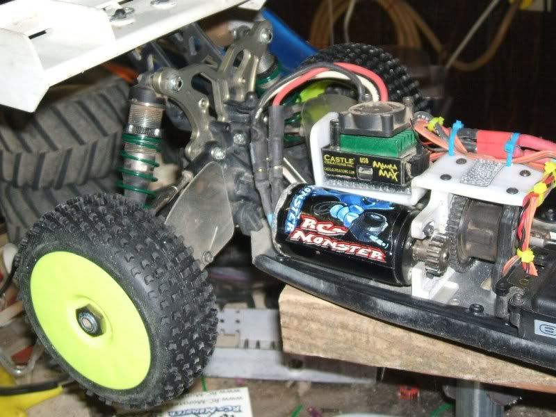

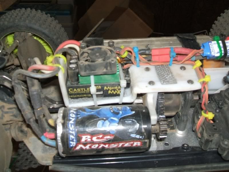

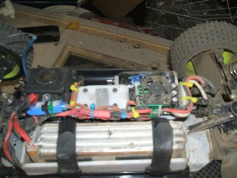

Throwing in a couple pics of the ESC mount I made out of lexan. Got the idea from how Drift_buggy had his setup. This was the second one first one still didn't give me the clearence. Also, made a battery tray out of lexan. It holding up for now. Wasn't the greatest job. Need to have more patience when heating up lexan up. If it gets too hot to fast it will bubble up. Going to make one from clear lexan next time around.
