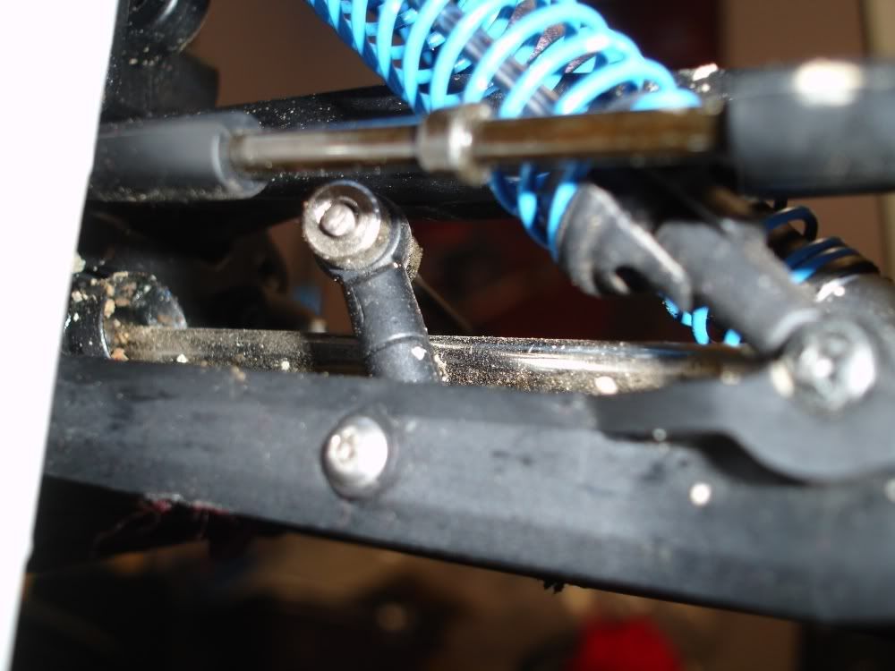

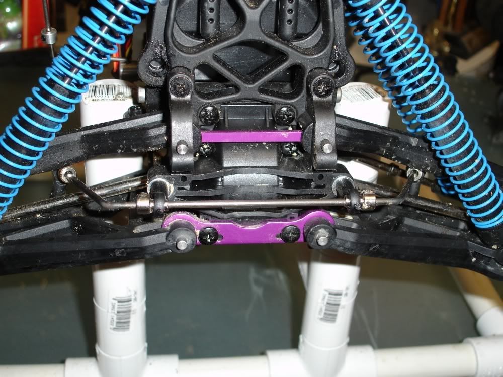

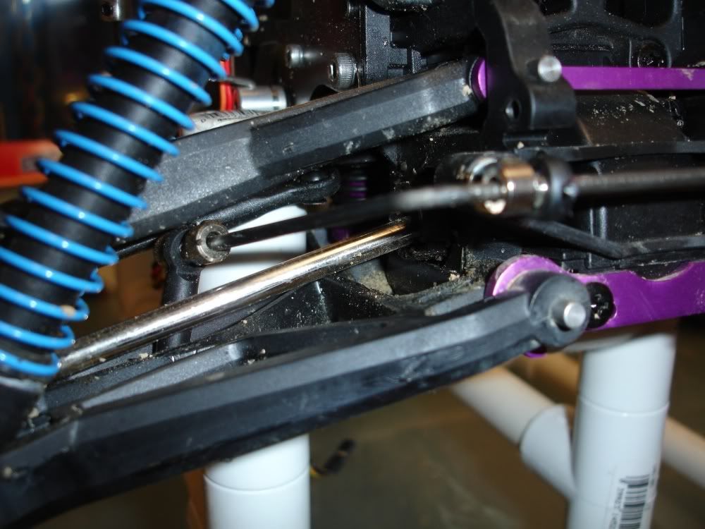

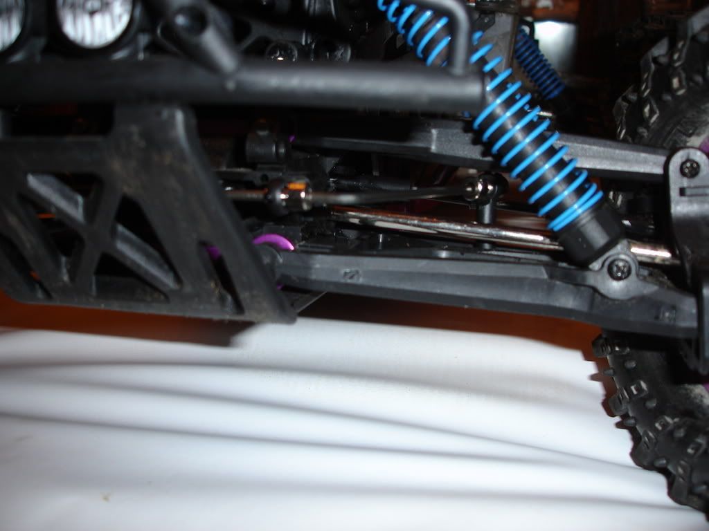

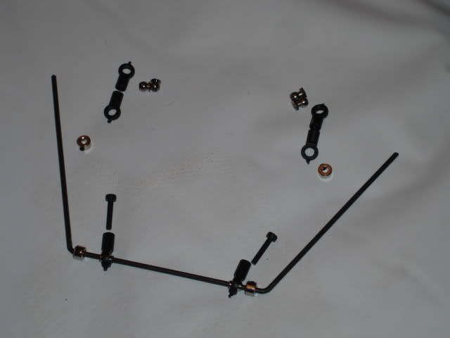

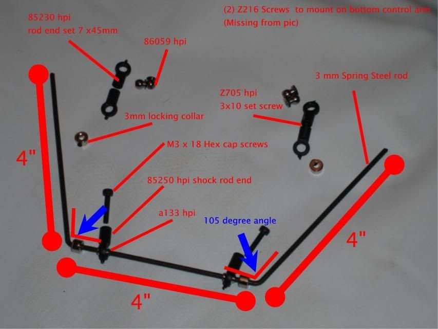

I also got this info off savage central which in turn is from another site :
For my mod, I used some leftover bits of my retired sacker 1/8 nitro buggy & a couple of pieces of bicycle sopke as I cannot seem to find decent music wire in my part of the world.
http://i198.photobucket.com/albums/a...ng39/s03-3.jpg
http://i198.photobucket.com/albums/a...ng39/s05-3.jpg
http://i198.photobucket.com/albums/a...ng39/s04-3.jpg
http://i198.photobucket.com/albums/a...ng39/s07-1.jpg
Mine
http://i198.photobucket.com/albums/a.../saxysway1.jpg
http://i198.photobucket.com/albums/a.../saxysway2.jpg
http://i198.photobucket.com/albums/a.../saxysway3.jpg
http://i198.photobucket.com/albums/a.../saxysway4.jpg
http://i198.photobucket.com/albums/a.../saxysway5.jpg
http://i198.photobucket.com/albums/a.../saxysway6.jpg
Original

t-maxxracer32 09.19.2008 02:01 AM
how well does the sway bars actually help as far as racing goes? you notice a big difference in handling?
instead of a bicycle spoke for the wire couldn't you use a revo sway bar wire or something?

MTBikerTim 09.19.2008 03:05 AM
Bicycle spokes are actually a really good idea. You can buy different thickness spokes and they are about a dollar or two each. I actually have the blue groove set but they are expensive and I think your way is actually better.
And they make a massive difference handling wise. I have the sway bars on the front of both of my trucks and before the trucks would pull up the right rear wheel if I tried to corner at speed. That normally lead to roll overs or aborted turns.

t-maxxracer32 09.19.2008 03:22 AM
how do you get it at a perfect 105 degree angle? im guessing you have to do the bending correct?
get a protractor or something?
