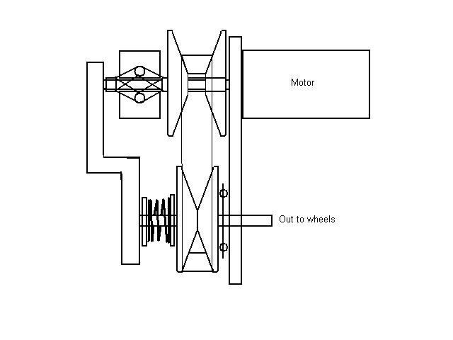

I actually drew this before I hit "Submit Reply" on my first post but I forgot to attach it. :oops:
It's a belt-type CVT. Depending on the size of the belt and what it's constructed of it should handle BL power quite easily.

Going by your pic, I assume that the belt would require a spring loaded tensioner, like a serpentine setup on a car has. Unless you vary the effective diamters of the contact surface of both sets of "cones" exactly to allow the belt to retain the ideal tension at all times.

they do not need a tensioner, you cent the motor shaft and output shaft's Center-to-center in such a way that the belt would allow the motor to "idle"
* i know this because we run a cvt style centrifigal clutch on my racecar*
centrigal force via ramps inside the primary clutch squeze the cones together, puting force onto the belt. At high rpm, then the cones are as close the belt gets tighter- this tension spreads the cones of the secondary unit, making the effective Pulley diameter of the primary larger then that of the secondary, creating overdrive.
Great concept but your would need to do extensive testing with different ramps, weights and springs to find a good mix:party:

Thats cool, I was not aware that a mechanical method was used to vary the pulley size. I figured that it would be electronically controlled via some sort of electro-hydraulic mechanism.

nope its all centrifugal
as it spins, weighted arms pres against ramps that are attached to the moving cone.

The concept was very simple- the two opposing cones changed shape as the rpms increased, causing the drive ratio to alter as the belt shifted shape/posistion between the two cones which spin the belt. Seems the cones were made of a plastic that would deform naturally due to the centrigugal forces at higher rpms. I'd be lying if I said I hadn't though about this concpet for r/c use, just wouldn't really now how to make it a reality...
