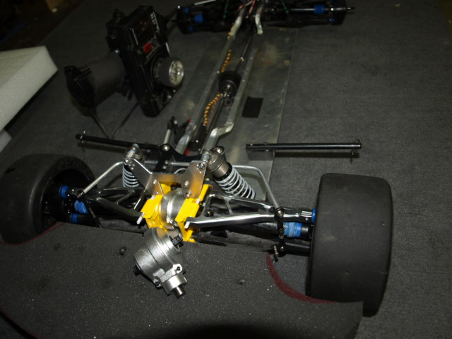

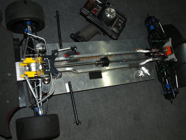

My setup (pic Below and in my sig)- in middle up drivetrain upgrade so dont look to close, the front is done though.
Custom 4wd 1/5 car (9.lbs no battery), Losi 43/13 ring pinion with a losi 2.0 CD but locked with a 45s/16p, locked rear, 5" tall 1/5 scale FG street slicks and working on a way to swap wheels out for very mild dirt 3.3 tires (4.5-5") for hard pack rally driving, but mostly street stunt, bash drifting , CC Mamba Monster /2200
want 45-55mph and 20 minute minimum runtime
