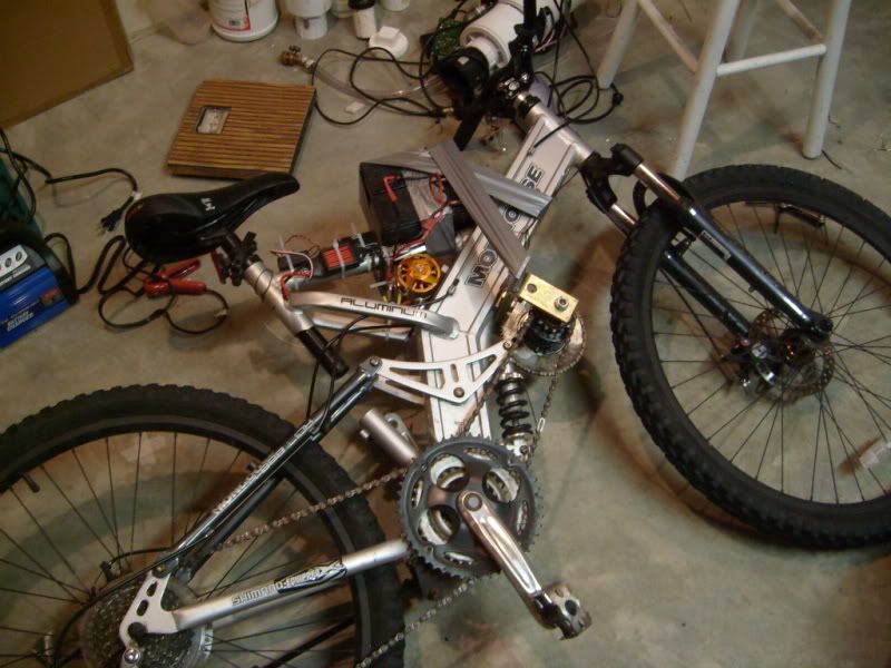

I already have all the stuff, but I've ran into a gearing problem. I think I need another 5:1 reduction on top of my 2-3 reductions...... I think I'm going to find some scooter or something where the wheels are smaller.
http://i345.photobucket.com/albums/p...1/S7301761.jpg
brushlessboy16 06.01.2009 12:05 PM
I think all that chain is putting alot more drag and stress on the motor then it shoul.. just find a lower Kv motor possibly?
What motor is that btw?
Metallover 06.01.2009 12:14 PM
There's a lot wrong with it... It's a failed experiement. I'm going to try to find a dead electric scooter or something like that now.

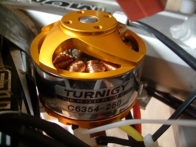

http://i345.photobucket.com/albums/p...1/S7301763.jpg
brushlessboy16 06.01.2009 12:27 PM
