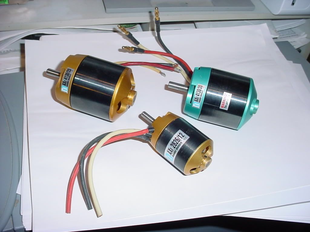

Heres a pic of the motors that Sike is trading me. I will use the 2 4130/20 motors for the blades, and I have a matching 2826/12 already to pair with the one in the pic for the drive system

sikeston34m 06.13.2009 11:59 PM
Nice Picture! :yes: LOL
