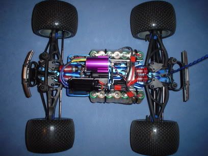

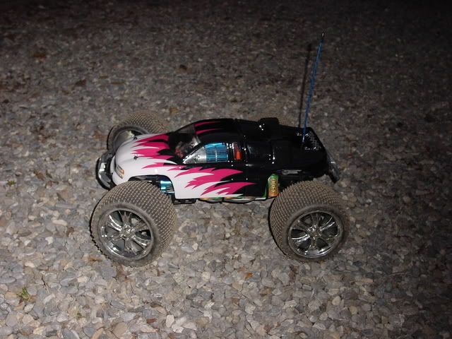

Okay guys, here's a little picture up-date for you. Enjoy!
http://img.photobucket.com/albums/v3...e/DSC00046.jpg
http://img.photobucket.com/albums/v3...e/DSC00045.jpg
http://img.photobucket.com/albums/v3...e/DSC00044.jpg

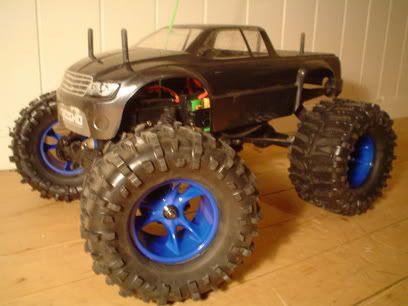

Here it is with a stock EMaxx body:
http://img.photobucket.com/albums/v3...e/DSC00067.jpg

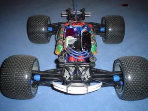

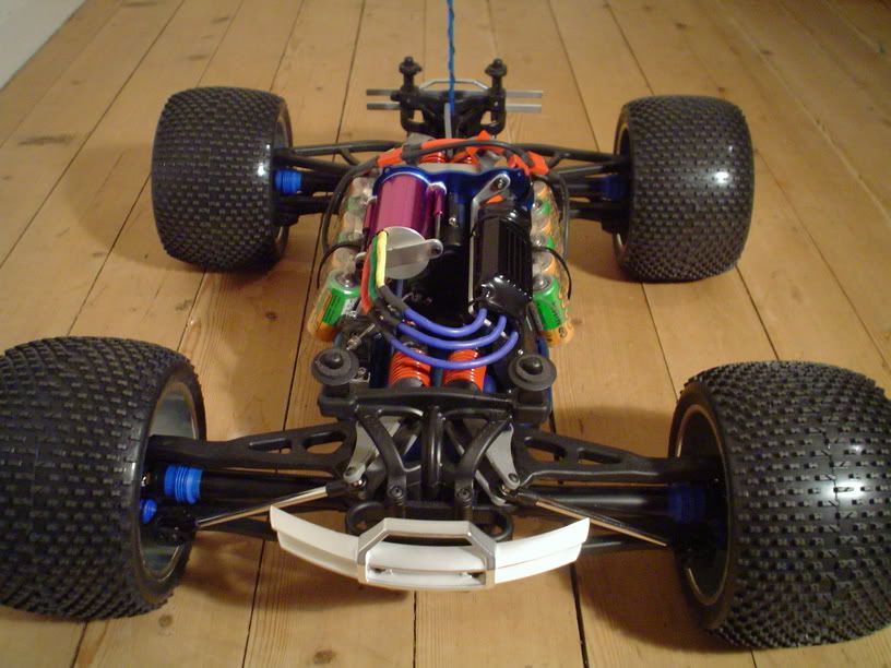

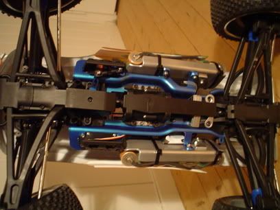

From below:
http://img.photobucket.com/albums/v3...e/DSC00068.jpg
http://img.photobucket.com/albums/v3...e/DSC00070.jpg

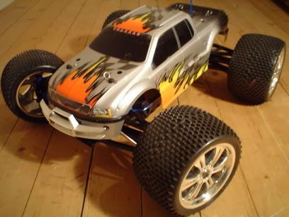

New body:
http://img.photobucket.com/albums/v3...e/DSC01283.jpg

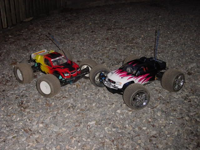

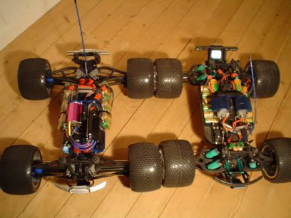

Next to my EMaxx:
http://img.photobucket.com/albums/v3...e/DSC01282.jpg

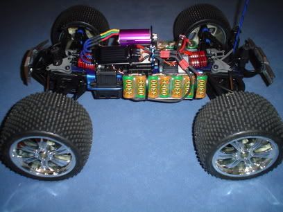

And here you can see my 14 cell squad:
http://img.photobucket.com/albums/v3...e/DSC00061.jpg

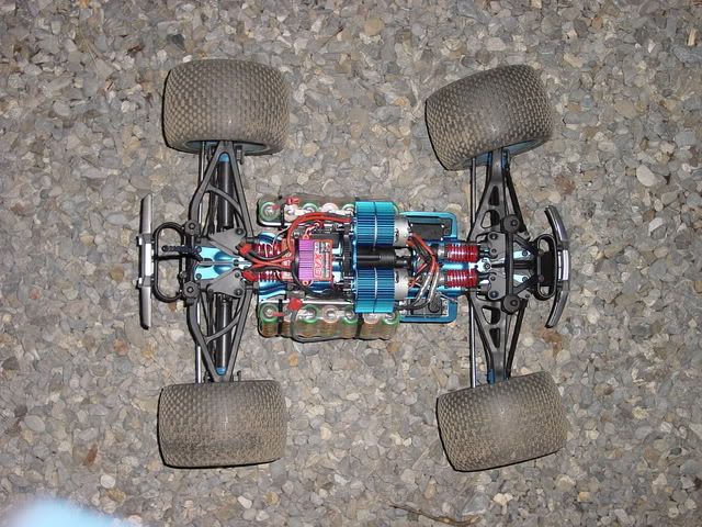

Just for the fun of it, here's my BL Force
http://img.photobucket.com/albums/v3...e/DSC00058.jpg

Supermaxx: The tranny is almost a direct fit, just had to file off a few mm's.
Please post your comments and stuff.

Wow that looks great...good job! I love the paint job you did too.:D

Hey Dafni - awesome build up - Here is one thing that I have encountered in my Maxx. Where the motor wires connect to the speed controller you are going to want to support the wires. Im my maxx from jumping/flipping the wires on the motor started to ever so slightly move up and down and over time they moved up and down and the coating on the wires wore away and the motor was shotski... Just a little info for all about supporting the wires from moving.....
Dafni 03.23.2005 02:14 PM
Thanks guys:)
HnC, you mean on the BL setup? Where the wires enter the 9918?
I have also thought about this. What about filing the gaps between the wire up with shoe-goo?? This will prevent dirt from getting in as well. (But also hinder air-flow over the heatsink)
What would be another suggestion?
Thanks for the info, mate.

Re: supporting the motor wires. Dafni - Its hard to say where exactly this happened with my motor - however when you start jumping, and tumbling your revo - the motor wires will start moving up and down with the truck - this will over time break the covering on the windings and short them out - hence replace the motor - So if you would find some way to support the wires it would be beneficial to ya. As far as our race maxxes - Mine is a little over 9lbs - all aluminum, fully loaded with batteries and body - Some of Mikes are lighter :mad: than that - LOL

Now I see what you meant! The isolated windings on the motor. I thought you were talking about the wires on the controller.
Yes, I have also thought about how sensitive this strange isolation on those winding-leads looks.
I shortened the wires from the controller to the motor as much as possible, to reduce their mass.
But I might still consider something else, too. Just need to support those wires somehow.
