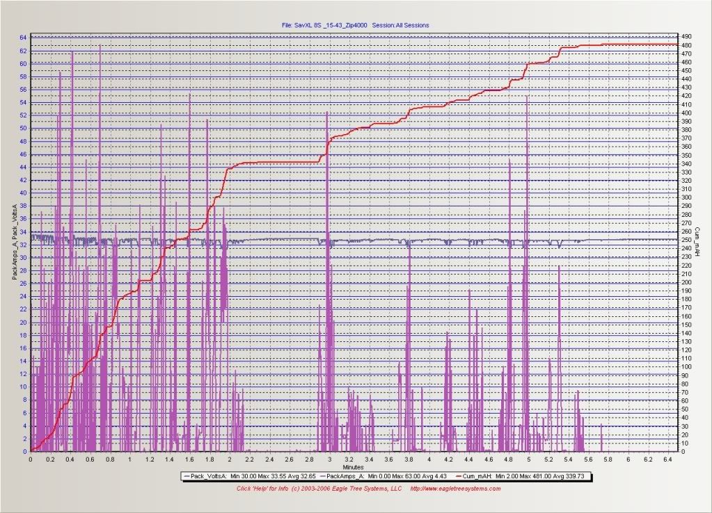

So I've been running it a bit, and decided that I was a bit overgeared. Nothing got too hot, but it seemed a bit too sluggish on the bottom, and a bit fast on the top. No wheelies either. Did some wierd thing as it got hot too. Don't want to blow this controller up, so I better off backing down. I went down to a 15T from 18T, but I'd prefer a 16T if i had one.
Power dropped a bit, but it was more snappy low end and controllable on top and plenty fast. Wheelies too. Temps came down a bit.
The esc still said 150A peak, but volts were right on. Temp was way off tho.
http://i7.photobucket.com/albums/y25...ppy-H8S4Ah.jpg
