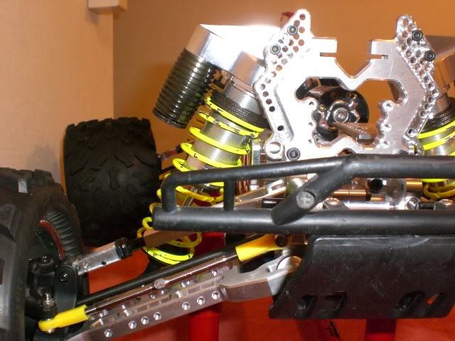

Instead of using the FLM LST shock mounts, you can just use the standard Losi shock mounts - i know for a fact they work fine on both my savage flux and savage 21.
I have the FLM mounts on the FLM chassis, but, with all those mounting holes, i can only manage to mount them in one position (can you believe that?!?!) without the shock rubbing on the chassis (i have the chassis spacers installed)
I drilled out the stock pistons slightly larger and used 35wt oil, and they're great =)
Whatever you do, DO NOT get the integy piggy backs... they are great except for the shafts and lower mounts - if only they used the same shaft size as losi did, then they would be awesome with the TiNi shafts and standard losi lower mounts (lower mounts = where the shock attaches to the lower arm, i forget the name)

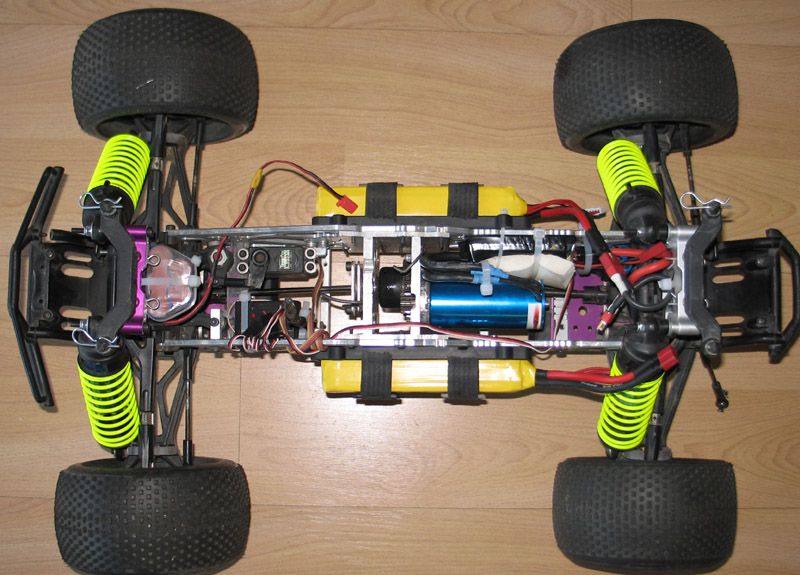

Finnster 08.20.2009 10:48 PM
There are the FLM LST mounts for the FLM Savage towers. You need both. I have this.
There is another kit for use w/ plastic oem towers
I haven't seen where you can use just stock parts to convert. Don't see where that would be very strong, but who knows. The losi shock parts kit tends to come w. all sorts of bits, pistons, shock ends, clips, etc.

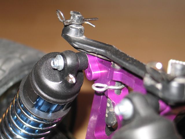

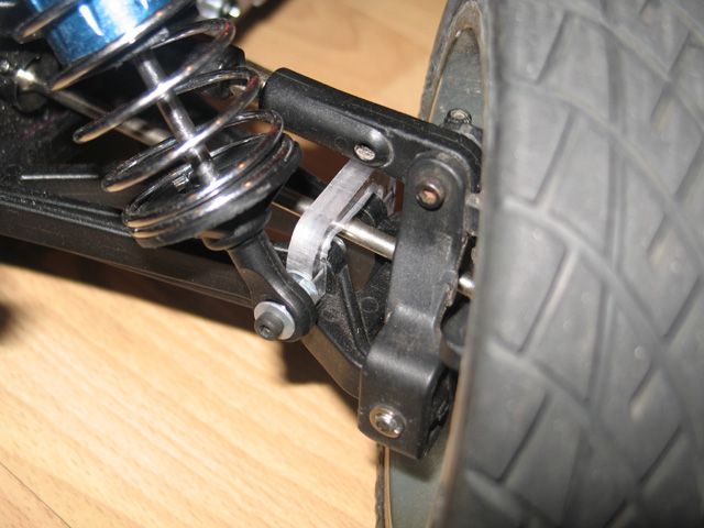

Here's how I did it cheap:
http://img.photobucket.com/albums/v1...e/IMG_7095.jpg
http://img.photobucket.com/albums/v1...e/IMG_7102.jpg
At the top, it's one of the standard LST upper shock bushings with a long 3mm screw through the bushing and the tower. I found the 3mm screws bent easily so I upped it to 4mm, by drilling out the shock tower and bushing.
The lower is a simple bracket from 1/4" polycarbonate (Lexan) that spaces out the shock and distributes some of the load to the other side of the arm. Those are Savage 25 arms, BTW.
danhfvcsd 08.21.2009 12:49 AM
JThiessen - The shock towers i have on my savage are different to those... I'm not sure if Mike has the wrong picture there, or if FLM have changed the design on them...
http://i211.photobucket.com/albums/b...gybacks/05.jpg
On the flux and S21, I have my LST shocks mounted the same as Metal Man at the upper position, although the bottom is different - i used 2x FLM chassis spacers and a really long screw... i have the shock on the outside, followed by a spacer, followed by the susp. arm, then another spacer, and then the other side of the susp. arm (dunno if that makes sense - will need pics probably)
I bent the standard shafts on a couple extra large jumps and replaced them with the tini shafts, so it holds up well =)

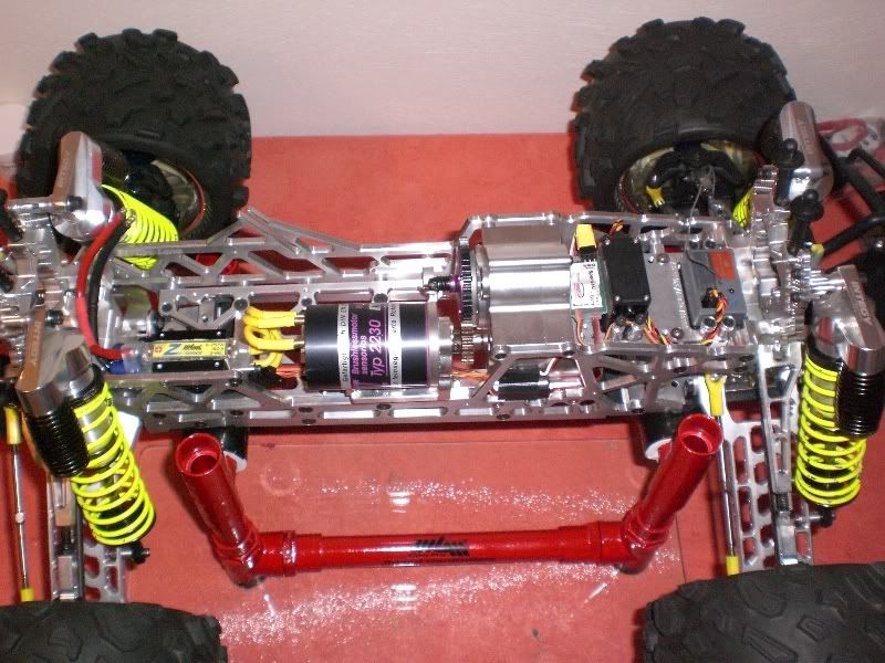

danhfvcsd 08.22.2009 12:30 AM
mine are in front too...
http://i211.photobucket.com/albums/b...ompleted01.jpg
I have them in front of the rear arms on the flux also, but on any version, if you had the one piece rear hubs you could easily mount the shocks to the rear of the rear arms - I only have my rear shocks mounted in front of the rear arm due to the turnbuckle :)

Finnster 08.22.2009 09:05 AM
Hadn't seen that new era kit, but seems a bit pricey, but you have to use older style arms? Seems for not that much more you can just get the FLM kit and have a solid tower as well, unless you really want to keep the plastic one.
Yeah, the shocks have to go on front due to toe link. I'd prefer to mount other way as the plastic for the shock mount on the arm is a bit thinner in the F for some reason, but it works either way. I intend on making mine 4WS, else I would get a solid C-hub from integy or HPI. The stock turnbuckles (esp the ballends) suck.

danhfvcsd 08.22.2009 09:49 AM
It's about 7.5kg rtr with 18 nimh cells, but haven't weighed it with the 4s packs I've been running in it lately... It's the 16025 MGM and 2230/11t, but the lehner has been put aside for a 1512 on 4s, as I can't afford the 6s packs I want right now, and am kinda saving for a truggy and bunch of other stuff hehehe :) Sorry to stray :)
