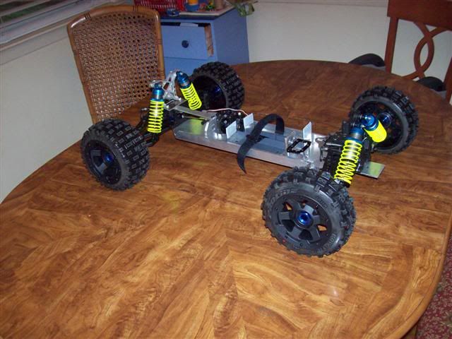

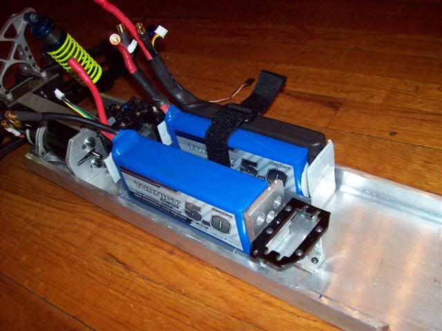

brian015 06.10.2010 07:14 PM

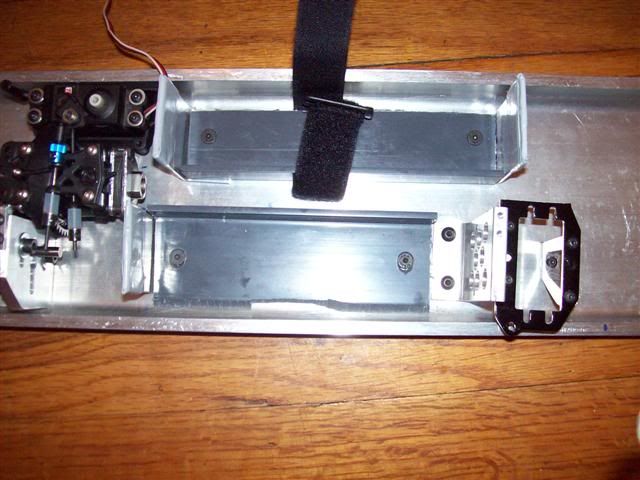

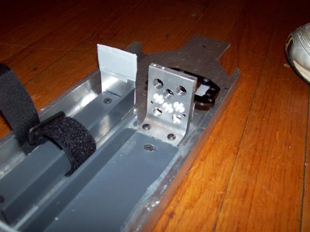

Update: battery trays with Aluminum stops (front and back) installed. I used a 1/4" thick piece of Al at the front of the right hand tray to mount a brace to the front bulkhead and also to attach the steering servo tray.
Now, I think I'm ready to cut about 2" off the front to give me a 20" wheelbase. Just wanted to see exactly how everything would fit before cutting (I haven't found a good way to glue aluminum back on yet - so don't want to cut too short).

And yes, I need a velcro strap on the right hand tray. :wink:
brian015 06.11.2010 07:07 AM
This is the pvc I'm using for battery trays. I've used in a couple other vehicles and it's worked well. For this one, I cut off one of the legs of the u-channel, since the Aluminum rail of the chassis is there - I may add padding if I think it's necessary.
pvc u-channel

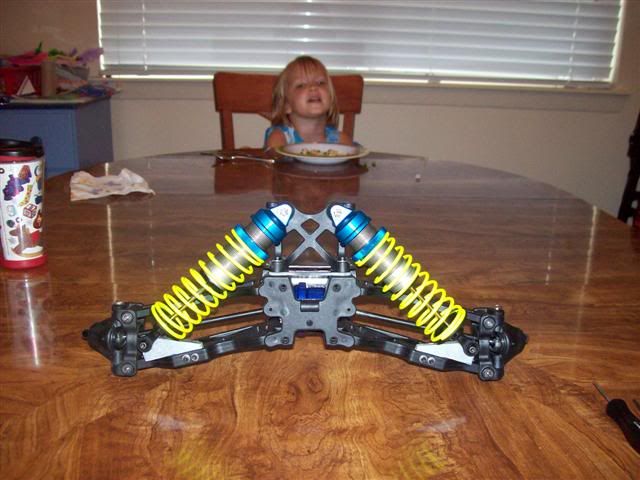

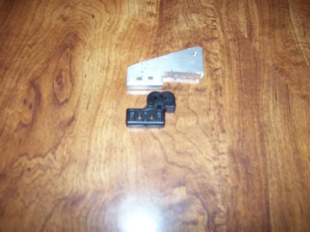

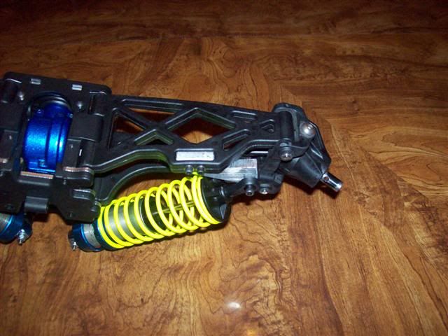

Front end:

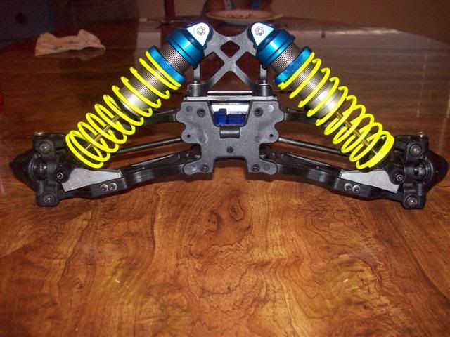

I wanted a lower profile to the front end than the LST2 shock tower, so I went with the stock muggy shock tower (I made an aluminum shock tower by hand, but didn't like it). In order to get enough suspension travel for the large baja 5b tires, I need the LST2 length shocks. So I made some shock mounts modeled after the muggy lower shock mounts but giving a more shallow shock angle and a more distant mounting point.
Shock mount compared to stock muggy lower mount:
http://i779.photobucket.com/albums/y..._4387Small.jpg
Front end assembled:
http://i779.photobucket.com/albums/y..._4390Small.jpg
With little girl onlooker (who has to eat her veggies):
http://i779.photobucket.com/albums/y..._4388Small.jpg
mistercrash 06.14.2010 07:34 PM
I really like those lower shock mounts. I will wait for you to run with them to see if they hold up. That shock mounting position gives a lot of leverage to strip those two screws that secure the mount to the suspension table. But I'm often wrong on stuff so don't worry about it :mdr: If they do hold up, this is something I will probably make for myself as I would like to try the Muggy shock towers but don't wish to run the Muggy shocks. Very nicely done.
brian015 06.14.2010 08:09 PM
Thanks - I look forward to running this and see if it holds up too :wink:
Looking at the pictures I would tend to agree with you that this is a potential problem, but holding it - it feels solid. The aluminum mount rests on top of the arm as well as being held by the two screws. These pics from the bottom may show that there is less leverage than the side pics would suggest:
http://i779.photobucket.com/albums/y..._4392Small.jpg
http://i779.photobucket.com/albums/y..._4393Small.jpg
But - I guess we'll have to wait and see how it holds up in action. :yes:
Overdriven 06.14.2010 08:33 PM
He'll probably be ok as the screws are under a shear load. I wouldn't doubt it if they bend a little when landing the big jumps, but I can't see them breaking. Then again, I could be wrong about this stuff too! :lol: I am curious to see if the shock mounting point will work or if he'll end up drilling more holes for different positions though. Either way, cool build man, keep us updated. All these LST's are making me want one

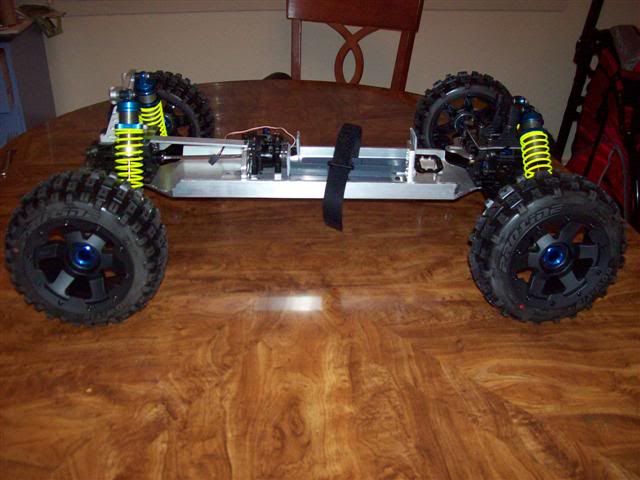

brian015 06.16.2010 07:16 PM

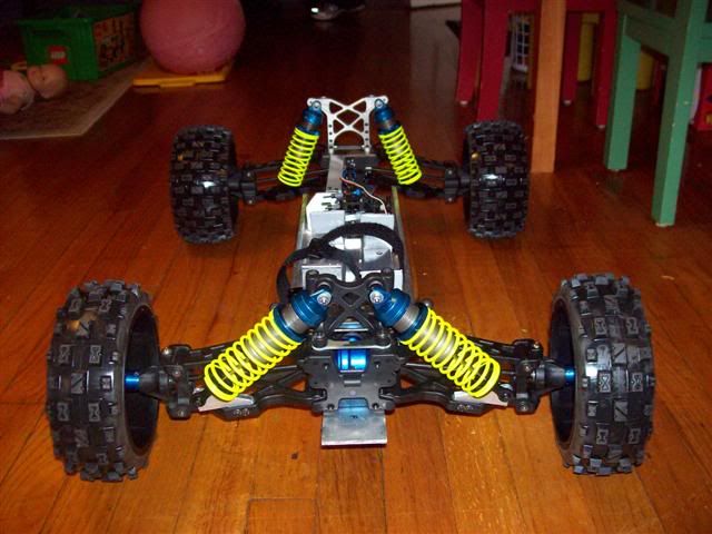

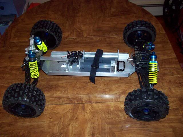

Alright - I cut 2" off the front of the chassis (still need to cut last bit off) and attached front end and wheels/tires to see how it looks. The wheelbase is 20"; rear width is 19.5"; front width is 19"
http://i779.photobucket.com/albums/y..._4395Small.jpg
http://i779.photobucket.com/albums/y..._4396Small.jpg
http://i779.photobucket.com/albums/y..._4398Small.jpg
http://i779.photobucket.com/albums/y..._4402Small.jpg
http://i779.photobucket.com/albums/y..._4403Small.jpg
So I still need to install the steering assembly and front brace, make the front extended cvd, install esc/bec, and install roll cage and wing. But I'm beginning to think I'm going to be driving this thing this summer. :yipi:
killajb 06.16.2010 11:29 PM
That is looking NICE!! The stance and front shock angle gives the appearance of an overgrown turbo optima mid or something. Those front and rear diffs sure do look small next to all that meat for the wheels tho. Have you shimmed the diffs? If so, hell shake it if you got it. Big legged mammas are back in style again!
