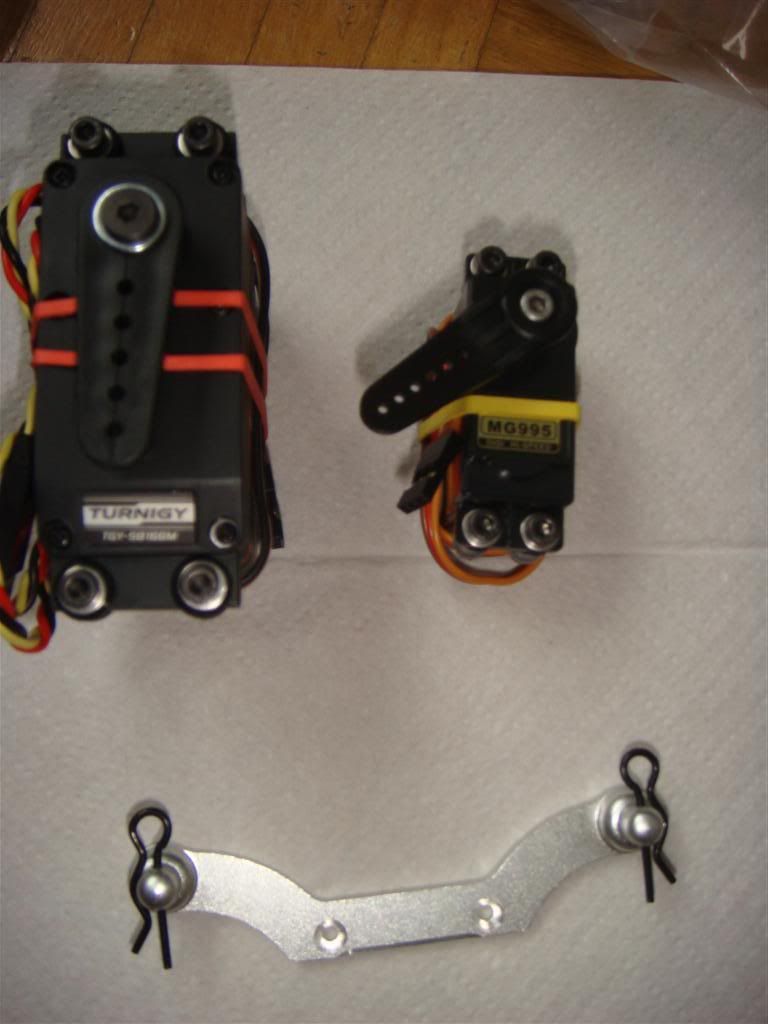

Left : Turnigy S8166M 6V 33kg / .21sec / 155g
Right : MG995 6V 15kg / .13sec
http://i643.photobucket.com/albums/u...g?t=1291418183

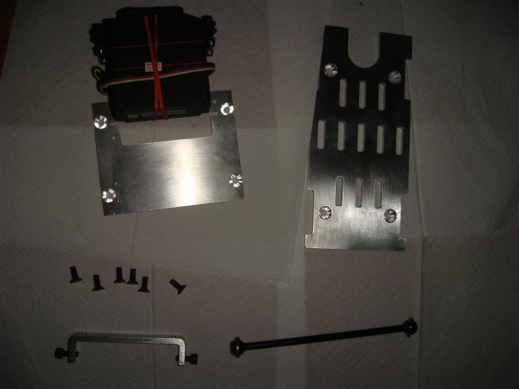

Received new lipo plate and servo plate with bigger hole.
My XL dogbone was repaired as pin from the ball was lost.
http://i643.photobucket.com/albums/u...g?t=1291923280

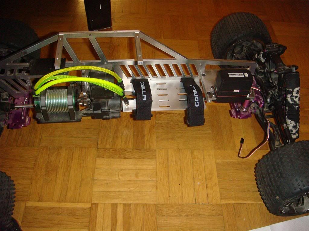

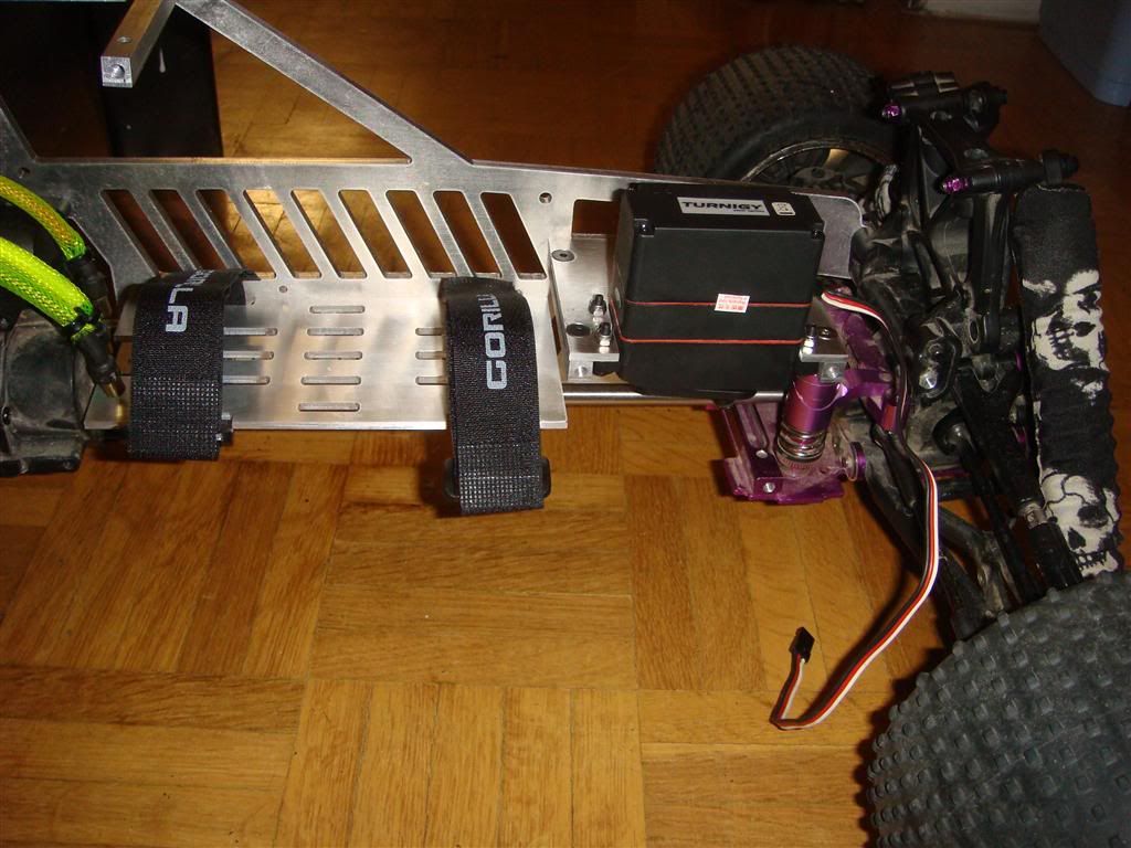

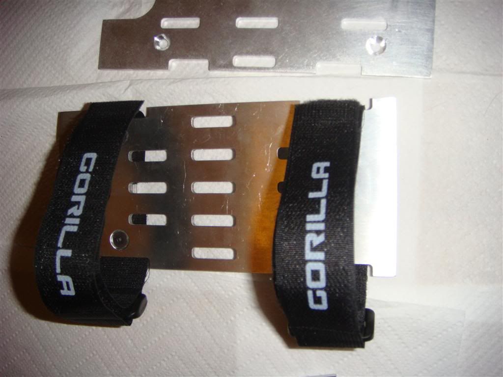

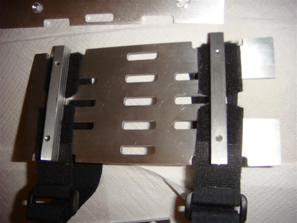

This is how i mounted Gorilla straps now, perfect fit!
http://i643.photobucket.com/albums/u...g?t=1291923281

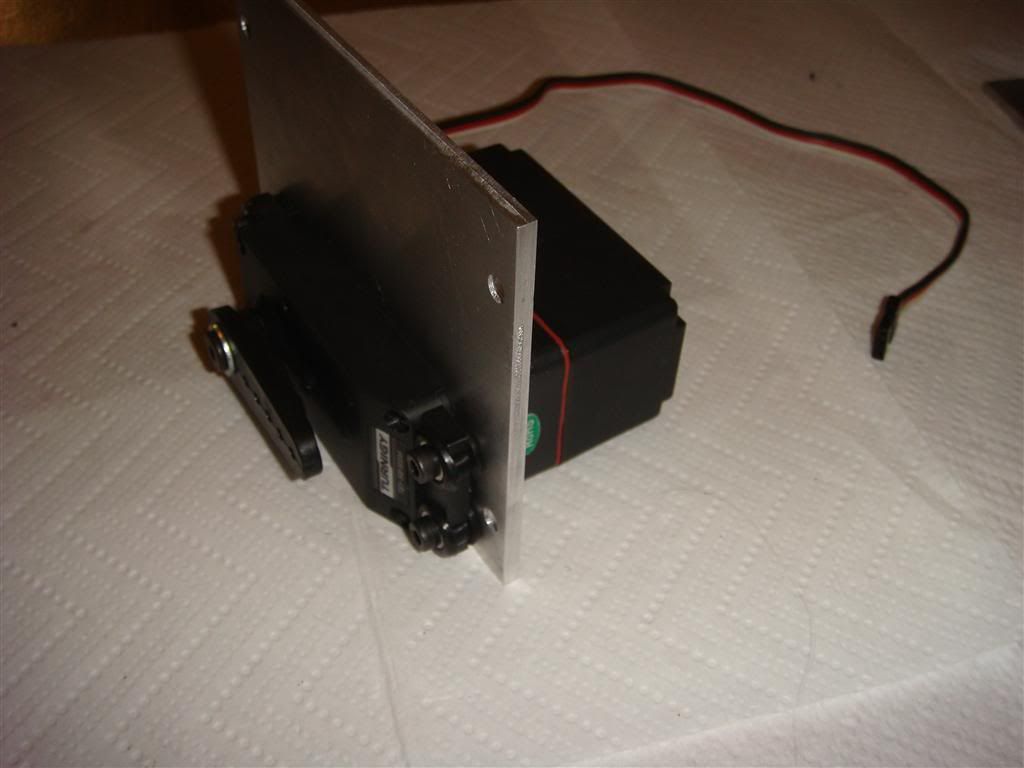

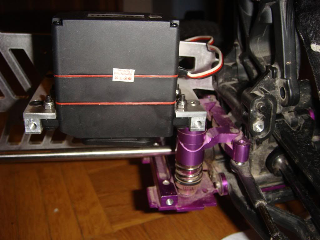

Servo and plate:
http://i643.photobucket.com/albums/u...g?t=1291932084
Installed
http://i643.photobucket.com/albums/u...g?t=1291932085
