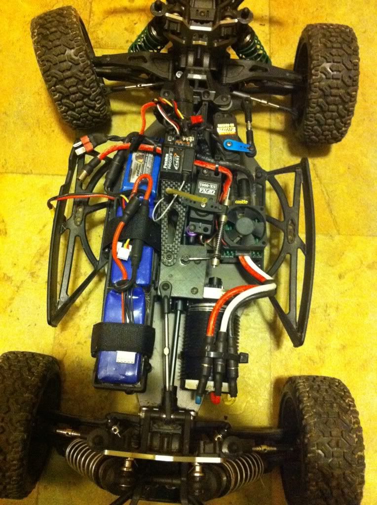

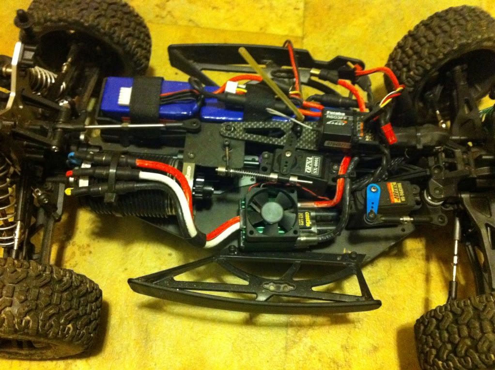

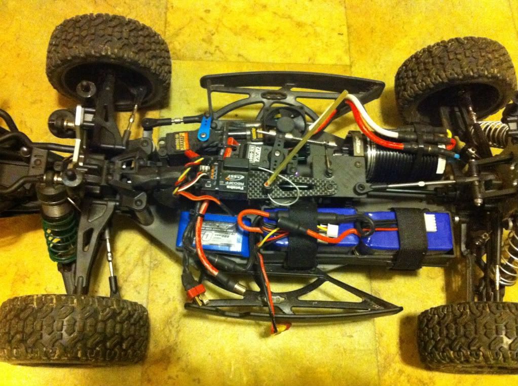

DrKnow65 02.28.2011 12:26 AM
http://i217.photobucket.com/albums/c...5/97cc3bcc.jpg
http://i217.photobucket.com/albums/c...5/b01de530.jpg
http://i217.photobucket.com/albums/c...5/029ab603.jpg
DrKnow65 02.28.2011 12:51 AM
List of mods:
Removed the lower portion of the front bumper and added a "skid plate" that goes from the top of the bumper down the front past the front diff screws (modded plastic oil container).
Moved the battery back another 1-1/8" from the rear most position
Swapped the front and rear center shafts, moving the CD back 3"
Swapped the steel spur gear for Delrin.
Fabbed a CF CD top plate and added mechanical brakes.
Added chassis braces That meet at the CD top plate.
Stood up the steering servo to correct the geometry.
Put in the Jammin steering components with losi ball studs (now broken, replacing with aluminum parts)
Tightened up the front hub carriers where the pillow balls had slop.
Shimmed the front wheel bearings to eliminate slop.
Installed Losi 15mm big bore shocks (huge difference).
Added a 800mah 2S lipo for servo's and reviever (no BEC in the Phoenix ICE HV).
Installed a Phoenix ICE HV 80 ESC (could have used a 40amp with the low current!!! :surprised:)
Using 2 x 1300mah 40/80C 4S Sky lipo's. (15 minute run time on 1000mah :party:)
Neu 1515/2Y (1100kv) motor with the first fin removed to run a 13T pinion (could go as low as 9T I think).
Have on order;
HS-7954S servo for steering http://www.hitecrcd.com/products/dig...l/not-set.html
Aluminum bellcranks http://www.nitrohouse.com/Default/c2...duct_info.html
PiStix adapter so I don't have to max out the trim and sub trim to make the Phoenix happy http://www.offshoreelectrics.com/pro...pistix&cat=136
17mm Ofna hub adapters http://www.ofna.com/images/parts-images/20000/21318.jpg
1/8th rims and tires (much lighter)
I think that's it for now. This thing is a WHOLE DIFFERENT ANIMAL!
DrKnow65 02.28.2011 01:16 AM
Ah, forgot that I also used 2.5mm spacers between the pillow balls and A-arms to bring the CVD out of the diff cup a bit and keep them from binding at full droop.
And have rear CVD's on the way as well.
