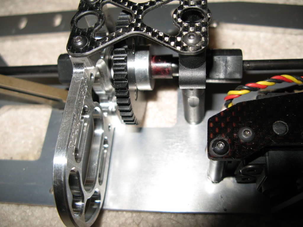

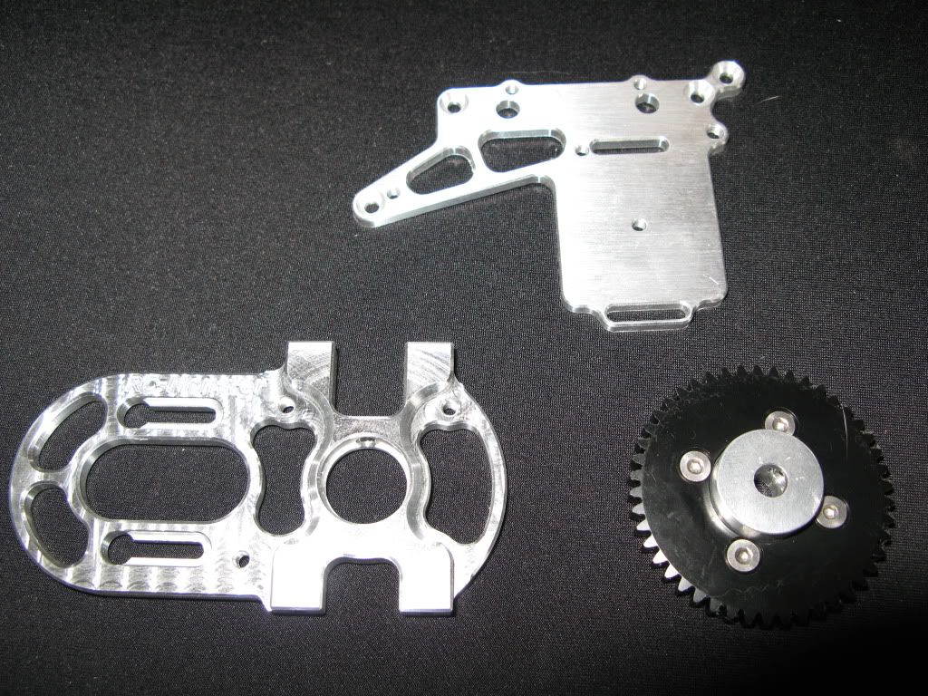

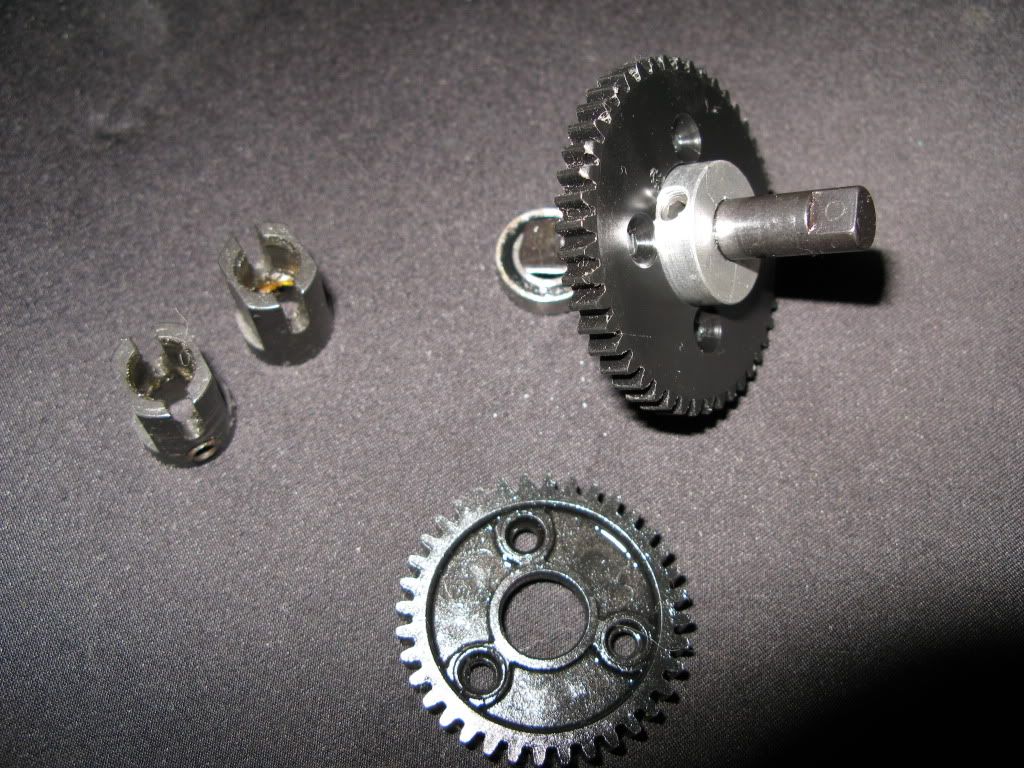

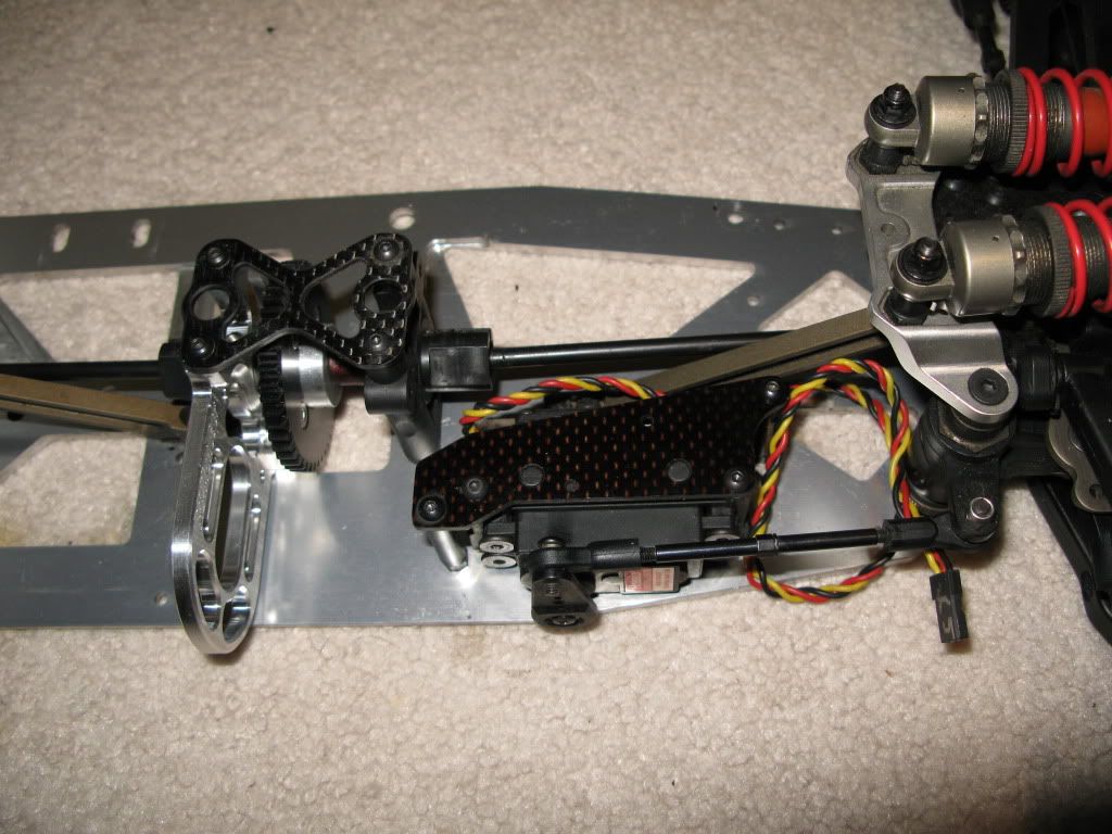

Got my package from Mike today and spend little time messing with it
http://i232.photobucket.com/albums/e...1/IMG_1621.jpg
Ill try single speed Because when i had my on road .21 in it there where no tracktion at all with 2sp
I used original 2 speed shaft and Mikes single speed adapter, had to drill out center to 5/16 to asept 2 sp shaft
http://i232.photobucket.com/albums/e...1/IMG_1623.jpg
http://i232.photobucket.com/albums/e...1/IMG_1624.jpg
http://i232.photobucket.com/albums/e...1/IMG_1625.jpg
http://i232.photobucket.com/albums/e...1/IMG_1626.jpg

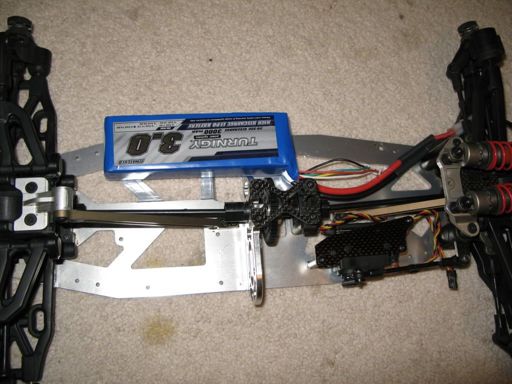

Arct1k 07.15.2011 12:42 PM
Reverse the centre diff and run the motor opposite the servo...
Looks perfect for saddle packs...

in general is it better to have one battery 6s or two 3s
TexasSP 07.16.2011 09:16 AM
Power wise, it doesn't matter. Balance and setup wise, two would be better.
Two of these would do nicely and are a good price. At 55c it gives you a 143 amp continuous rate and being lower capacity it will keep size and weight down.
Arct1k 07.16.2011 10:15 AM
I'd to 2 x 3S - Personally I prefer series to parallel.
You can charge as a 6s pack and still balance each cell
Batteries tend to be cheaper
Less cells

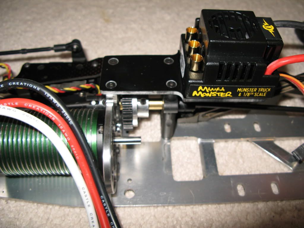

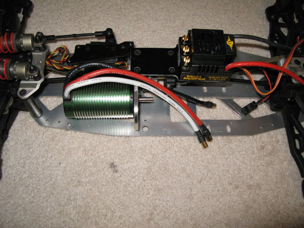

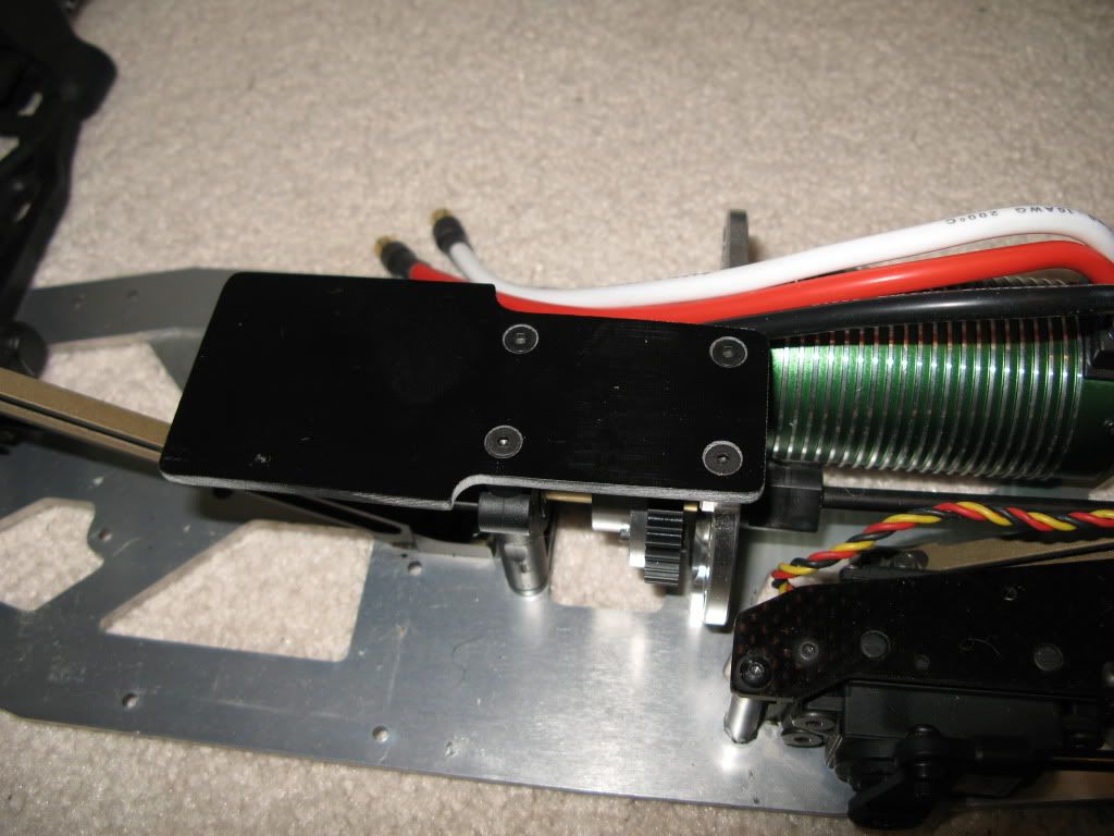

rc hobby 07.24.2011 02:53 AM
little update;
recieved my mamba combo and made top plate for mounting esc
next batterys and battery trays proboble its going to happen beganing next months spend all my budget for rc this month
http://i232.photobucket.com/albums/e...1/IMG_1637.jpg
http://i232.photobucket.com/albums/e...1/IMG_1639.jpg
http://i232.photobucket.com/albums/e...1/IMG_1640.jpg
