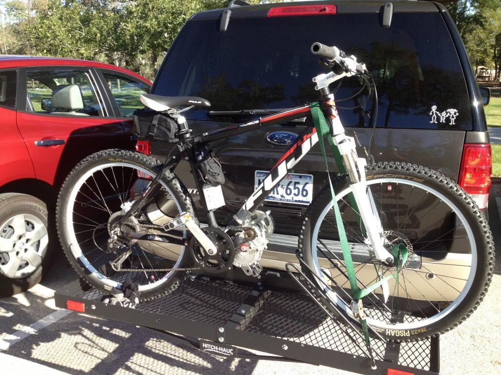

It's a motherflower torque monster. Hill climbing is not a challenge anymore. Goes 33mph max with 15s lipo. Trail riding is a blast. Easy to pedal, power when you want, and very easy to handle.

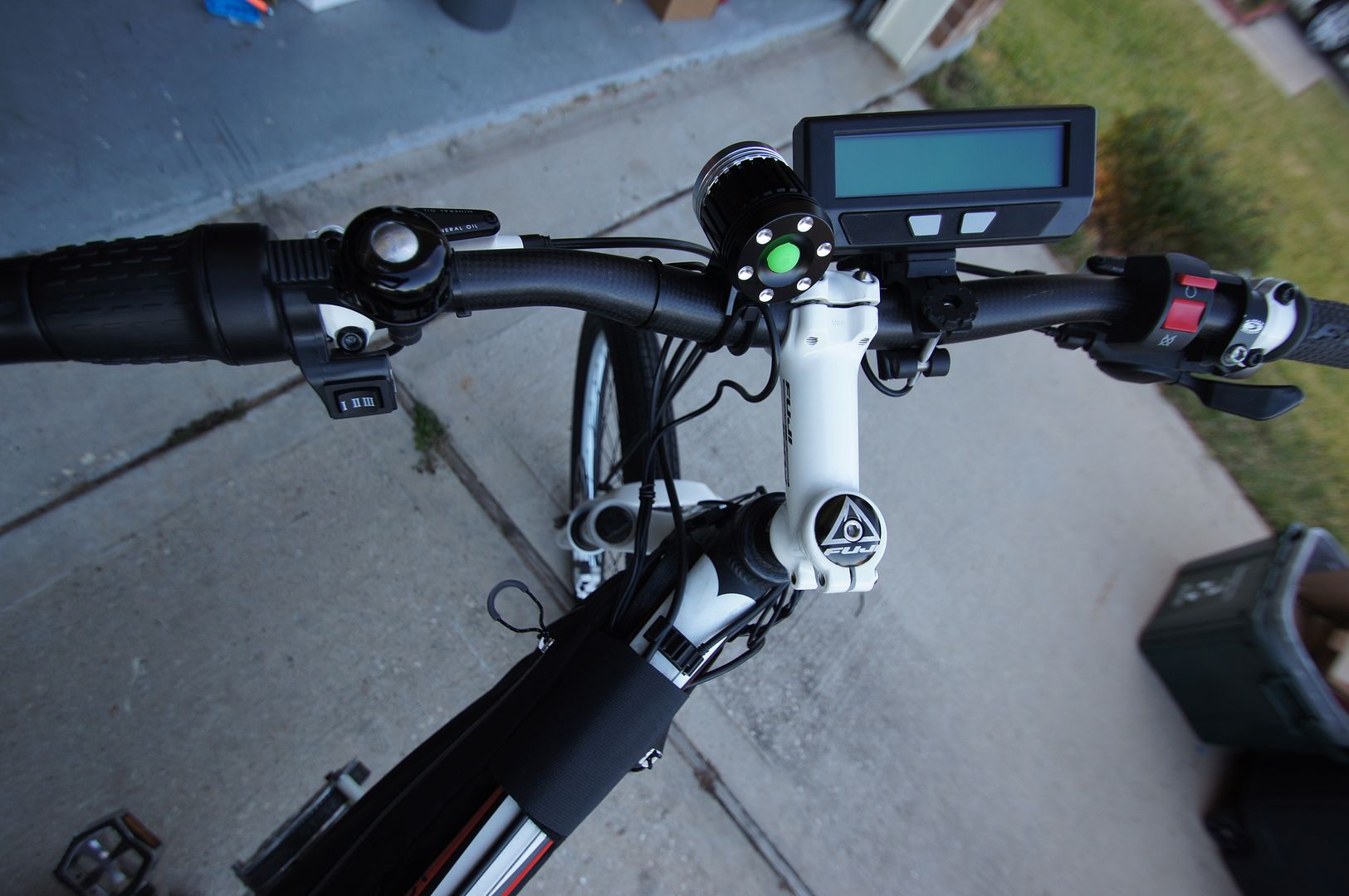

I added a 3 speed switch, Cycle analyst and chain guides. I love the 3 speed switch with this bottom bracket motor setup. You really don't need sensors with the setup either. Zero cogging with the 6 fet sensorless controller

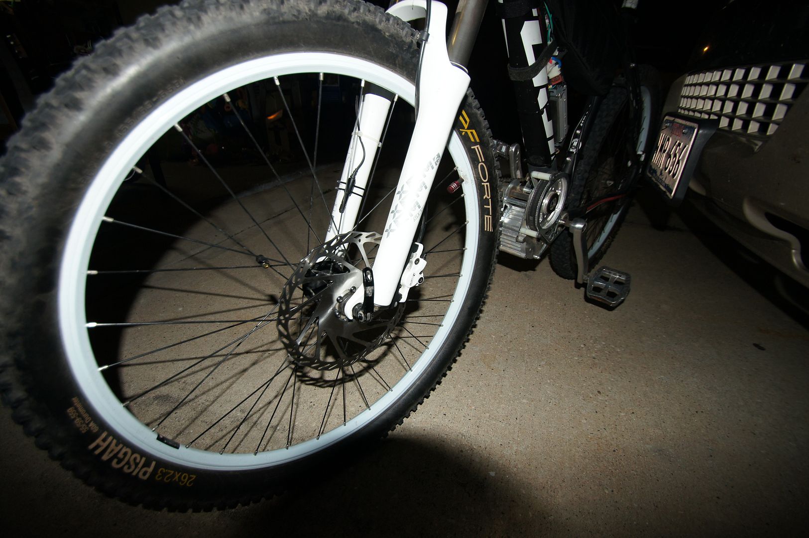

It was hella fun. I forgot to mention that I didn't have any chain drop on the trails with the chain guide and tensioner that I installed. I fell once and the chain was still on. Avg speed between the trees was 12-15mph. I swapped out the seat for a Brooks Flyer saddle. Loved this seat on the trails. I didn't have to get off the seat much, with it being a hard tail bike. It looks like it wouldn't do much on the trails, but it sure did help a lot. Was fun chasing the 29'ers without breaking a sweat.

Swapped from 160mm to 203mm Avid Clean sweep front brake rotor. Brakes smoother from 30mph now.

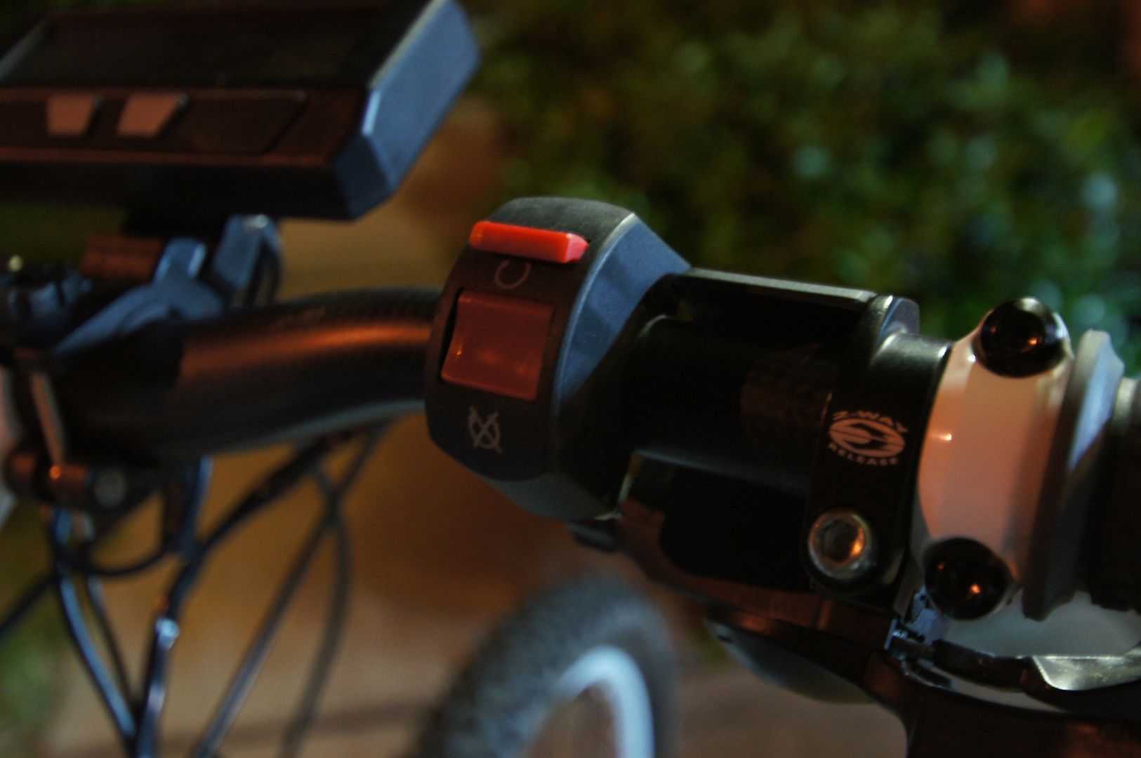

Added a "kill switch" that is just hooked up to the brake wires.

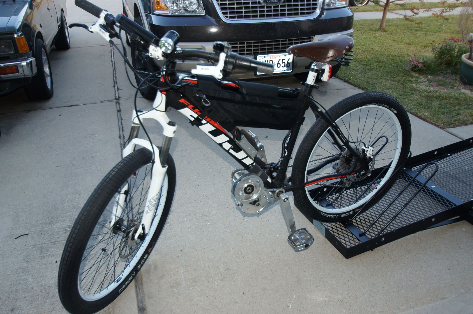

Added a medium size Revelate bag that holds 14s2p Lipo now. I like how the bag has a cable inlet in the top front of the bag.

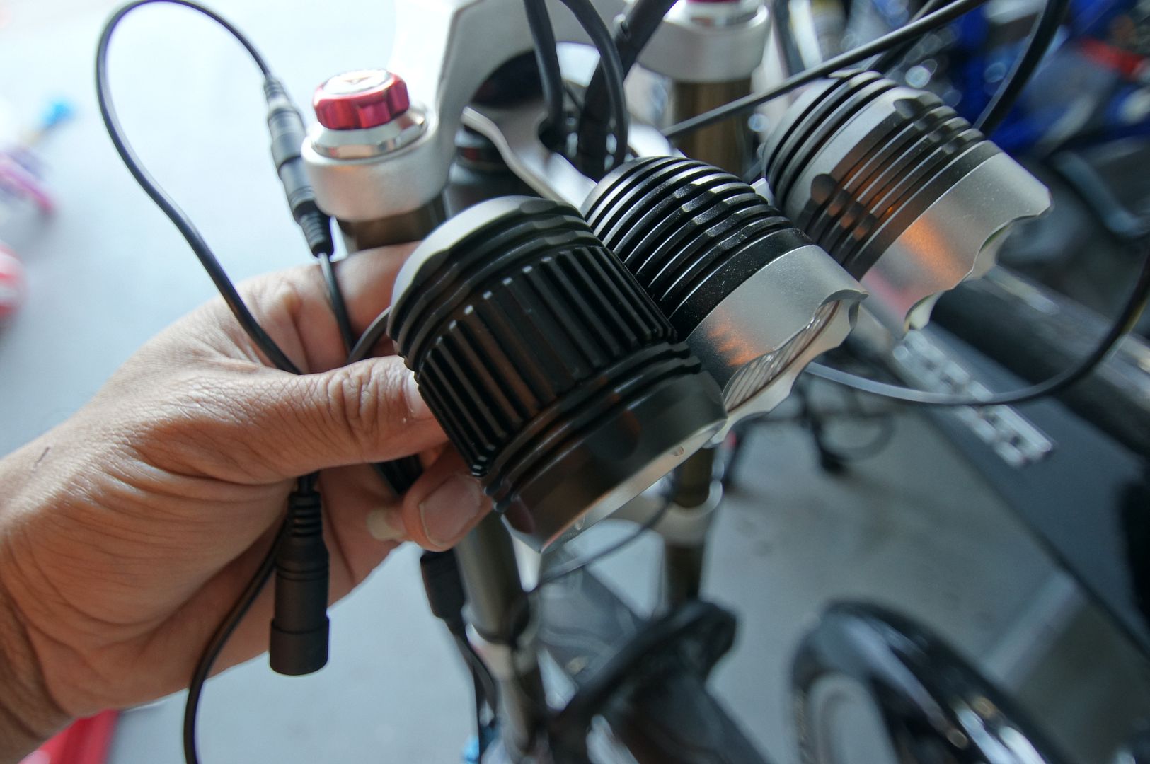

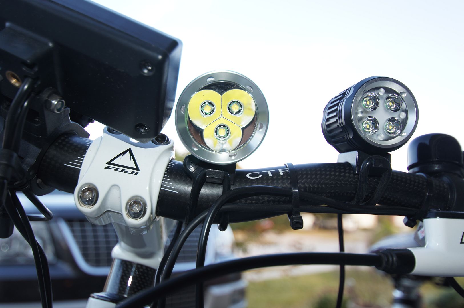

Received my new head light. It uses 3 XM-L led's and it's basically a spot light. Good news is, that those Magicshine wide angle lens fits to change the beam. Installed a set of Crazy Bob tires. What a bitch to install those things. Took 140 PSI to seat them properly and than drop them to 55 psi. They ride nice, but I will know later how much better they are compared to the Michelin Pilot sport tires on my high power bike.
