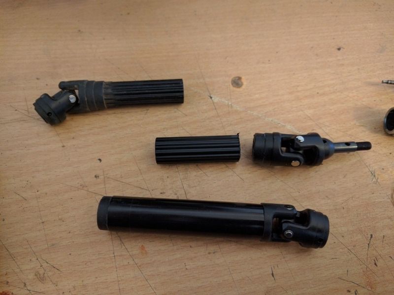

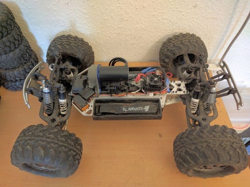

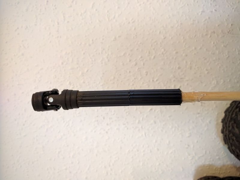

RC Monster V-Maxx Chassis with V-Stretch 50mm Extension. Makes the truck look much more proportional and handle better too from my initial impressions. Size is in line with a Savage XL now.
To get a 160mm rear shaft that will fit stock diffs I had to get creative using the stock male center shaft and the female drive shaft for the wheels.
Together they do meet but offer little contact and the connection feels weak. Even the 4s I run would twist the shafts. So I cut the male remainder off the drive shaft and glued and slotted these two pieces together on some wooden dowel. The dowel is cut and left in place.
This has lead to a solid shaft. I have tested on high traction tarmac on 4s and it has held up so far... :)

RC-Monster Mike 05.03.2016 04:43 PM
Truck is looking beastly, Wiz!

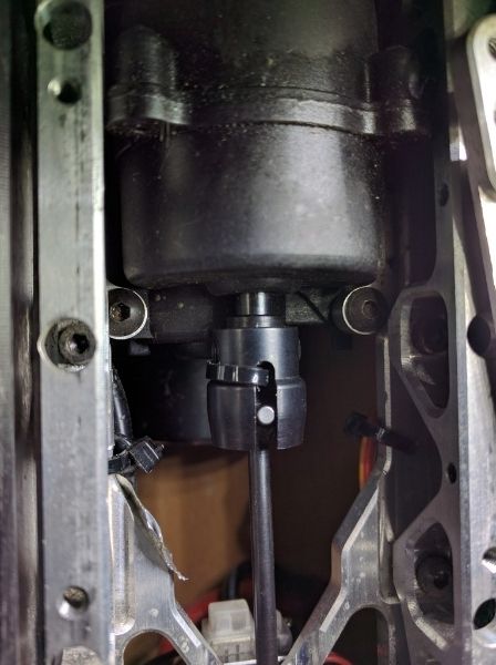

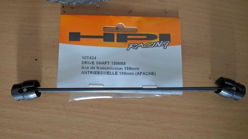

o0wiz0o 05.17.2016 04:50 AM
My drive shaft mod failed big time. The solution is to buy the 159mm HPI Apache dog bone with some UE diff cups. This dog bone is still a touch to short (5mm more req) and so I have put a Zip ties round each diff cup to limit the dog bones travel. It would never fall out but I did not like how far it could slide. :)
http://i212.photobucket.com/albums/c...psngp4mvhq.jpg
http://i212.photobucket.com/albums/c...ps2kcjf9oc.jpg
captain harlock 05.17.2016 03:38 PM
Why do I have the feeling that the shaft with such thickness and length might bend under pressure....
o0wiz0o 05.17.2016 04:17 PM
Don't be negative. It'll be reet on 4s. If not I'll moan on here. Haha.
Arct1k 05.17.2016 04:50 PM
Use a small piece of nitro fuel pipe inside the cups.
It holds in place and allows for flex. (Nitro stuff has some use)
o0wiz0o 05.17.2016 04:52 PM
Thanks Arc1tk. Good idea. ����
