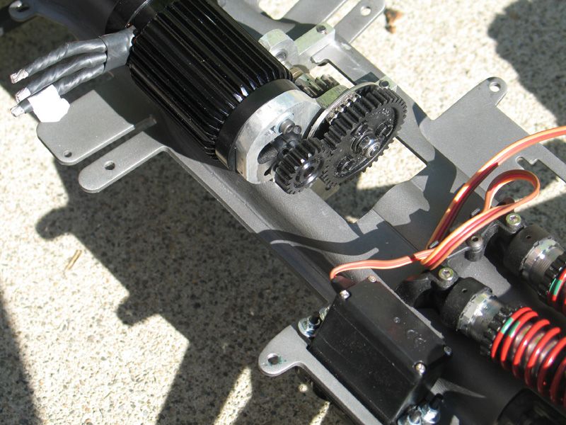

MetalMan 11.19.2006 06:18 PM
Well, that Revo center diff idea didn't work out too well. The 28t gear on it was too small for what I was going to use it for.
So, I created a semi-transmission that has a slipper clutch and a center diff together, for the ultimate in light-weight and tunability. Basically, it's my version of Mike's Slipperential, except I won't call it that because that's his name for it :027:. It mounts where the old tranny went, so it doesn't take up any extra space. The motor is a Feigao 540C 7XL. For gears, there's a Kyosho 44t plastic spur on a Hyper 7 diff, an 18t mod1 pinion on the slipper clutch shaft, a 40t Revo spur gear on the Revo slipper clutch (the slipper shaft is also from a Revo), and a 20t pinion on the motor. Here's a couple pics:
http://img.photobucket.com/albums/v1...o/IMG_4276.jpg
http://img.photobucket.com/albums/v1...o/IMG_4279.jpg
I will have to get an E-Maxx or Revo output shaft and cut it down, so I can modify it and use it as the output for the center diff.

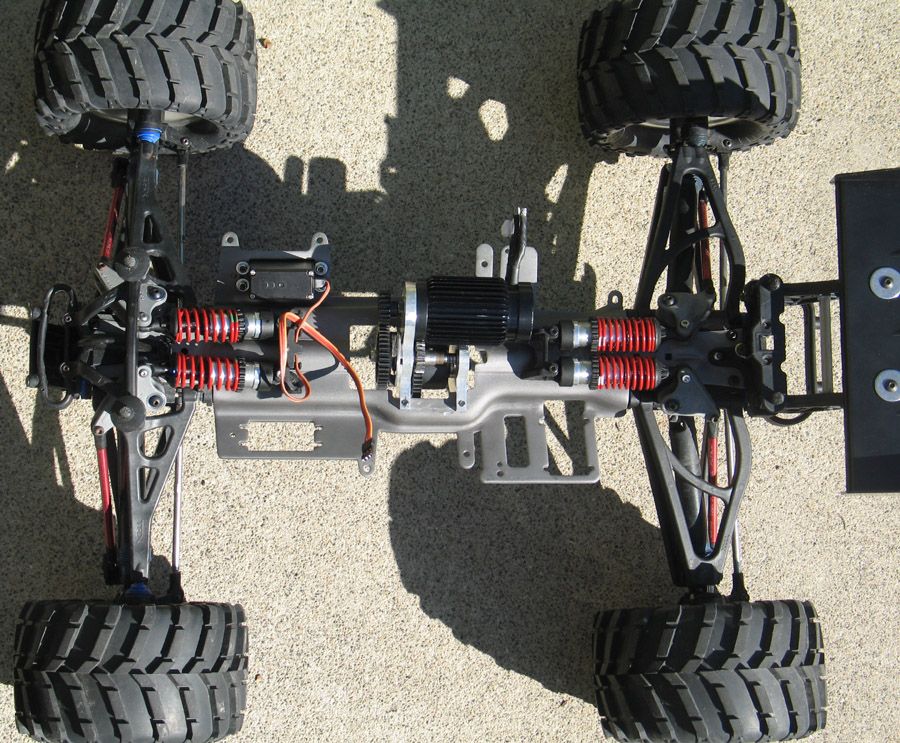

Here is an overall pic:
http://img.photobucket.com/albums/v1...o/IMG_4282.jpg
Sorry about the width of the truck, those are IMEX Romulin offset wheels (17mm Savage X hexes were used for the 17mm wheels). It looks like a square even though it's as long as they get - extended chassis (3Racing) and extended wheelbase arms.

Very nice! Mike ought to make something like that for the Revo crowd! Are you going to come up with some type of cover for the gears? Probably not needed, but you never know about those stray pebbles/rocks and that's a lot of gear exposed...
By the way, where did that extra chassis piece come from? It's the one in this pic, right under the motor wires...
Dafni 11.19.2006 06:51 PM
Nice slipperential rip-off ;)
When you trim those fins off the slipper plate, you can get the spur closer to your mount, and the revo input shaft deeper into the bearing. Just a thought :010:
Nice dimensions on this revo, Metalman. The wheelbase looks just right!

MetalMan 11.19.2006 07:08 PM
There will be a cover for the gears, and it most likely will be 1/8" thick (clear) polycarbonate, bent to shape using a flame. There will also be some sort of guard under the diff gear, but I haven't figured that one out yet.
I'm not sure where the "extra" chassis piece came from. I have done very little to the chassis. Maybe it's like that because it's not a Traxxas chassis, but an extended one that came out before the 3.3 chassis?

Technically it's not a ripoff because Mike hasn't made for the stock Revo chassis yet :027:. Maybe if Mike does make one for the stock chassis his will be a ripoff of mine :005:.
Good idea for trimming the fins off of the slipper plate! I never would have thought of that... As it is the input shaft is only in the bearing about 1mm, so this should add another 1mm of shaft into the bearing.
Thanks for the comments, guys! :004:
BrianG 11.19.2006 11:22 PM
Originally Posted by MetalMan
...I'm not sure where the "extra" chassis piece came from. I have done very little to the chassis. Maybe it's like that because it's not a Traxxas chassis, but an extended one that came out before the 3.3 chassis?
Ah, that makes sense then. The stock 2.5 or even the 3.3 don't have that extra piece, just the thin one that would hold the gas tank.
