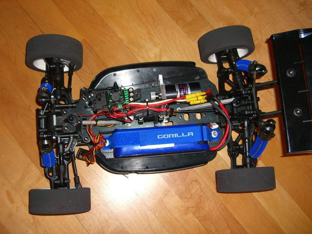

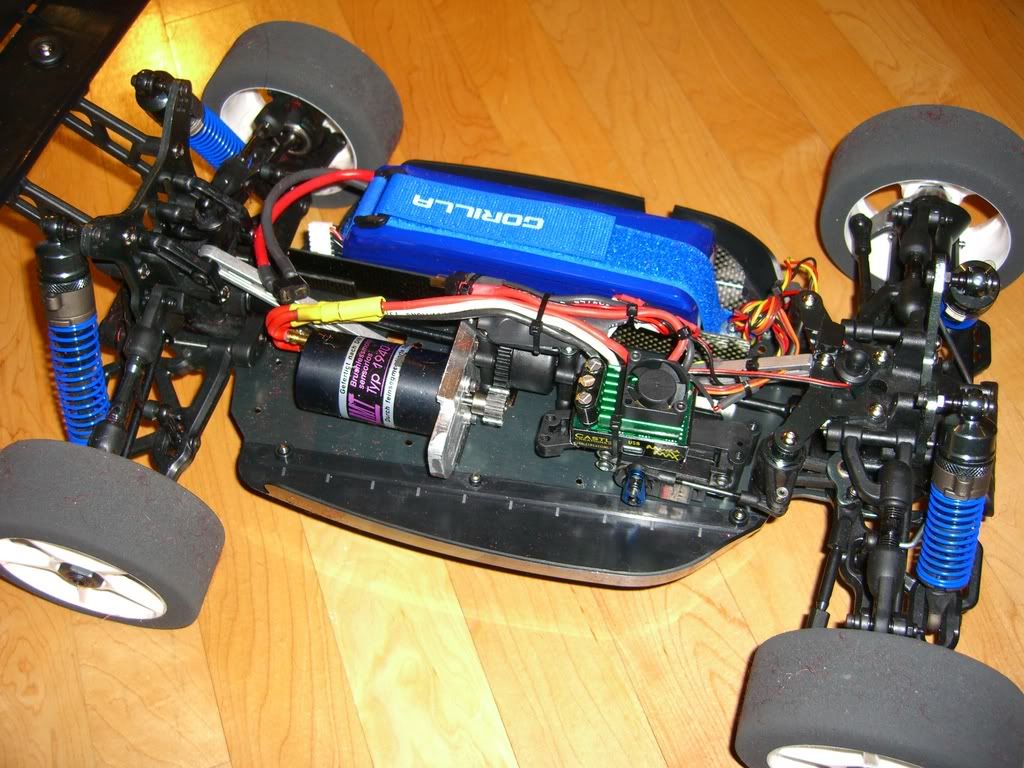

EDIT 2: And heres a couple pics of the finished setup. Just needs the Rx to be tied down.
http://i66.photobucket.com/albums/h2...z/CIMG1588.jpg
http://i66.photobucket.com/albums/h2...z/CIMG1589.jpg
