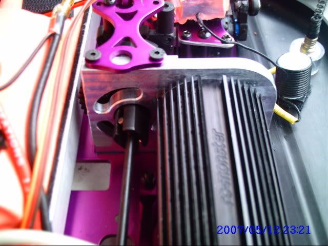

post pics of that black heat sink! me wanta see!!!!
and imo use a file, dremel can be to fast, and u dont want to go to far.... and id go just like a lil bit, just enuff for the pinion to sit on

Here's a couple of pics of the black XL clamp/heatsink on my buggy.
http://i22.photobucket.com/albums/b3...Picture083.jpg
http://i22.photobucket.com/albums/b3...Picture078.jpg
I have tried to file a flatspot on a motor before, and filed away for 10 mns and afterwards coudn't even tell where I had been fileing, maybe my file isnt good enough and I needed a diamond one (i do buy cheap tools against my dads advice) or maybe the Mega Motor I tried on has a harder shaft than Feagio, I didnt even try to file the flat on my Feagio, I just went straight in with the dremel after I taped up the motor and it turned out nicely.

http://i128.photobucket.com/albums/p...O/DSCF0773.jpg
http://i128.photobucket.com/albums/p...O/DSCF0776.jpg
http://i128.photobucket.com/albums/p...O/DSCF0778.jpg
there yah go man
jhautz 06.06.2007 10:08 PM
Take the sticker off of the motor. You will get better contact with the heatsink and it will do a better job. The sticker is acting like an insulating layer between the motor and the heatsink.
