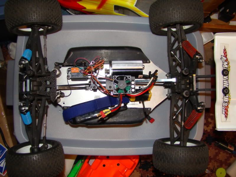

Also made a slighly cleaner layout. I'm using a modified cardboard box (from the Feigao motor) as my battery mount. Pretty ghetto but hey, it works(sorta kinda), and it was free. I use tape to keep the batteries in LOL. Man is sounds so much worse once I type it on the computer screen lmao.
http://i66.photobucket.com/albums/h2...2/DSC08222.jpg
http://i66.photobucket.com/albums/h2...2/DSC08223.jpg
http://i66.photobucket.com/albums/h2...2/DSC08224.jpg
http://i66.photobucket.com/albums/h2...2/DSC08225.jpg
Peace

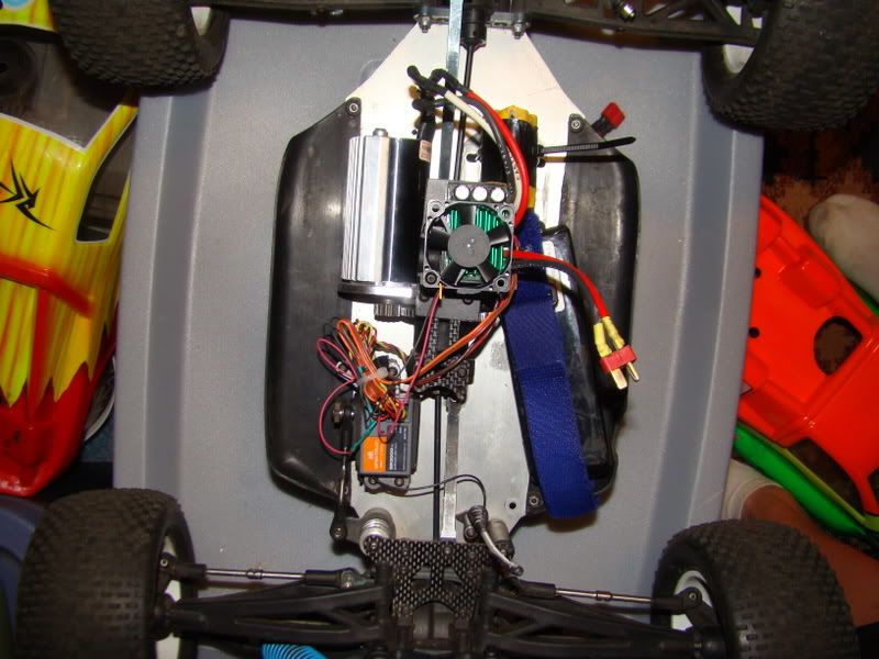

Decided to mount the fan/MM a different way. cut out a piece of spare plastic and mounted to the diff. then took a piece of the "nitro" center diff mount to screw the fan into. Works out alot better than i initially thought. WOW this fan makes a difference.
http://i66.photobucket.com/albums/h2...2/DSC08226.jpg
Dafni 07.15.2008 01:43 AM
Glad you like it! Looks good on your truck.

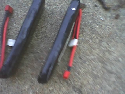

http://i66.photobucket.com/albums/h2...2/DSC08228.jpg
http://i66.photobucket.com/albums/h2...2/DSC08227.jpg
I'll have to send Mike an email real quick about that battery box because I just ordered one last fri. along with some other things.
I was just running in the street, went into the grass a little, but I was really just testing it out.

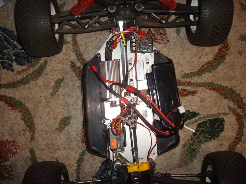

Steve Krug 08.07.2008 10:48 PM
Got the new RCM battery tray from mike. This thing is PERFECT size for my batts...they fit real snug but not too tight..
I tried the 9XL with a rotor from an 8XL, and the temps were still very high on the ESC (165F with fan)
I changed back to the 8XL and here were the temps after 1 pack of running
MM: 145F
8XL: 168F
4S ZippyH Lipo: 115F
I still want to try and keep the lipo under 100 degrees, but I can't find a way to make it happen. I programmed my MM for 100% punch control and timing as low as it can go. Running a receiver pack also. You guys know how to keep the lipo temps down?
