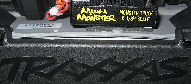

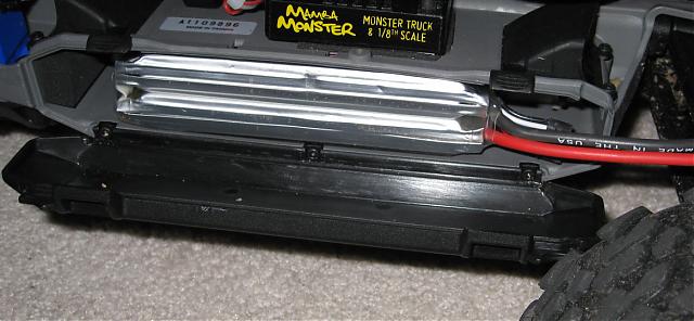

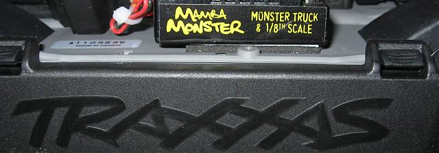

Just got the batteries in the mail today. Here's a few pics of the fit.
They are TP 5000mAh 3S. The top bulges up a little bit but I think that is because of the spring clip. The doors close smoothly without any pressure and you can still feel that there is airflow over the top of the packs through the vents from front to back. |
Looks like the perfect battery
