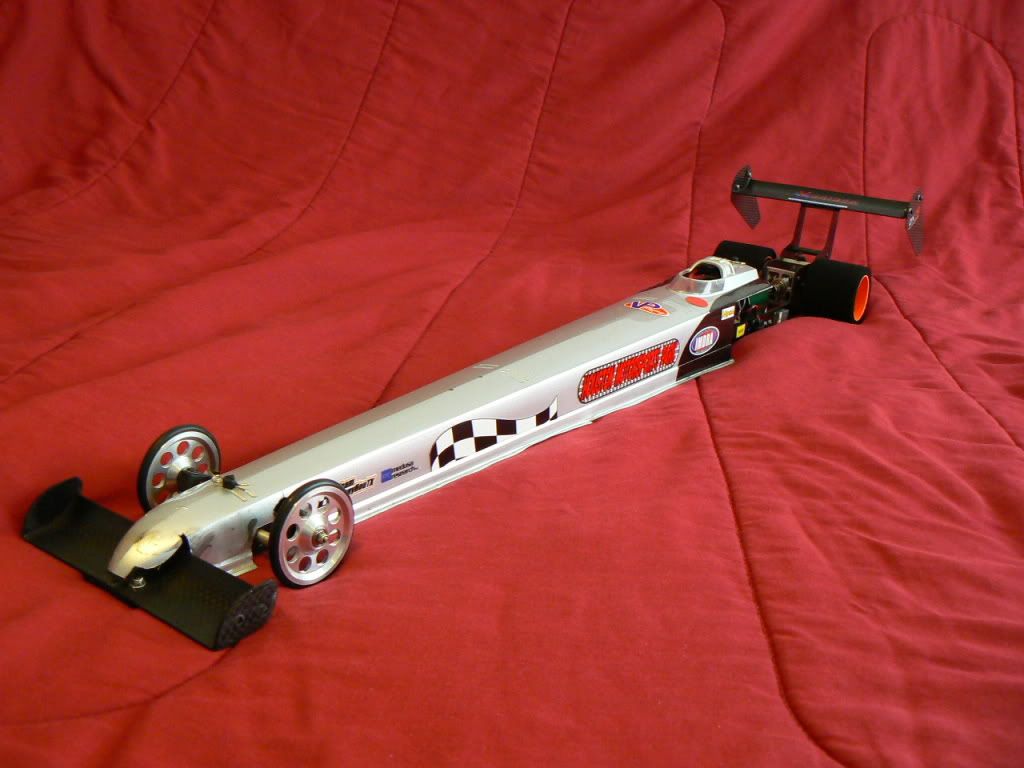

I will have one of them in my 3S TFE dragster for at least a couple of passes. Not to worry Pdelcast and gang, I always send a check in with my repair orders :whip: :mdr:
My TFE dragster:
http://i256.photobucket.com/albums/h...d/P1020083.jpg

That's ungly. I'll take it out of your hands for free though. I'll make it look pretty lincpimp style.
DickyT 11.20.2008 06:43 PM
Wow those things move sunny!
lutach 11.20.2008 06:45 PM
Sunny will be in trouble once I get the hang of drag racing :lol:. Watch out Sunny :whistle:.
