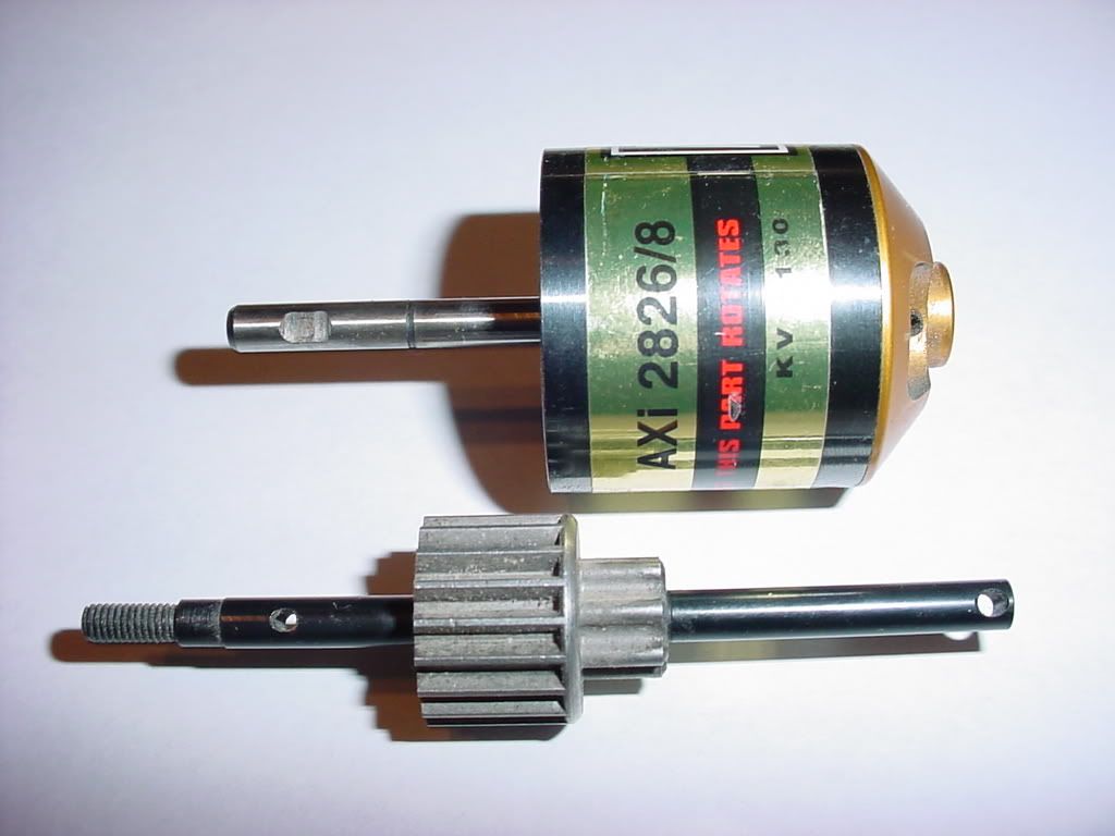

Ok, take a look at this. :yes:
http://i160.photobucket.com/albums/t...m/DSC07344.jpg
What do you see?
Remake the motor shaft from a transmission input shaft. Then the slipper will bolt right on like normal. Both shafts are 5mm.
I can see alot more gearing choices this way. OR wouldn't it be different if the slipper was on the motor?
Hmmmm..........the possibilities.

How are the tolerances on the input shaft (diameter)? I was thinking more along the lines of buying a die and modifying the original motor shaft, but your idea obviously requires a lot less work :oops:
sikeston34m 03.06.2009 12:37 AM
The Tolerances are good! :yes:
The bearings of the motor AND the bearing used in the transmissions have the same ID. Very nice fit. I just tried the input shaft into a 2826 that I have here.
The 2826/8 won't work with this type of gearing, but a lower kv motor would. I'll have to plug some ratios/kv's in and see what pops out.

Originally Posted by MetalMan (Post 271438)
If the CC outrunners are as good as Patrick says they are, it may be worth switching over to them. But since we don't have any info. on them or samples to try out, we can't be sure.
#5 needs more input! :lol:
Sammus 03.19.2009 10:24 PM
So what's the advantage of outrunners? It's been said a few times that for their size theyre not as powerful as inrunners... it cant be the kv because you could just wind up an in runner to get super low kv... so what is it then? are they somehow heaps more efficent or something?
Why do people love running them in cars so much? IT seems lik inrunners are much better suited.
rotary rocket 03.19.2009 11:09 PM
It seems to me that if outrunners have a lot of torque you could use it to your advantage and get rid of the center diff. This would save weight and should result in a more efficient overall drive line.
Of course you would pick a much lower RPM motor and you wouldn't have much flexibility in changing your speed if you use it in place of the center diff.
CC, would you be able to make your motors such that the center shaft is sticking out of both ends?
