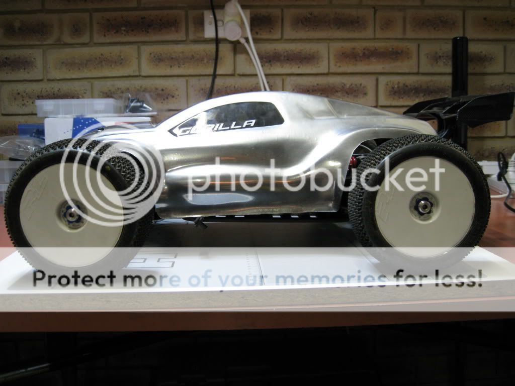

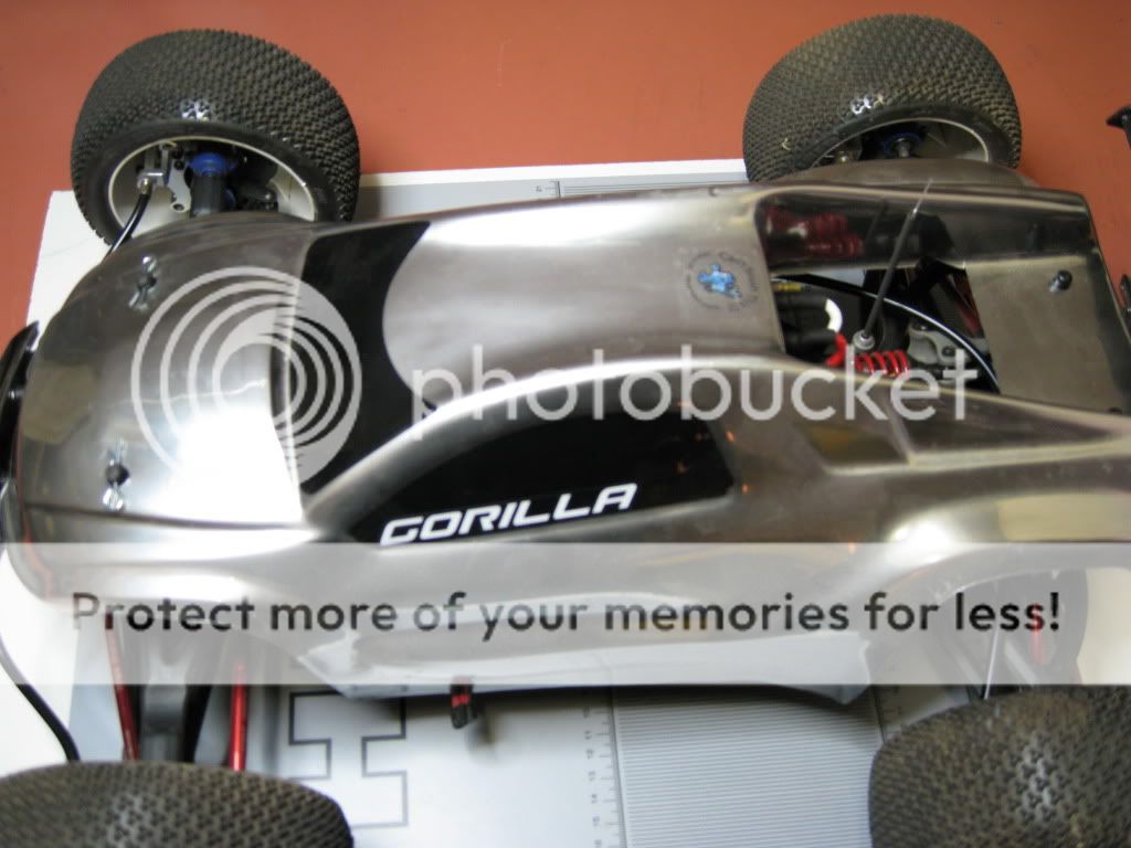

Ok guys so sorry for the delay but it is finally done, i just got back in from doing some all round testing and everything looks good so far. The only thing left to do is some hard core testing with my eagle tree and post some photos.:party::party:
SV6000 12.11.2009 04:02 AM
Here she is
http://i705.photobucket.com/albums/w...0/IMG_0152.jpg
http://i705.photobucket.com/albums/w...0/IMG_0153.jpg
http://i705.photobucket.com/albums/w...0/IMG_0157.jpg

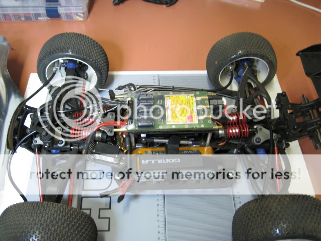

SV6000 12.11.2009 04:04 AM

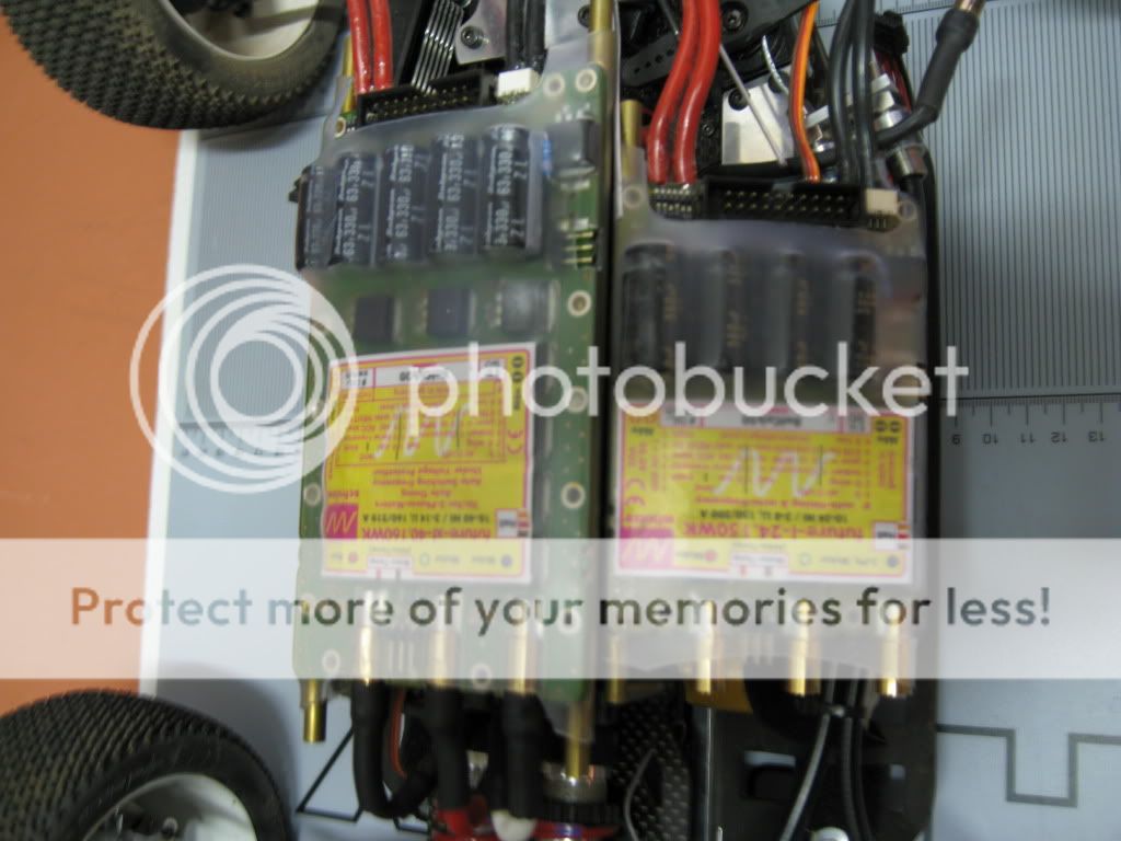

After seeking some advice and speaking to the guys at schulze i decided a bigger speedy was the go, so i went with the future-xl-40.160WK. Here is a photo of it compared to the 24.150
http://i705.photobucket.com/albums/w...0/IMG_0158.jpg

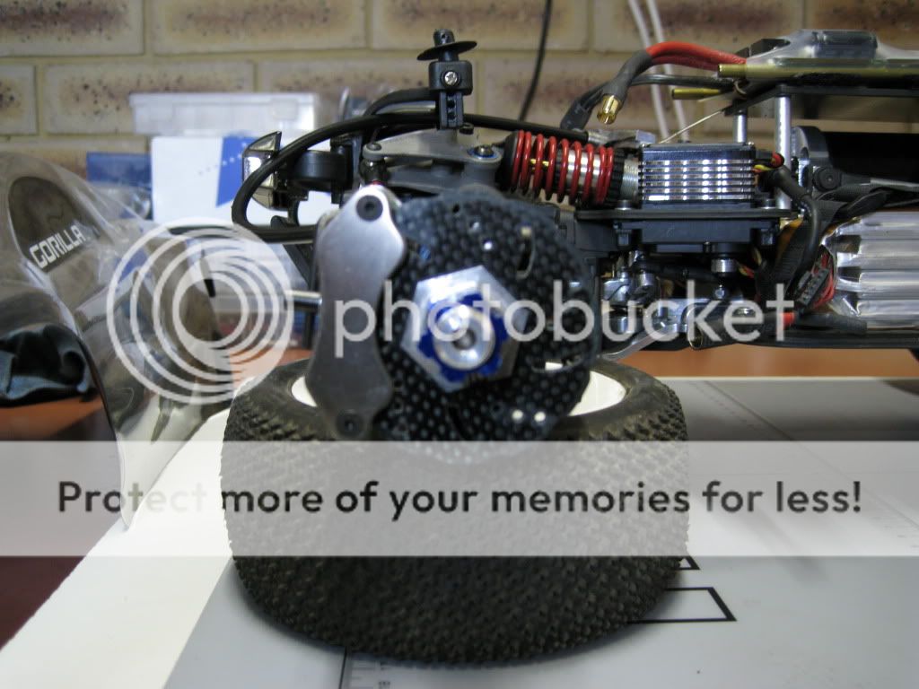

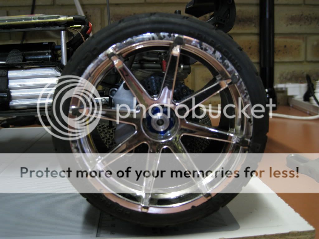

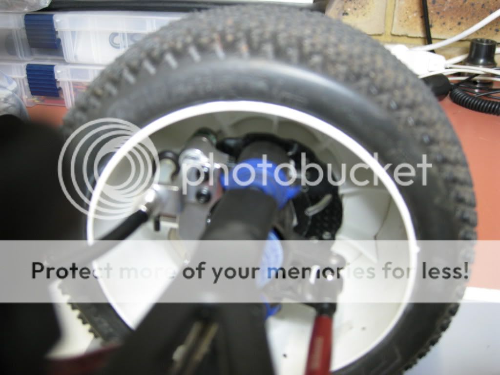

SV6000 12.11.2009 04:08 AM
As i said earlier i wanted a mechanical brake setup if for nothing else because it looks cool.
I ended up with 4 wheel disc brakes that function very well and have no trouble pulling the truck up. I still need to do some more testing to decide if i will keep them or not.
http://i705.photobucket.com/albums/w...0/IMG_0165.jpg
http://i705.photobucket.com/albums/w...0/IMG_0168.jpg
http://i705.photobucket.com/albums/w...0/IMG_0171.jpg
http://i705.photobucket.com/albums/w...0/IMG_0174.jpg
http://i705.photobucket.com/albums/w...0/IMG_0176.jpg

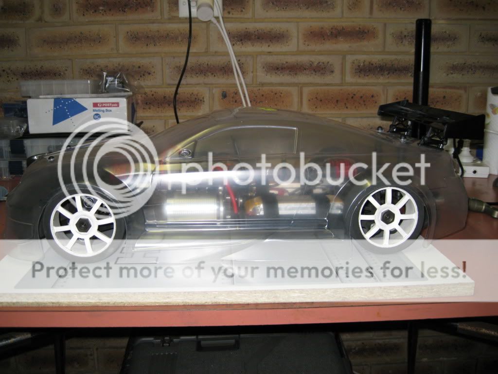

SV6000 12.11.2009 04:17 AM
And to finish off here are a couple of photos of my DM 1
http://i705.photobucket.com/albums/w...0/IMG_0181.jpg
http://i705.photobucket.com/albums/w...0/IMG_0182.jpg

God damn that incinerator unit/esc is huge!

SV6000 12.12.2009 12:11 AM
Originally Posted by Popoxx (Post 338458)
Awesome work ! I love the mechanical brake setup :yipi: Did you made it or bought it ?
The brake kits are for a BAJA and i modified them to fit. The company that makes them is, well inXXXXtgy sorry don't know if i can say that word here.
In order to get them to fit i had special hubs made up that are 24mm hex to start with, drop down to 17mm hex for the rims and than the standard traxxas thread. I noticed how much the standard traxxas hubs wear when i first ran the truck so those hubs are an interference fit. If you didn't put the retaining pin through it would still turn and the wheels would not come off, in fact with out a hammer you wont get those hubs on or off.
I also had the cable holders made up, everything is made from 7075
Here's a link http://www.integy.com/st_prod.html?p...94&p_catid=126, you will also need a very strong servo, http://www.hitecrcd.com/servos/show?name=HS-7950TH i use one for steering as well. The cable are all shimano racing bike cables as the stock ones are very average.

Hey Neil you should check out the schulze website and see the 40.300WK. Its twice as wide and comes with its own metal heat sink case. It is one big speedy.

When you see what that schulze ESC was worth i wanted to do anything i could to make sure it never went in for repair. I had to take out a second mortgage:lol::lol:
