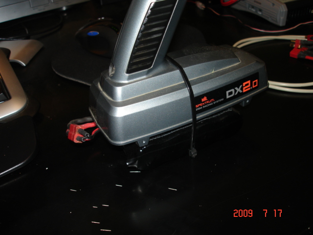

Whow, right after I typed that out, the voltage fell to 12.6volts.
J57ltr 07.18.2009 04:48 PM
I wonder if it just sits idle unless the reciever is also on, kinda like a sleep mode?
Jeff
zeropointbug 07.18.2009 05:29 PM
No, I don't think it does... when I used AA alkalines, you turn the switch on, then after a 2 second pause, the LED on the back lights up and the voltage suddenly drops. It must draw a good amount of power.
nitrostarter 07.18.2009 07:28 PM
I took the Summit out today and the cell phone batteries worked flawlessly in the Tx. Awesome! Let see how long they last on 1 charge now....
zeropointbug 07.18.2009 07:49 PM
What is the mah and voltage on that pack?
