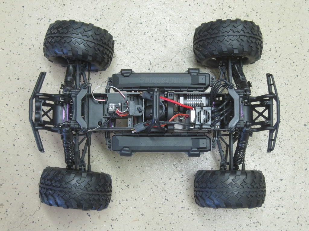

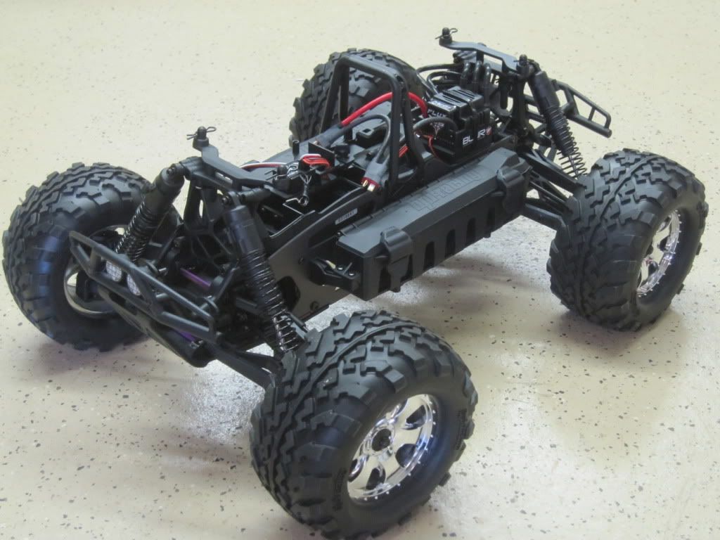

I'm curious, how did you set up the body? Does it hold?
thzero 04.18.2011 02:18 PM
The "wide track conversion" is nothing but the HPI 86249 Super Heavy Duty Wide Axles Savage XL axles.
rckcrwlr 04.18.2011 02:19 PM

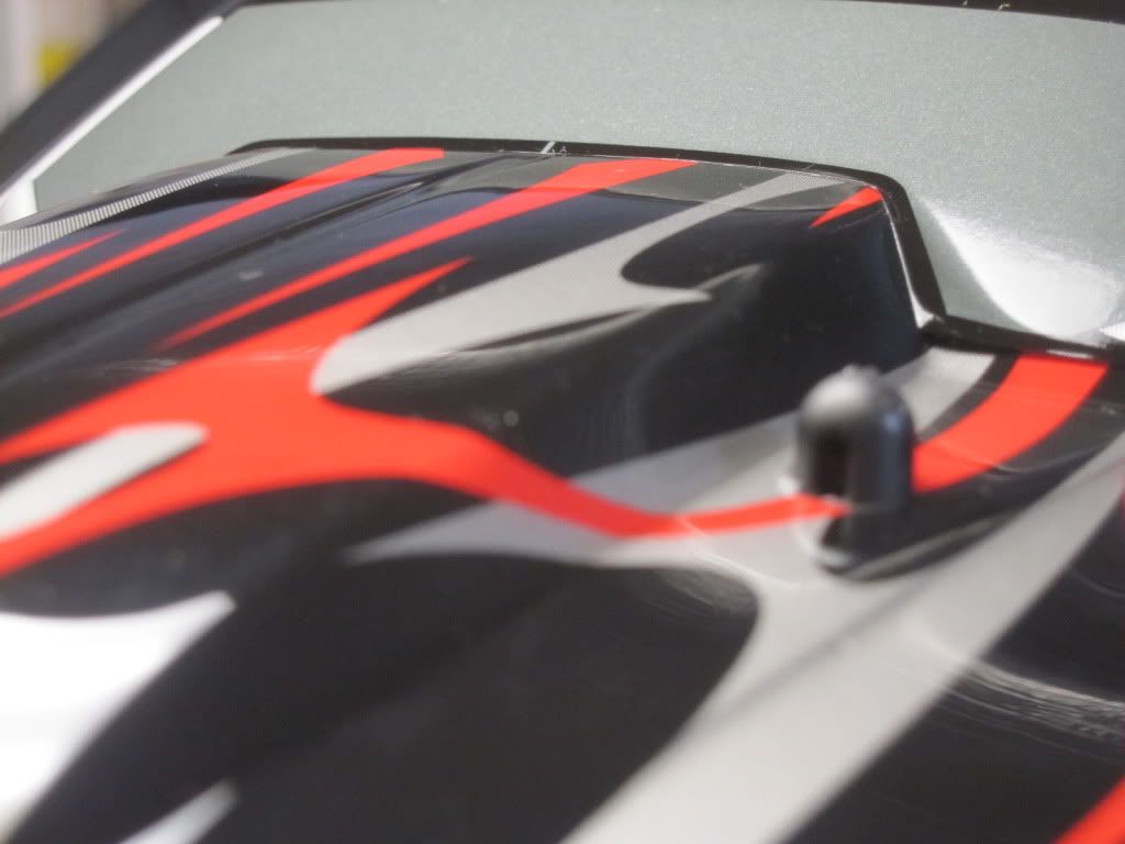

I have one body post on the top of the radio box and then mounted a short post on top of each battery box.
It works great.
Dj_Sparky 04.18.2011 02:23 PM
Could you snap a picture or 2 of how you did it exactly? :)

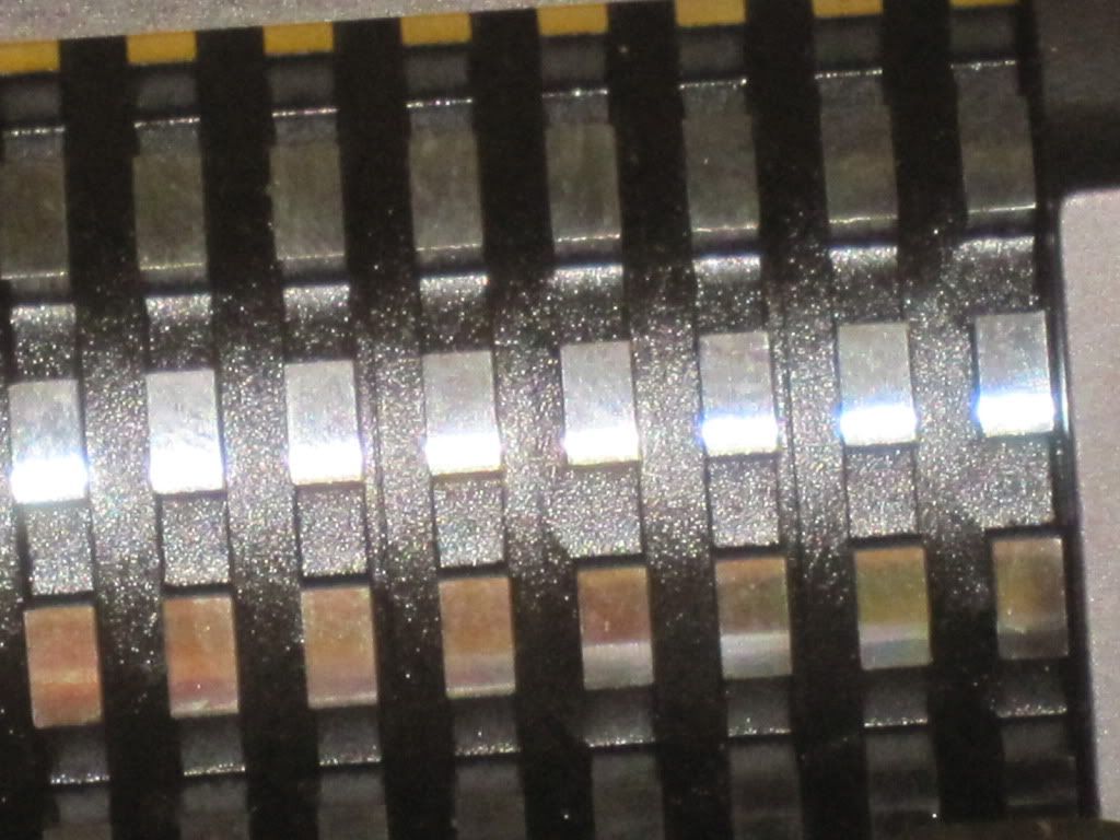

I was testing some motors for a vendor so I go the Flux 5B out.
Ran different combos and had it dialed in...then..................... it stopped....
Got to finally get it apart and found this rattle can
http://youtu.be/4shDlKdcXE0
Opened it up to find this...
http://i778.photobucket.com/albums/y...-44-18_195.jpg
http://i778.photobucket.com/albums/y...-44-45_204.jpg
But where are the teeth???
:gasp:
Oh, there they are.
http://i778.photobucket.com/albums/y...-44-55_240.jpg
Here's the failed parts. Surprisingly there was no other damage.
http://i778.photobucket.com/albums/y...-03-44_330.jpg
coolhandcountry 01.11.2012 10:22 AM
I think you broke it.
Nice looking savage / buggy.
rckcrwlr 01.11.2012 10:58 AM
Thanks...I just wasn't sure if the gears were supposed to look like that... :rofl:
Ordered the upgraded gears. Then back to having fun...
