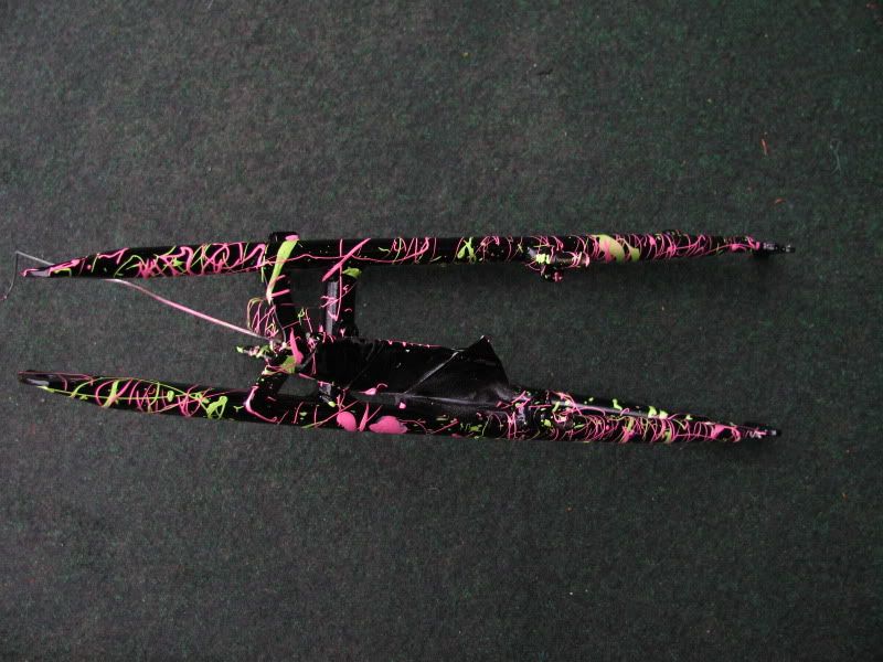

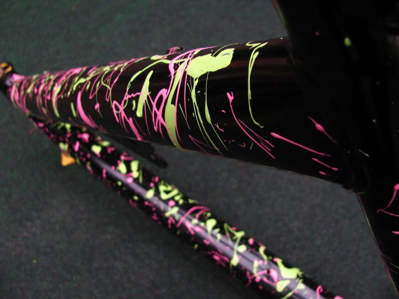

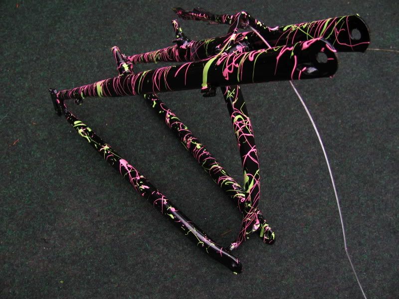

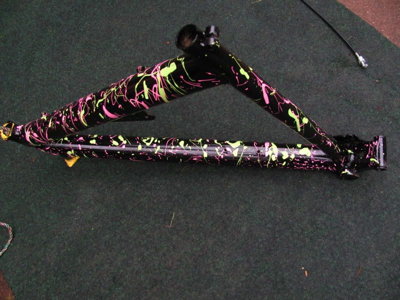

To be honest, I didn't expect it to be so expensive. Small things like the 2 one-way bearings costed me $160, which is quite expensive for some bearings imo. Just costs I overlooked... A rough estimation: €1500 (about $2100) including everything except the bike itself. Great to hear your son wants to do something like this. Sometimes it's really frustrating for me, I never did something like this before (I'm 17 myself) so it's very new for me too. But everytime I finish something (painted the bike, made the driveline etc.) I get a huge smile on my face which is awesome and keeps me motivated! :mdr: |

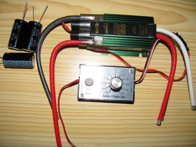

http://img696.imageshack.us/img696/755/img3208k.jpg Front-top http://img215.imageshack.us/img215/7131/img3210ky.jpg Back-top http://img801.imageshack.us/img801/673/img3211c.jpg Inside http://img34.imageshack.us/img34/733/img3212lm.jpg Closed http://img638.imageshack.us/img638/772/img3214d.jpg CC ESC mounted underneath the battery box, I like this design http://img225.imageshack.us/img225/8789/img3215x.jpg Battery connectors http://img813.imageshack.us/img813/2743/img3225u.jpg Frame mounts http://img232.imageshack.us/img232/9641/img3227x.jpg Closer view http://img21.imageshack.us/img21/9880/img3228m.jpg Put some soft foam in it to protect the frame |
