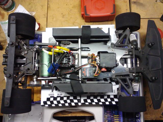

I am going to make up a mount that I think will even house a 1518 (from what I can measure it should). I am not sure if I'll use the 1518 on it but if I do it will have to be on 8S. That will mean a plane ESC (to keep the costs down) and will need to run mech. brakes (I think I have even this figured out).
What is troubling me now is the absence of front braking. Actually scares the crap out of me. I really want to run front brakes but that means locking up the font axle. How would this make the car handle? I wont be racing it as I just want something fast and fun but don't want something that corners like a drunk pig. Wish that there was a front diff option.

Unfortunately the pair of one way bearings seem to be the front diff. Personally I'd rather have the 4 wheel braking, so I'd set it up that way and see what happens. It might turn pretty good, and shifting more weight up front will help the car turn better too.

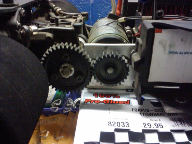

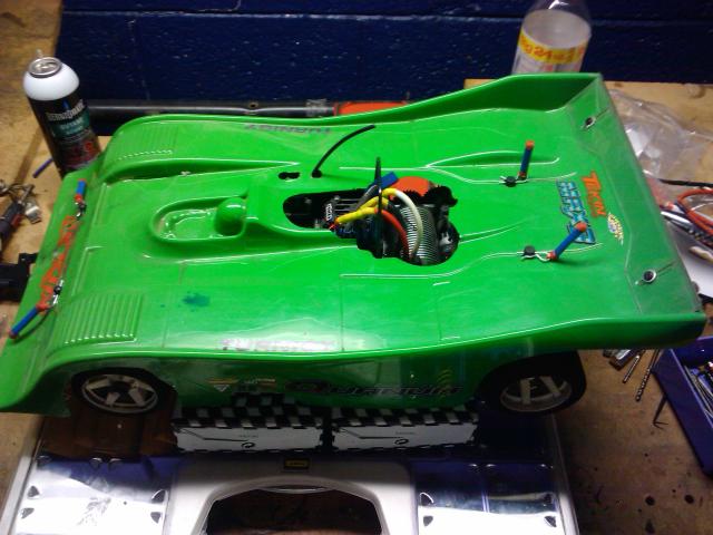

Motor brake works fine, ill give you what i have so far it's not a benchmark it's just what i can report !
So far i've radared the car a few times in one day
2200kv
4s
38 spur
25,25 pinion
69/70 mph back to back runs
need a better mount and then i could really pour on some speed !!!!

All this talk about locking the front diff spurred me to chime in. You guys want a similar setup to what the 1/10 TC cars run. Diff in the rear and a spool up front. This will give you 4 wheel brakes and will allow the car to rotate. the trick is finding a diff that will fit. Serpent used to make some really sweet rear diffs and I'm sure there were others back in the 2wd 1/8th days. Just need to do your homework.
http://www.serpent.com/product/808390/
There is a 50 tooth pulley option. I have one of these and they are very trick.
I've attached some pics of my projects.

The Lipo is in the center? Can it fit a 4 or 6s?
scratchbuilt 06.27.2011 06:07 PM
As you can see the pack is a bit off center and the one shown is a 4s, 5200mah, 40c lipo pack from SMC. I used this pack because it has a similar footprint as the standard ROAR legal lipo packs. 138mm X 48mm X ?mm tall.
