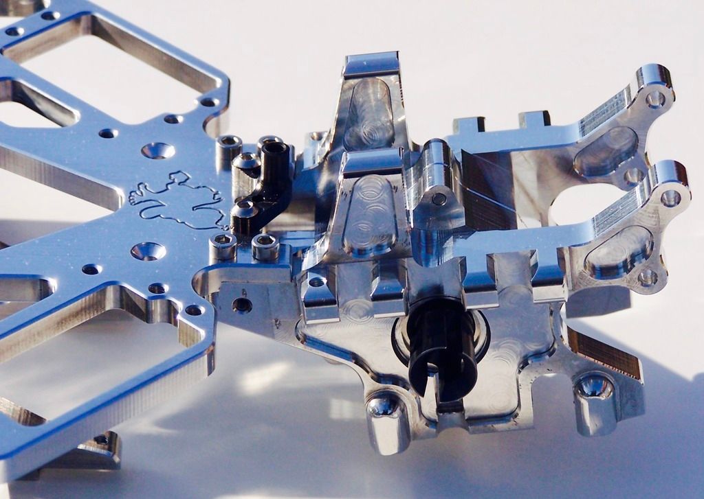

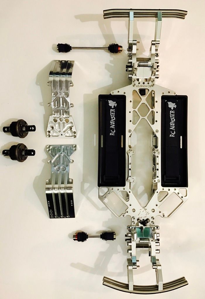

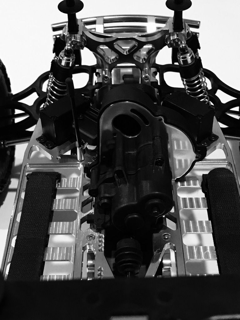

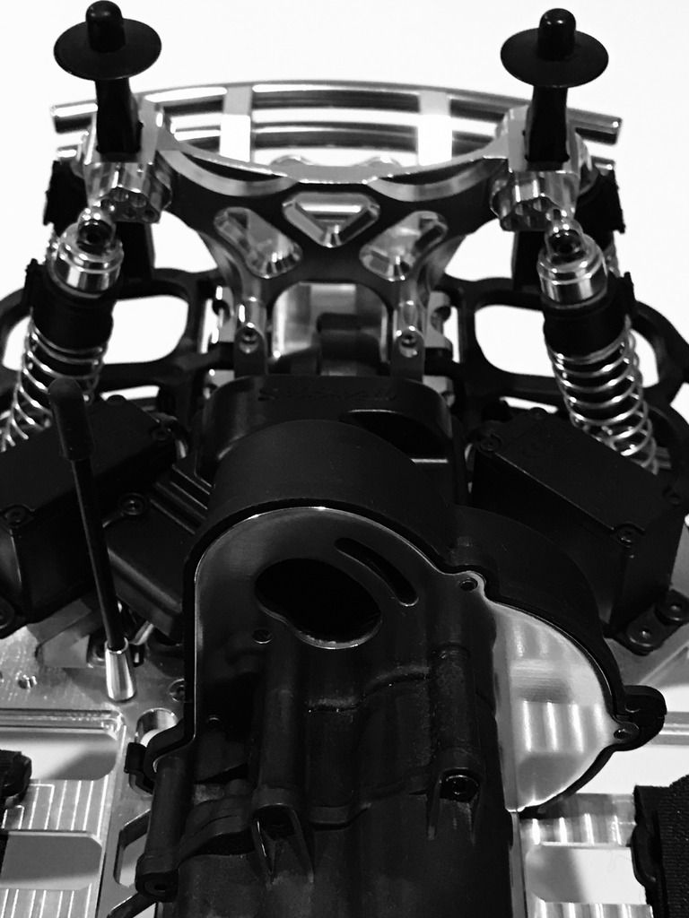

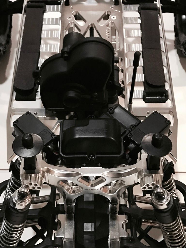

http://i1342.photobucket.com/albums/...pshbbvwlpy.jpg http://i1342.photobucket.com/albums/...s7i2qqxu1.jpeg http://i1342.photobucket.com/albums/...suwlk4cy0.jpeg http://i1342.photobucket.com/albums/...psoaxanmtf.jpg http://i1342.photobucket.com/albums/...sj6rtauef.jpeg http://i1342.photobucket.com/albums/...s6wytaax0.jpeg http://i1342.photobucket.com/albums/...swrjfiskb.jpeg http://i1342.photobucket.com/albums/...ssub15iv3.jpeg Here are some recent pictures of the updates to the V-MAXX build and more to come. i will be using another body for the build; however, another 73 Bronco and different color. I just recently ordered a Gen-3 Robinson Racing slipper clutch to replace the stock slipper clutch. |
Nice build.
Thanks Arctik! This forum has shown kindness and favor in assisting me in this process of learning how to build my own E-MAXX..
That's coming together quite nicely. I love the Hi-Res pics. I can't wait to see what else you've got planned for it.
Thanks _Paralyzed_! I just installed a Robinson Racing Gen 3 slipper clutch to replace the stock one. I am working on all the mechanical parts for now. Later on in the build the electrical components will come into play cause' I enjoy the research end of the build. Look forward to posting the results of the build.

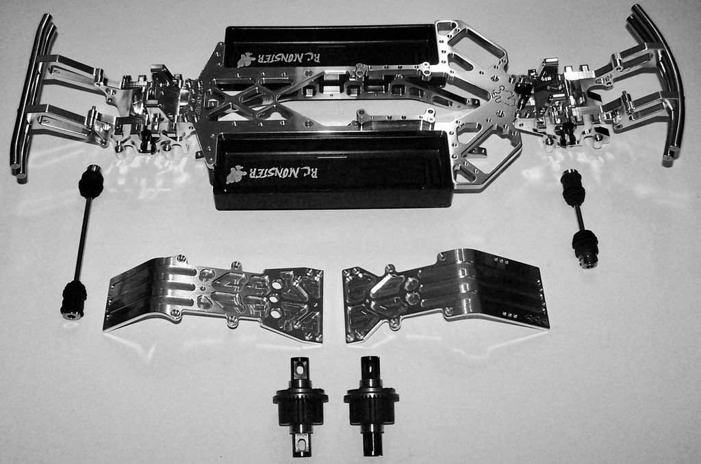

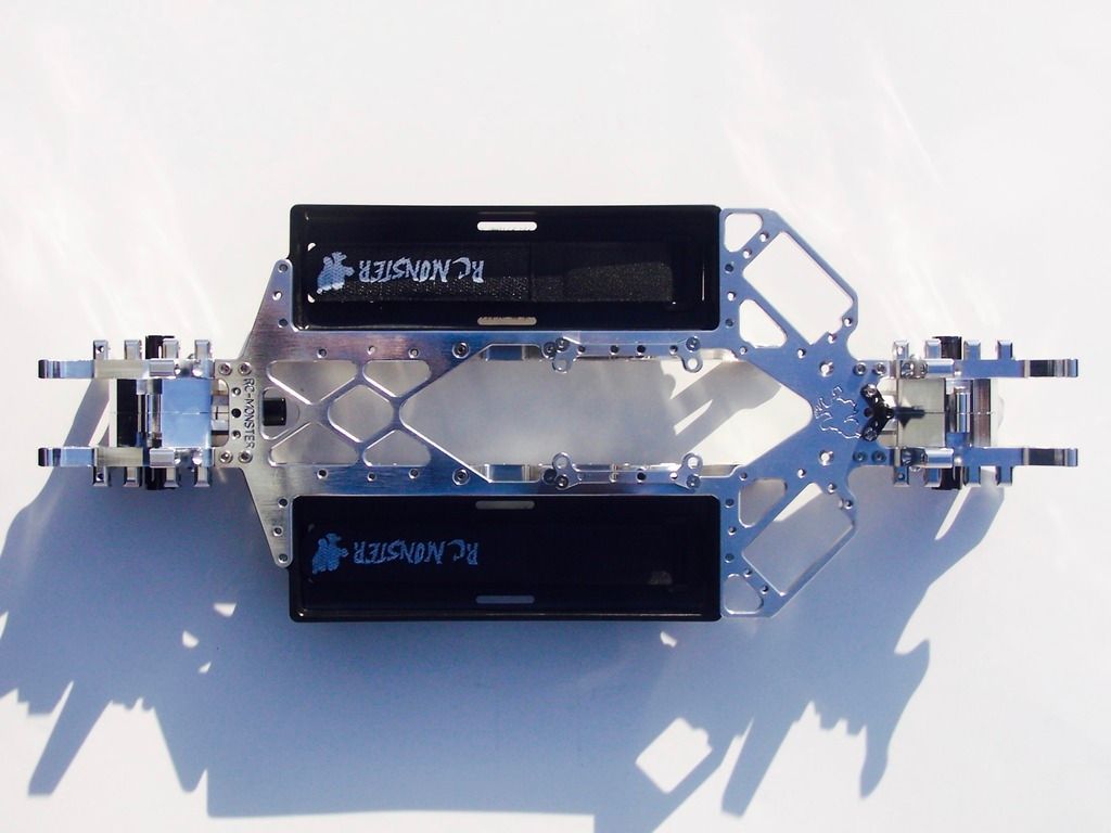

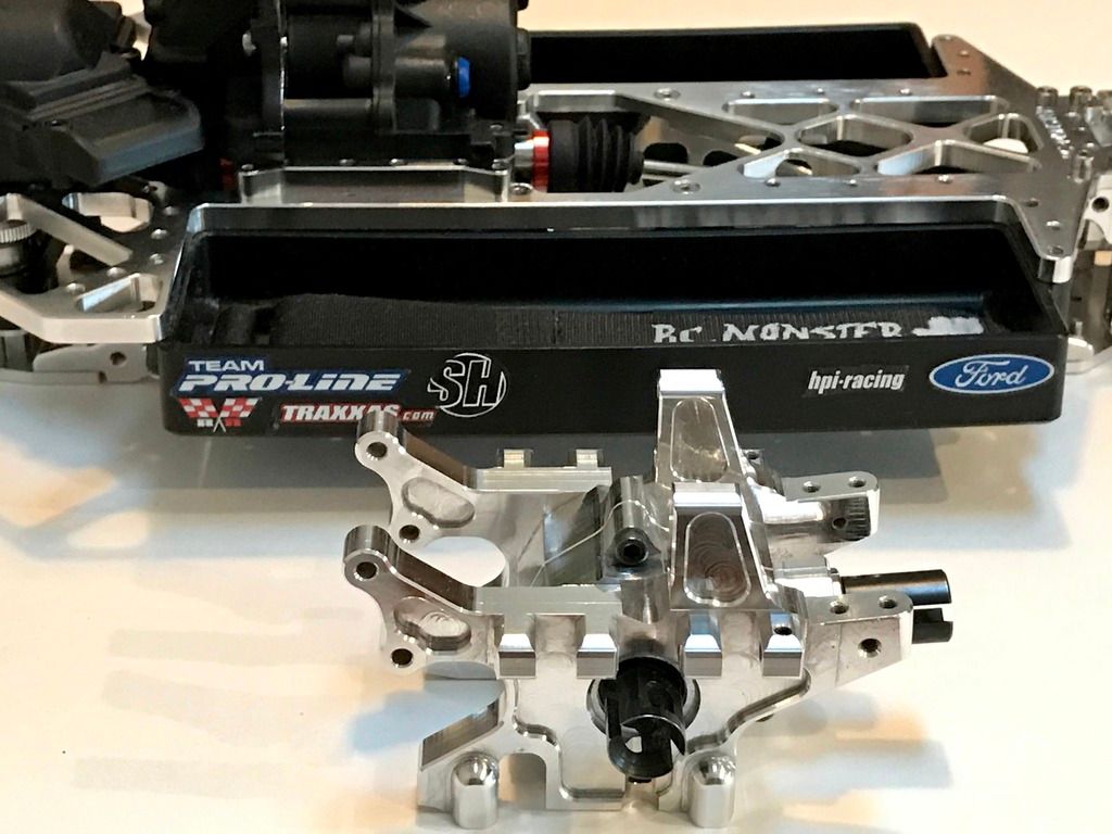

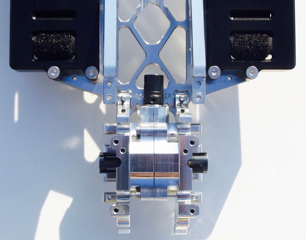

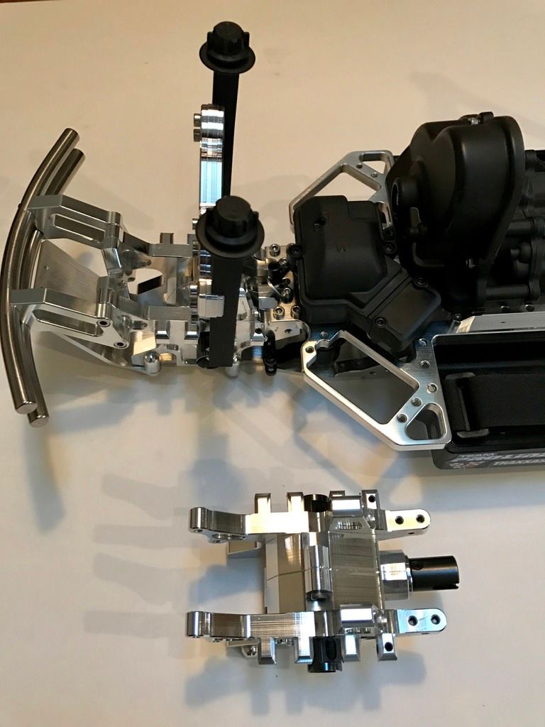

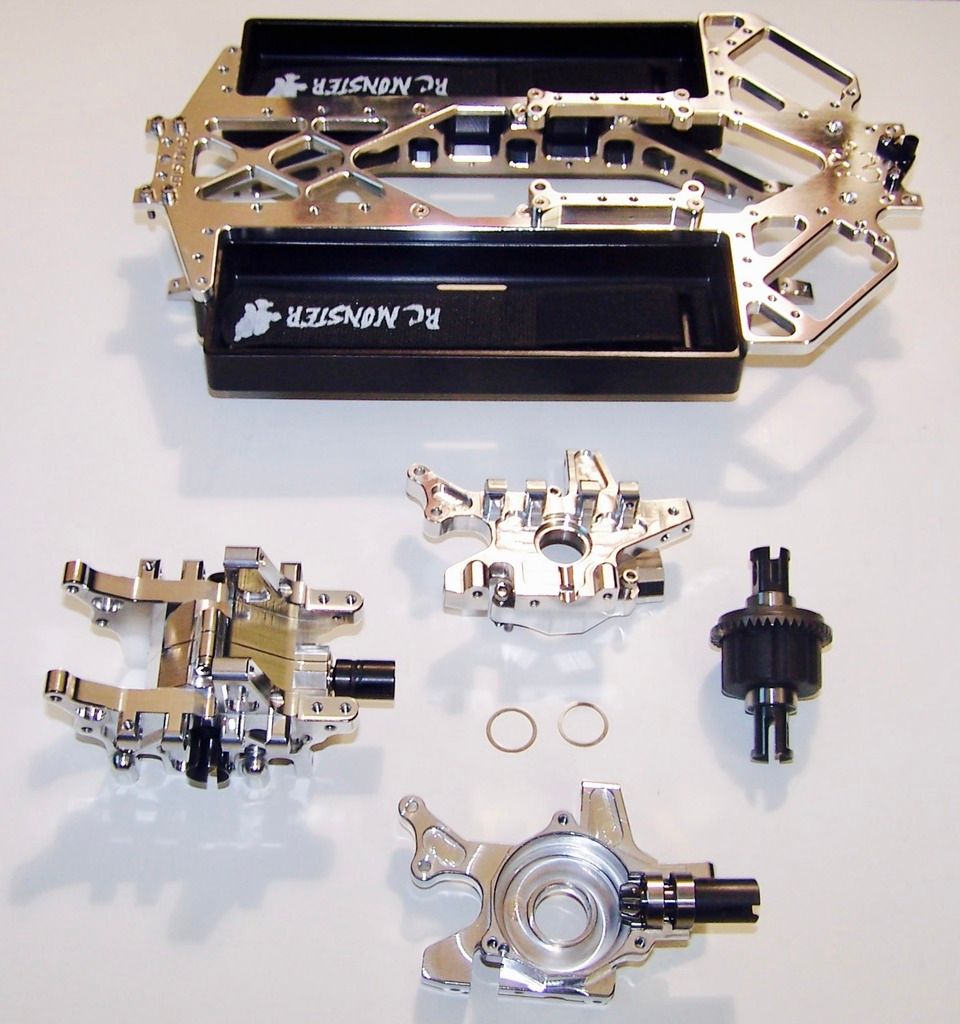

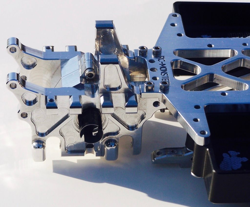

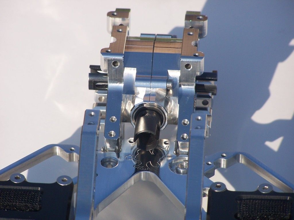

Here are some pics of the number two truck (roller for now) with FLM chassis. Getting it ready for brushless combo. All that is needed is 1/8 scale diff cases before purchasing brushless combo.
http://i1342.photobucket.com/albums/...stzxunswx.jpeg http://i1342.photobucket.com/albums/...syfdeeo6k.jpeg http://i1342.photobucket.com/albums/...sljp3bdoj.jpeg http://i1342.photobucket.com/albums/...s9v6kexbx.jpeg |
Looking good man!!
Thanks Nitrostarter! This truck is a up-grade project.

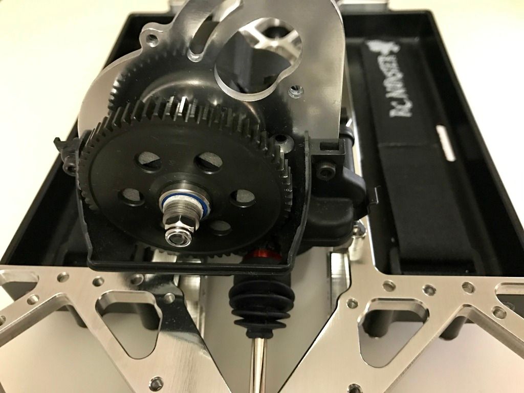

Recently installed a Robinson Racing GEN 3 68t spur gear. Will install the pinion gear with Castle's 2200 kv motor. Any suggestions for the tooth # for the pinion? |
I used 16T pinions with that same spur and 6S. Was pretty healthy.
KMN, is there less issue concerning heat w/batteries, ESC and motor using a higher tooth pinion- since I have 43t/10t diff-gears? Also, how would 16t pinion affect the diffs? Thanks for your assistance again.

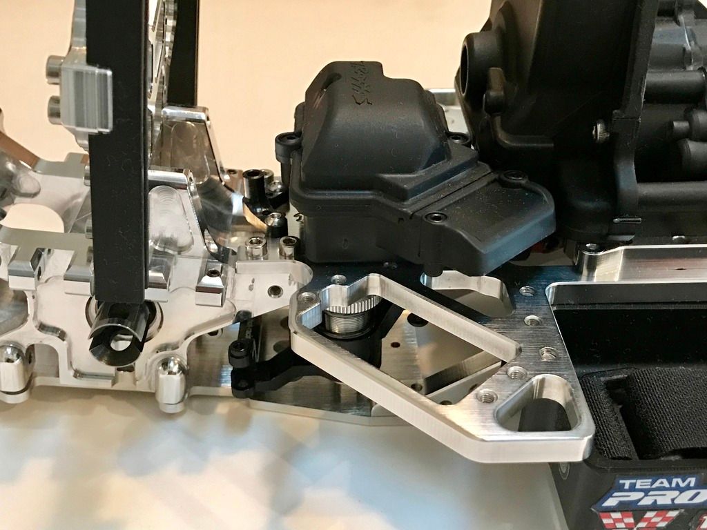

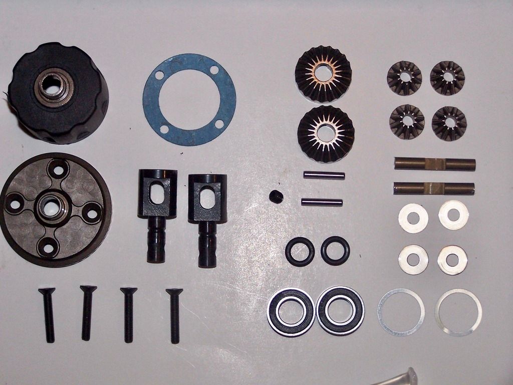

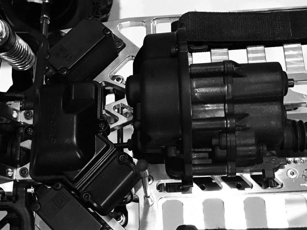

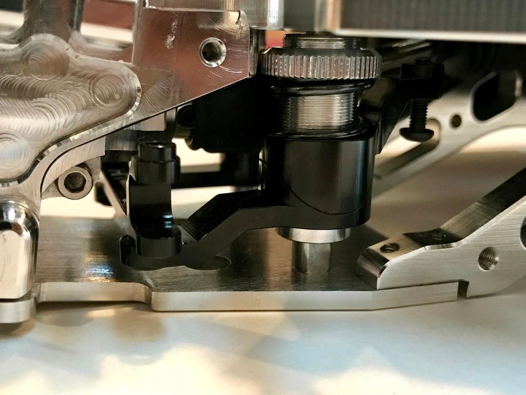

http://i1342.photobucket.com/albums/...sddamfeup.jpeg http://i1342.photobucket.com/albums/...shl9nw1uz.jpeg http://i1342.photobucket.com/albums/...s9xncixtz.jpeg Pics of recent additions to the V-Maxx build. I have installed a Hot Racing aluminum bearing saver steering kit. I removed the blue anodized part of the kit and polished it. (Blue did not go with the color scheme.) Also installed the receiver case. The extra FLM diff case and gears are for the FLM chassis #2 truck upgrade. Getting the second hybrid diff case soon. |
Looks good ..... sooo clean
Thanks Tinuss! Both the V-MAXX chassis build and updates on the other trucks are lots of fun to me.
