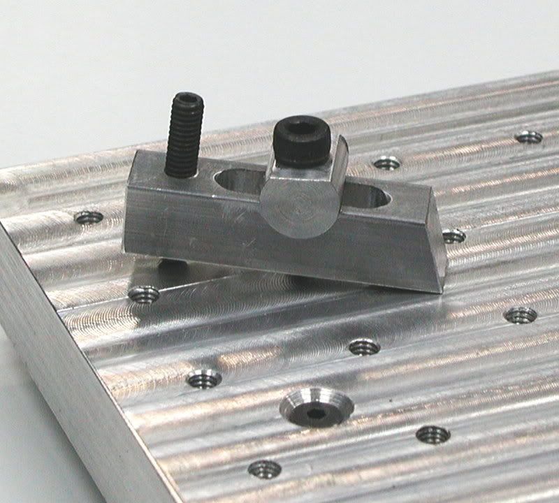

you can buy a milling vise and hold down clamps...
but for the stuff i mill, i find the store bought "hold downs" way too big.... so i made my own base and hold down clamps...
these are very useful when milling plate work...
http://img.photobucket.com/albums/v4...p/P1150169.jpg
each clamp has its own height adjustment thingee.....no need for aditional riser blocks.....
http://img.photobucket.com/albums/v4...p/P1150170.jpg
