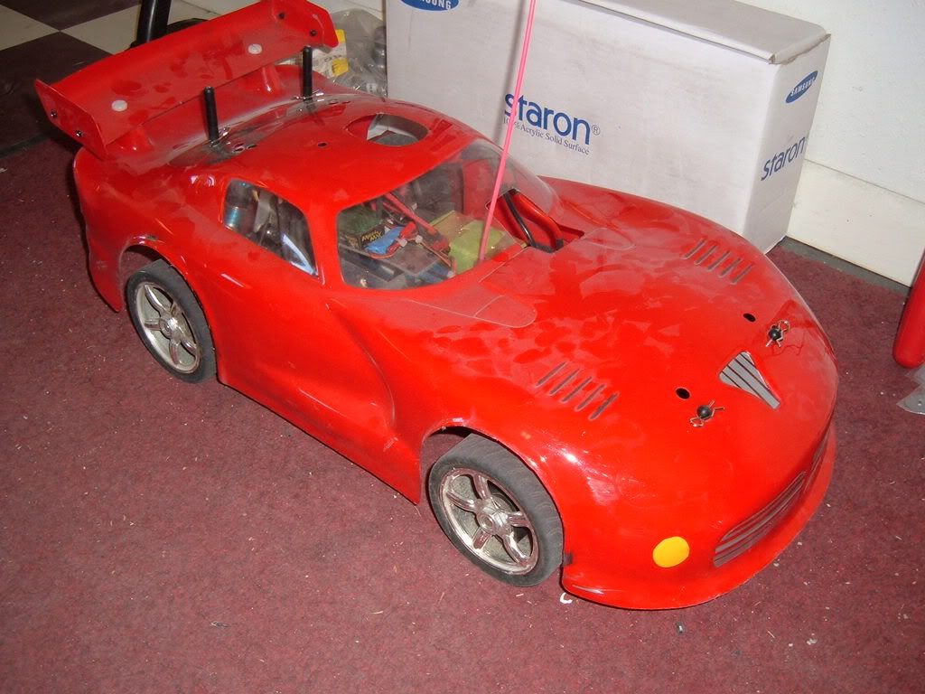

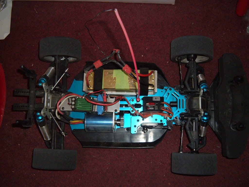

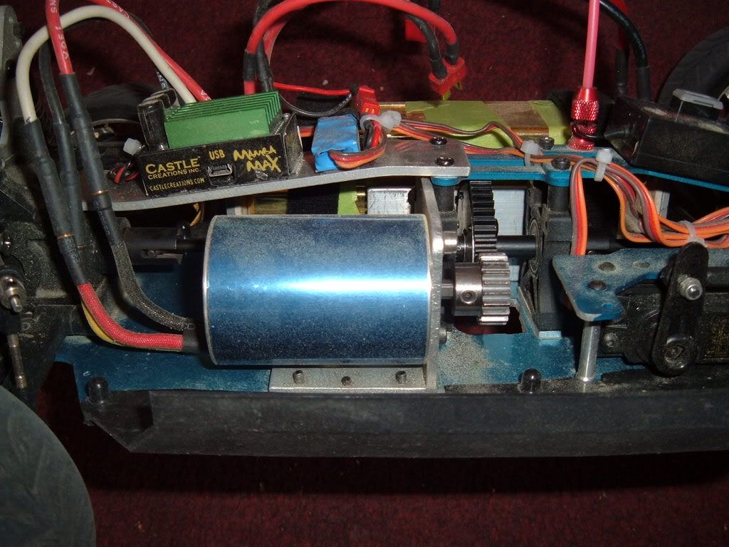

Ok, the car was originally a mbx buggy. I swapped the center diff out for a solid center with the 51t plastic spur. I currently have revo shocks on the front, and need to put them on the rear too. Motor mount was whipped up in a few minutes and the battery tray was left over from the buggy. Using a MM with a fan and a cc bec. Temps are decent, the big kb can sure pull some amps, I can only imagine how the xl models are...
http://i206.photobucket.com/albums/b...p/DSCF1927.jpg
http://i206.photobucket.com/albums/b...p/DSCF1928.jpg
http://i206.photobucket.com/albums/b...p/DSCF1929.jpg
http://i206.photobucket.com/albums/b...p/DSCF1926.jpg
