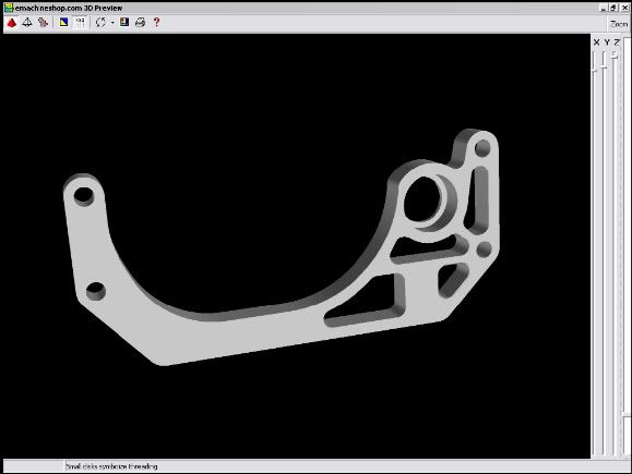

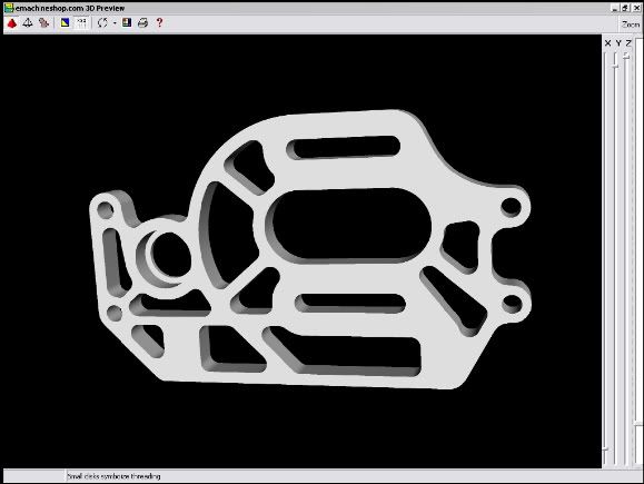

By the way, the motor pod plates have been re-designed a bit to lower cost (Metal Man, you were right in saying I should enlarge the radii lol) and also to get rid of some mistakes in my design lol:
http://img.photobucket.com/albums/v6...peedPod2-1.jpg
http://img.photobucket.com/albums/v6...peedPod1-1.jpg
