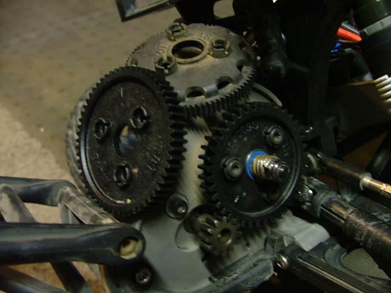

you have to shave the fins down to fit inside the plastic housing its a tight fit but it works, and easier and better solution would be a FLM tranny case :whistle: one of these days ill get one for my slash. i switched to mod1 gearing and can run 40/12 through 40/17 i usually run a 40/14 which is silly silly fast.
http://www.rc-monster.com/forum/atta...8&d=1214712244
Oooooo...that's what I was afraid of. I don't know if I'm willing to grind down my heatsink clamp or not. The FLM tranny is starting to look really good now. :mdr:
I ran my Slash with 40/12 and a 2s lipo for a little up and down my street, but I'll have to wait to try it on 3s and check the temps.
Here's a pic of mod1 gears with the stock 48p spur on top and a mod0.8 (32p) spur for a Jato to the left. Revos use mod1 gears as well as all 1/8 scale buggies.
http://i21.photobucket.com/albums/b2...e/DSCF3376.jpg

wow that looks alot better than the tiny teeth on the stock spur
and i have a load of spurs from my revo aswell
right i have some cash in paypal now so where can i get a 9L from as i cant fine one on mikes site?
and i will get some mod 1 pinions... how many sizes would i need to make sure i can get the correct gearing?
http://www.rc-monster.com/proddetail...=5mmmod1pinion
and will i need a bore reducer to fit the mod 1 pinions on the 9L?
http://www.rc-monster.com/proddetail...rod=RCMreducer

usig the 9L on 3s start with a 40/13 and if your motor is getting hot and the esc alot lower try gearing up to a 40/14 but with either of these i think youll be more than happy as it will still pull a wheelie from 3/4 throttle roll.
and no the gear cover will not fit back on there, but as others told me its no big deal the mod1 gears spit out dirt like its nothing.
