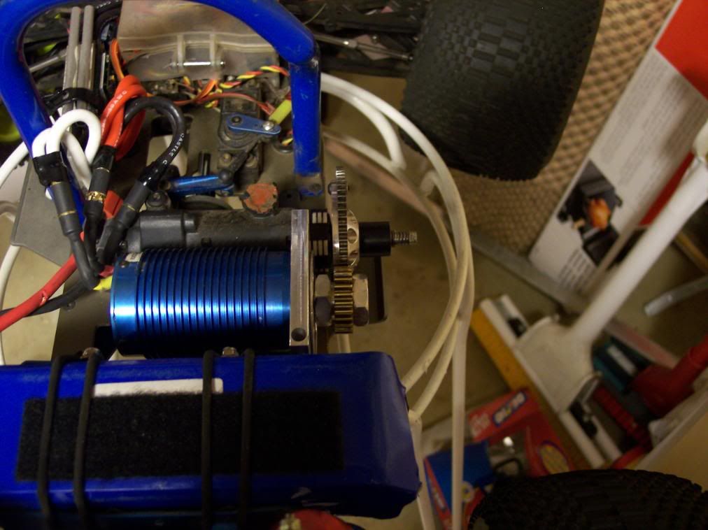

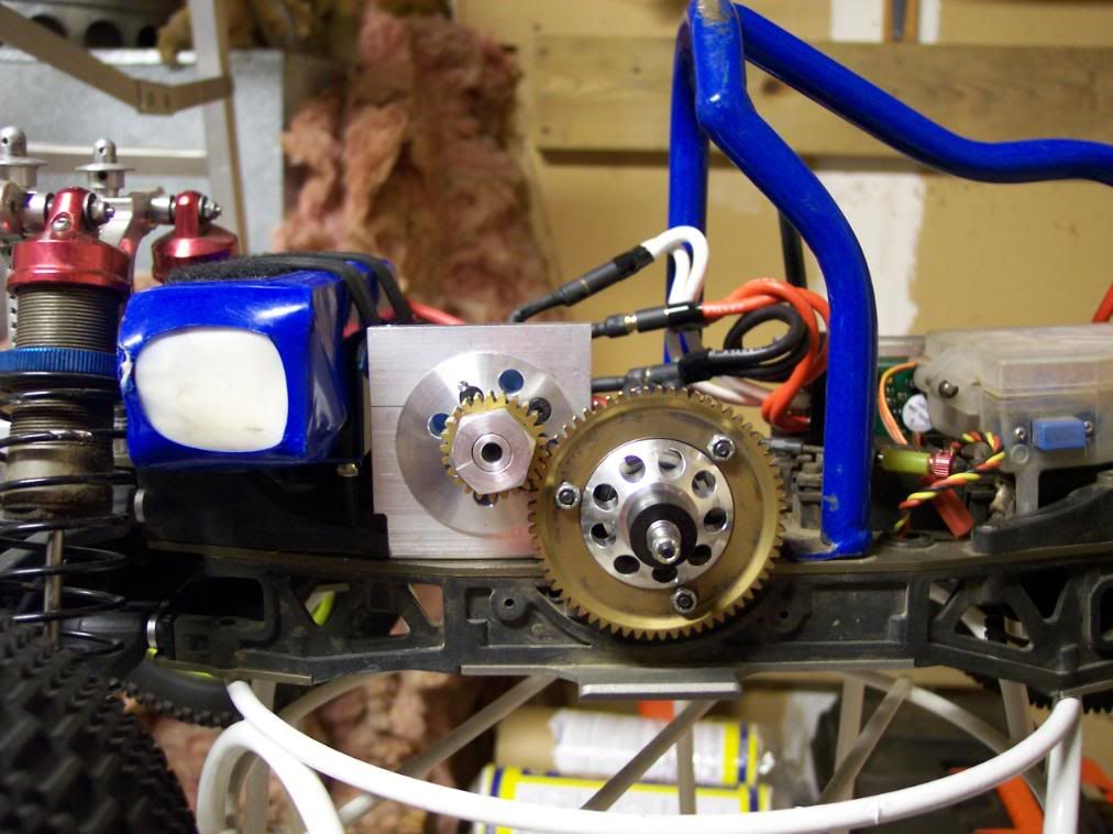

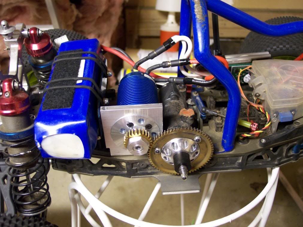

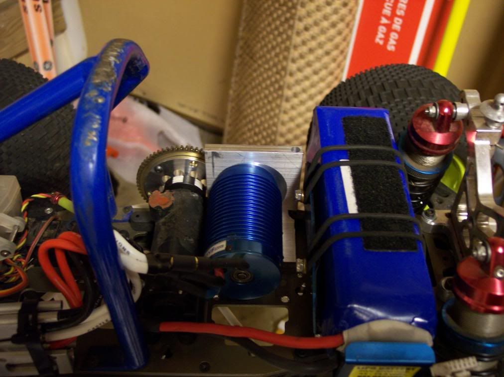

Ok I got the motor mount installed did not have time to run it. Fit and finish were nice bet the production model will be sweet. The dude and I were worried about bracing the larger Neu motor. I can honestly say that I do not believe a brace is necessary. It took quite a bit of force to get the motor and the mount to flex. It fit perfect in the mounting locations and some 4mm button heads to secure it to chassis. It is very rigid. The swivel action is a great feature for setting the gear mesh. So far overall looks like it will be another homerun. I am going to use plastic spurs this weekend so I can tell if the motor mount is flexing causing funny spur wear. Here are some quick pics of it mounted up. gonna have to do some creative work to get the gear cover on. LOL
