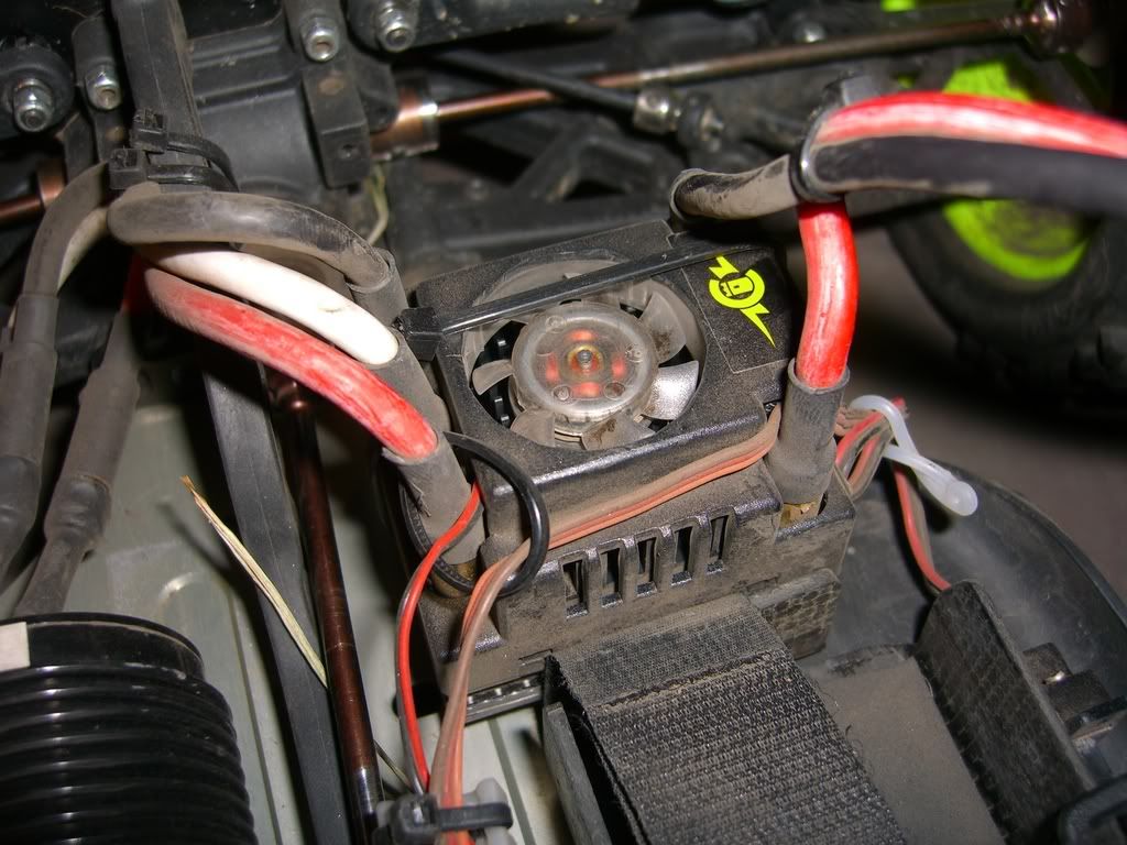

Yes the integy fan fits right where the stock fan fits. I'll see if I can get some pictures for you tonight when I get home.
It looks like the blades catch the grill of the fan and the motors burn out to me. Once I removed the top fan grill all together on my V1 MMMs I havent had a single fan fail... not one. I've got 3 of them running.

30mm fans are what fit int eh case of the MMM. Fan thickness cant be more tha 7mm.
Is this the fan you are using? : http://www3.towerhobbies.com/cgi-bin...?&I=LXTYA2&P=7

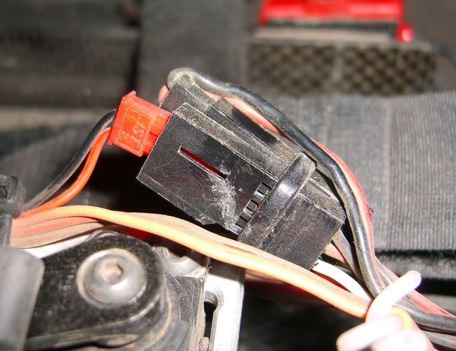

This one. It comes with a JST style plug, but I just use a short servo extender cable and the plug on the extender cable flexes just enought when I push the JST into it that is works without having to bother with changing the JST plug on the fan.
Extender like this.
http://www3.towerhobbies.com/cgi-bin...&I=LXL287&P=ML
Looks like this with the jst fan plug in the extender cable plug.
http://i66.photobucket.com/albums/h2...M/CIMG3409.jpg
This is what it looks like when I cut the top fan grill out and with the Integy fan installed. Earlier in the thread I posted a picture of the mod on the inside of the case to keep the white fan plug from being broken off the bottom of the circut board. The mod for the wire clearance is easy. Just take a hobby knife and shave a little off the case to make the wire slot a little bigger and then wrap the wires with electricle tape right where they would be touching the case.
http://i66.photobucket.com/albums/h2...M/CIMG3404.jpg
