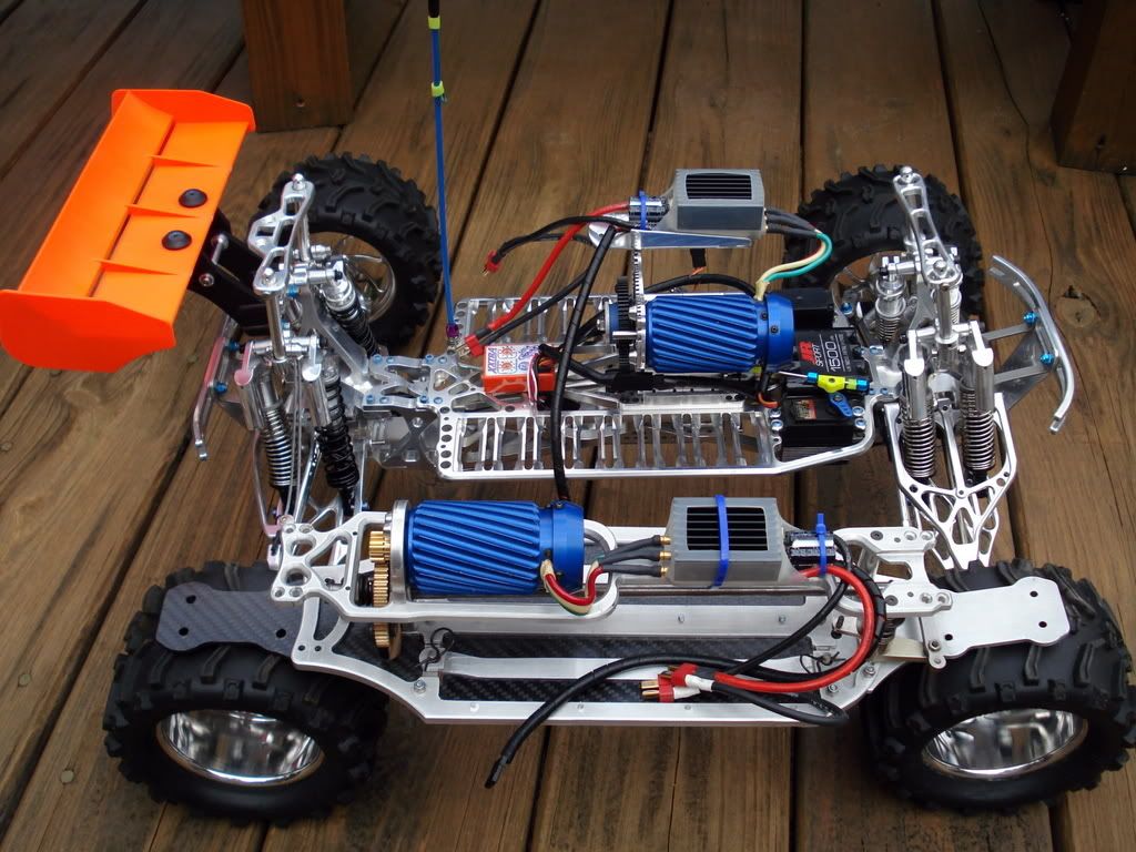

I gave the CNC guy $1500 cash last week to to make his pocket happy!...will be using the 64-70 tooth RR slipper gear and pads but will have to make custom pressure plates to fit the 8mm DirectDrive shaft!....THEY ARE COMING!!!!
Revised prototype should be here very soon,after i ok it he will run the other 15 chassis!....the machines will be set-up already and he will just press RUN on the giant HAAS CNC machine!!!....that baby will spit them out very quickly!!!
DOES ANYONE HAVE 1 OLD R/C MONSTER BATTERY TRAY(for Zippy packs) THEY CAN SEND ME?...I AM ADDING SMALL SLITS IN THE CARBON FIBER BASE TO ALLOW VELCRO STRAPPS OR A BATT TRAY TO BE MOUNTED?...I NEED TO MATCH THE HOLE SPACING!...IF NOT I WILL IMPROVISE!

i am considering adding some small slits in the lower carbon fiber deck so i can velcro in a batt tray...no big deal,i mounted 2 5s Zippys with no problems to my prototype!...velcro on the bottom of the batts and a strap to the upper deck!http://i302.photobucket.com/albums/n...s/DSC01398.jpg

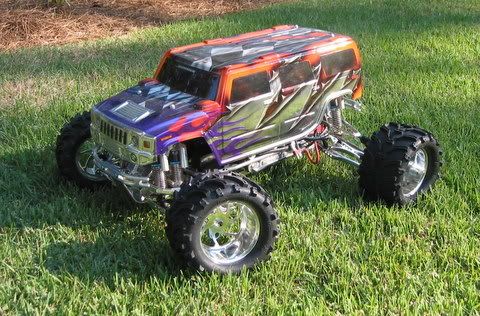

it uses Emaxx parts!http://i302.photobucket.com/albums/n...s/DSC01361.jpg
this is all Emaxx!(but no Traxxass parts)http://i302.photobucket.com/albums/n...s/IMG_4396.jpg
Dual BigMAXXimums!http://i302.photobucket.com/albums/n...s/IMG_4398.jpg
