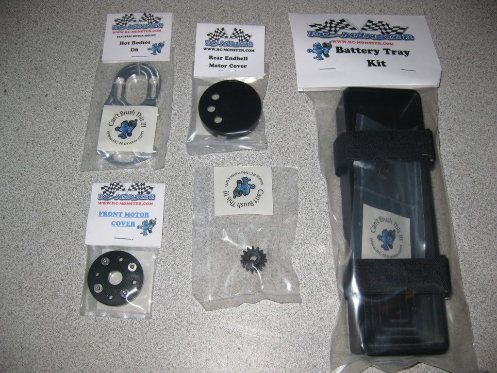

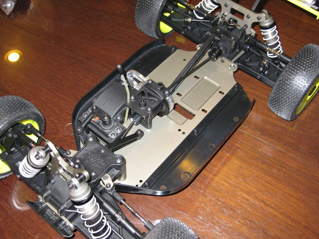

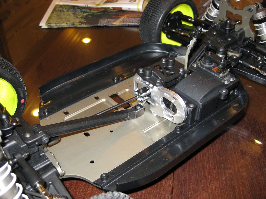

Got some parts from Mike the other day. Ordered the wrong battery tray, so another one is coming. Here is what has been done so far.
http://i199.photobucket.com/albums/a...n/IMG_1095.jpg
http://i199.photobucket.com/albums/a...n/IMG_1096.jpg
http://i199.photobucket.com/albums/a...n/IMG_1098.jpg
magman 02.05.2009 10:00 AM
Looks nice Josh...Getting at the motor screws will be a bit tough though w/out removing the center diff. assembly. I am trying to guilt one of my co-workers into buying one of these....for the $ you can't go wrong!

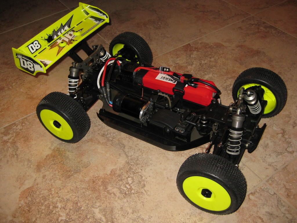

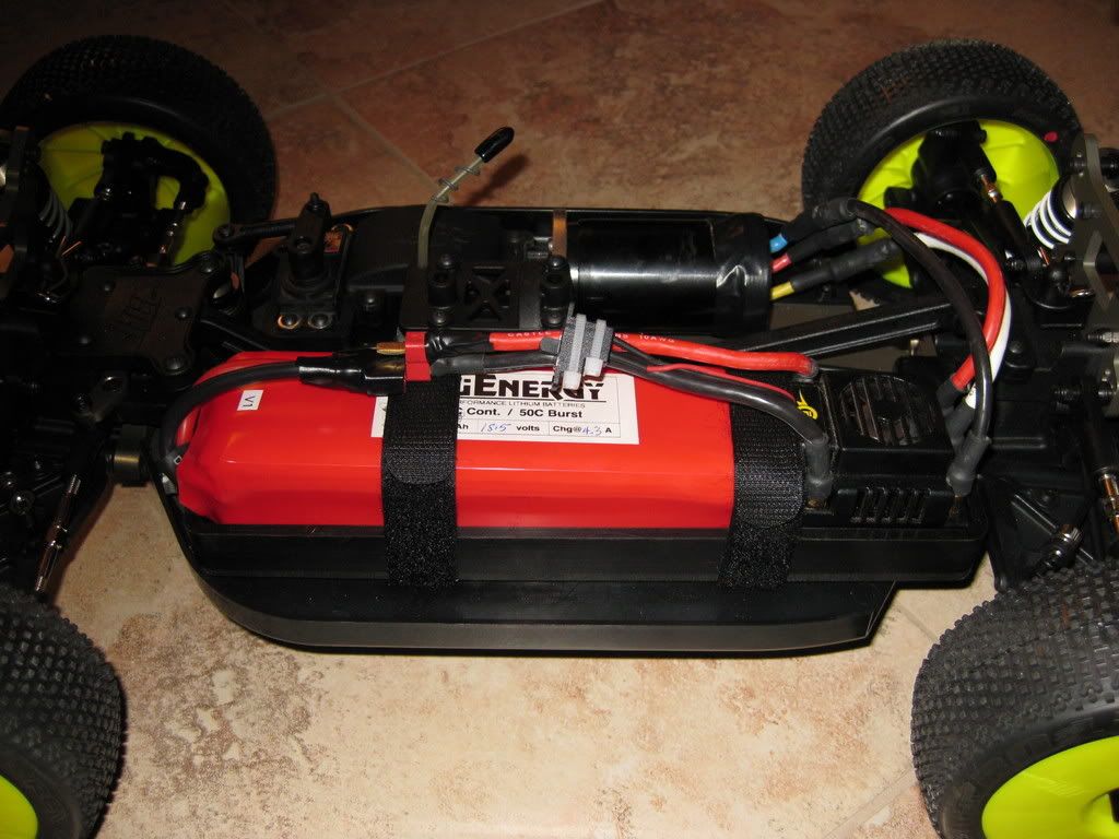

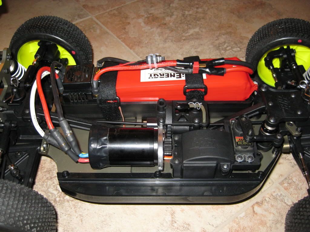

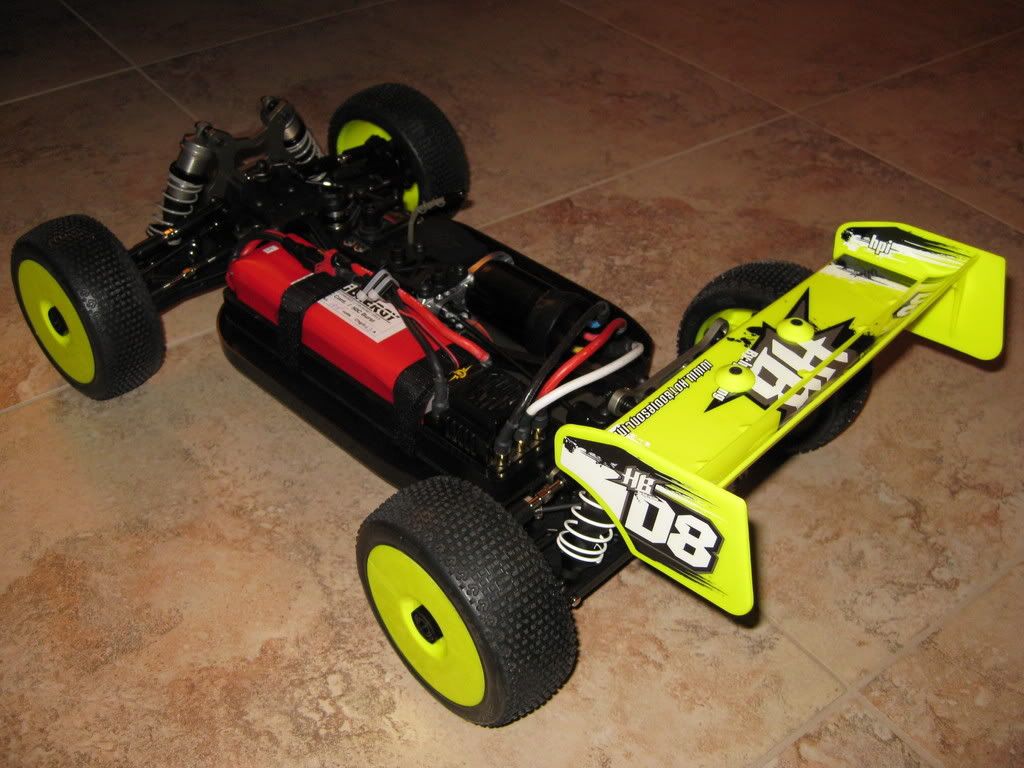

Finally finished! Set is Mamba Monster ESC, Neu 1512/3d motor, and a Neu 5s 4300mah lipo pack.
http://i199.photobucket.com/albums/a...n/IMG_1100.jpg
http://i199.photobucket.com/albums/a...n/IMG_1101.jpg
http://i199.photobucket.com/albums/a...n/IMG_1102.jpg
http://i199.photobucket.com/albums/a...n/IMG_1103.jpg
http://i199.photobucket.com/albums/a...n/IMG_1104.jpg
http://i199.photobucket.com/albums/a...n/IMG_1105.jpg
BL_RV0 02.16.2009 12:17 AM
Nice!!! I bet it was the hardest step getting that deans connector on! :lol:
Steve182 02.16.2009 02:20 AM
Nice rig! I have been drooling over the D8's since they came out. Has to be the best buggy for your buck on the market right now.
MetalMan 02.16.2009 02:36 AM
There it is :wink:
JeffEmbracedDC 02.18.2009 10:02 AM
Just a tip for whoever...
It's probably much quicker to access the screws by uscrewing the radio/servo tray and flipping it out of the way than removing the center diff. At least that's the case with the Losi 8ight.
Super slick build. Makes me want one :)
-Jeff
jnev 03.08.2009 08:55 PM

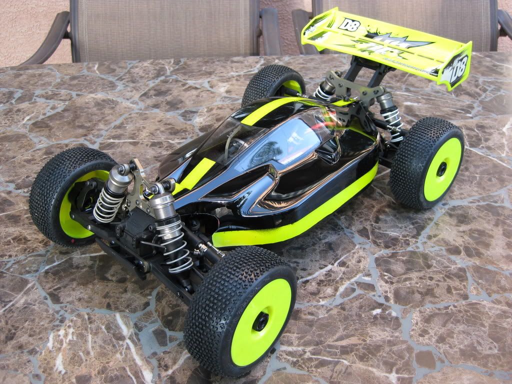

Finally painted the body. Now I really want to just look at it. Its too clean and shiny to run. :wink: I have only tested it in my garage. Haven't gotten a chance to go anywhere to run it yet...
http://i199.photobucket.com/albums/a...n/IMG_1130.jpg
http://i199.photobucket.com/albums/a...n/IMG_1131.jpg
magman 03.08.2009 09:41 PM
Looks nice Josh!
ssspconcepts 03.08.2009 09:49 PM
That's clever...mounting the esc inside the battery tray. I would think that Mike could even cnc a tray that has two compartments...one for the battery and one for the esc. You might be on to something!
magman 03.08.2009 09:59 PM
True... I still prefer to mount the esc up higher, especially the mmm because of the fan...the though being a little harder for dirt to get into the fan
