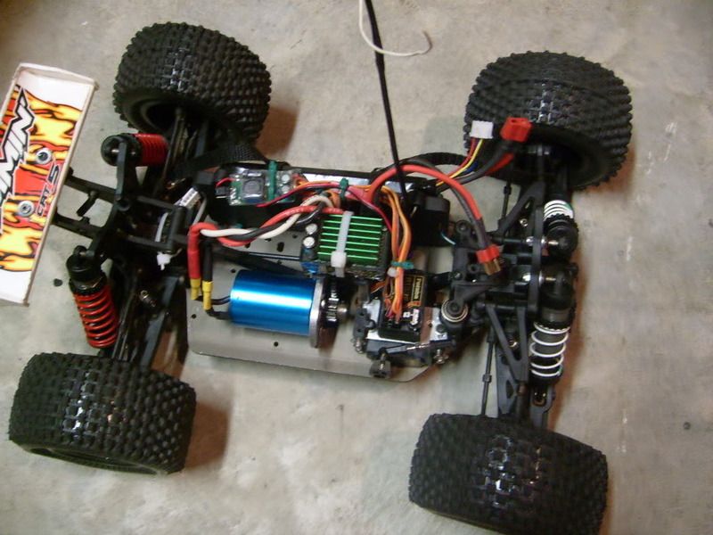

drkdgglr 07.21.2009 05:03 AM
Mini Ste
Medusa 36-60-1300
MGM 8s140a
Dimension Engineering sport BEC
Hyperion G3 35c6s2600mah
Stock wheels
Gearing 20/42
Weighs 2.2kgs / <5lbs
GPS@49mph
Closed the front&rear of the motor with duck-tape.
No motor temps. I kan keep my finger on it after 10 minutes of speed runs and bashing in the sand.
http://i798.photobucket.com/albums/y...90711_0071.jpg
