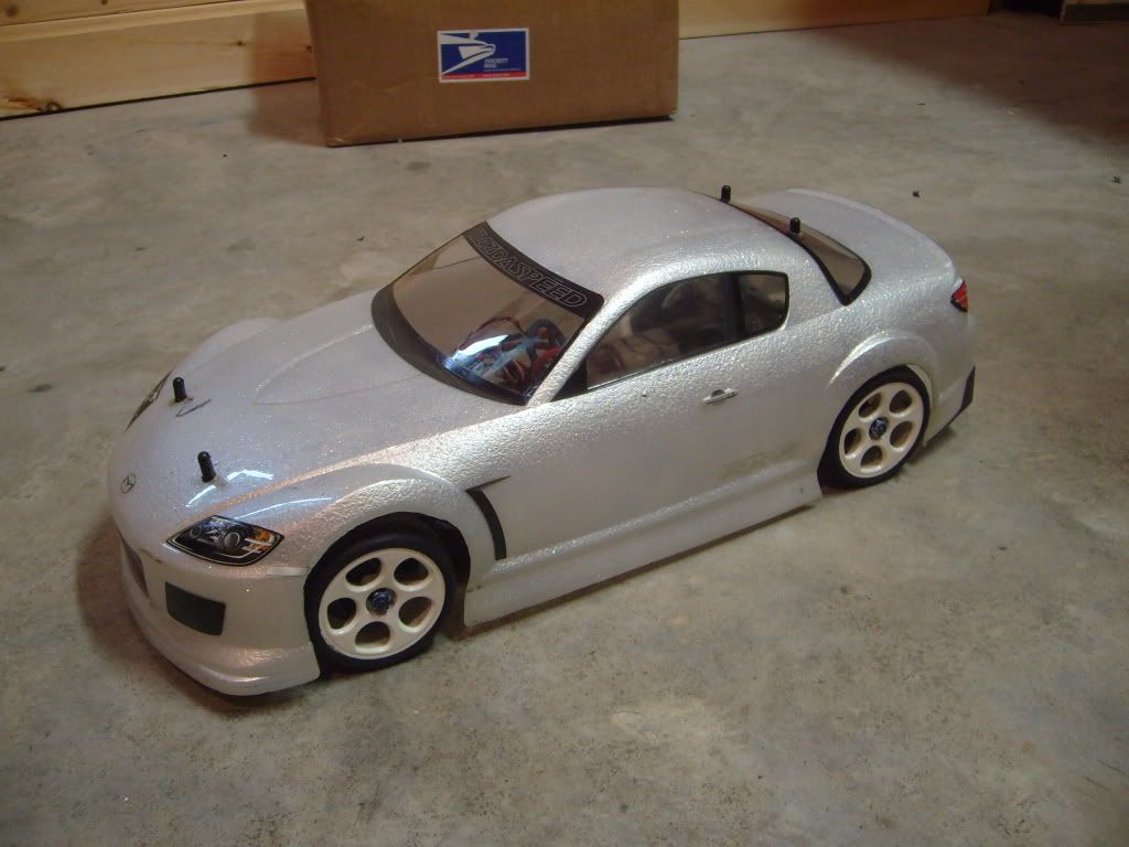

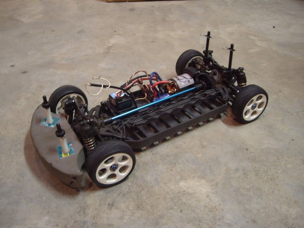

Metallover 06.12.2009 02:25 PM

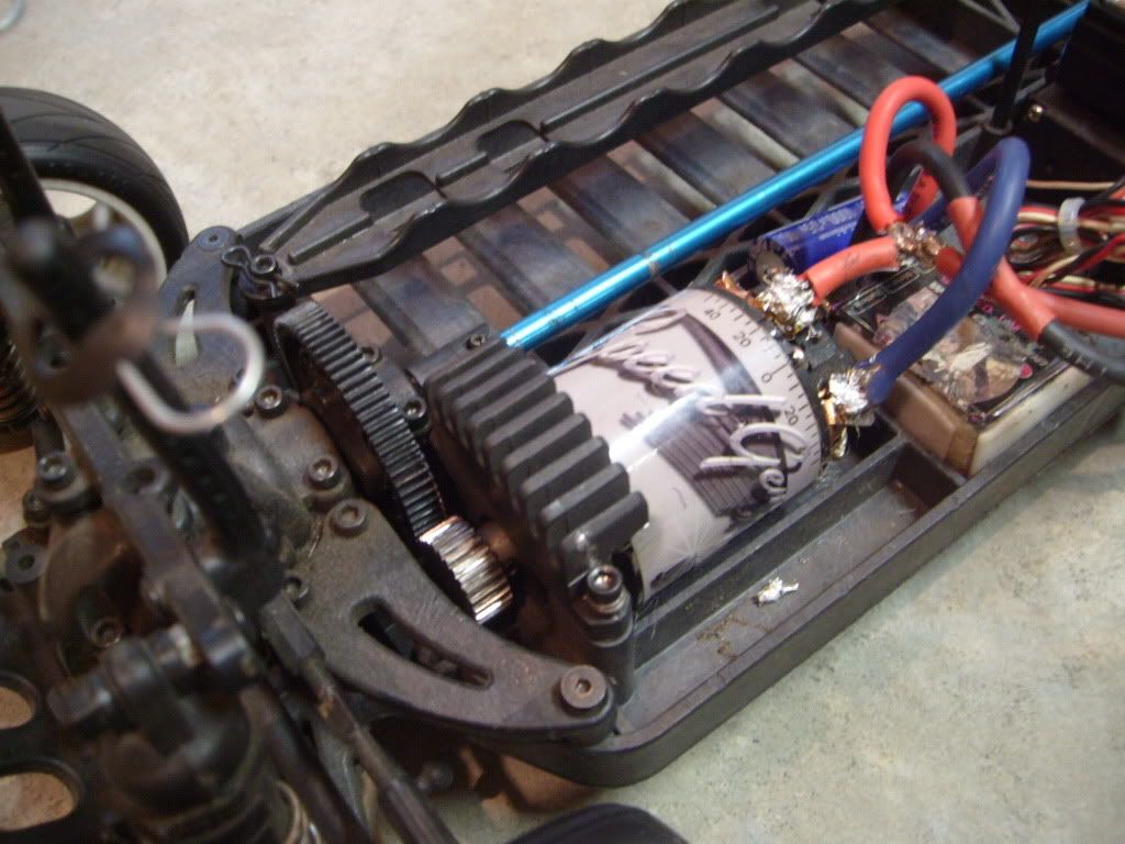

I got the tc3 yesterday. came all thrown in a box with no packaging to speak of. The foam front bumper wasn't held down so I fixed that. I don't like how the gear mesh is set either... It came with drift tires on it. Body is pretty nice- good flexible strong lexan.

I like how my 4s lipo will fit in there after some dremeling, so I think I'll go with the 4s system. Can anyone tell me what it will take to switch to a 32p spur gear?

snellemin 06.12.2009 02:49 PM
Servo city sells 32P spurs. I have a 44t 32P spur in one of my pan cars. The GENX 10 of mine uses a Traxxes 54T 32P spur. I just drilled out the center a bit to make it fit properly.

The diameter of the spur gear on my tc3 is about 40mm. what's the diameter of your 44t spur?

Dunno man. Dont have the car here with me. Figure that 44T 32p is equal to about 66T 48P. BrainG has the gear diameter calculator. 44T is equal to 36.5mm.
