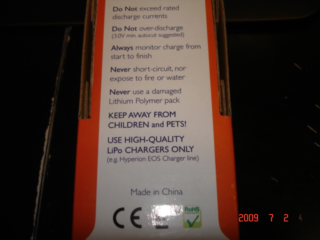

1 Attachment(s)
If anyone is wondering where they are made...
