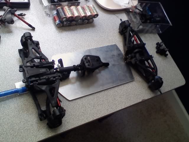

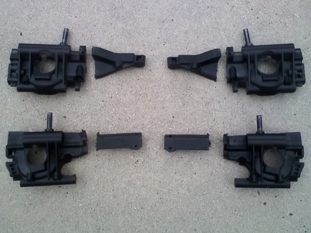

First off today I cut the Bulkheads down so that the electronics and batteries could fit in.Before I cut them though I measured how far it was from the center of the Rocker post to the shock mounting hole. Then I got out the scroll saw and hacked away at the Bulkheads.
After I got those cut I finalized the chassis drawings. And taped them to the piece of 1/8th" 6061-T6 aluminum.

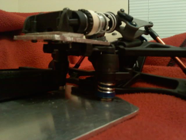

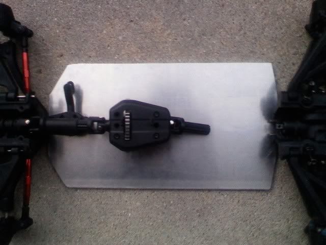

After a couple hours of cutting and filing I came out with this..

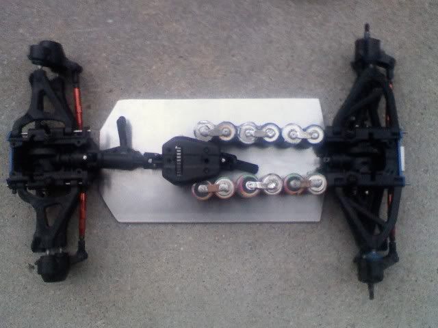

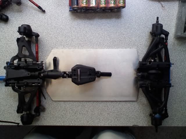

For cutting aluminum for the first time andonly having hand tools I think it came out good. But after cutting it I realized the parts where the front and rear of the chassis hook on are probably too thin. Unfortunately, I don't have material to make another one so this one will have to do for now until I get some 7075.Then I will put the diffs on risers so that the front and rear can be wider. I still have some more filing ,drilling,and bending to do but here is how it should turn out and how it looks right now.
This last picture is just to give you an idea of where the batteries will be going. Obviously they aren't going to be the actual packs that I will use. I plan on using some lipo 5000mah 7.4v packs.

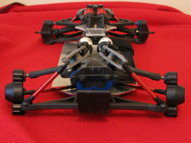

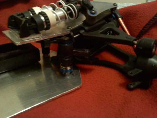

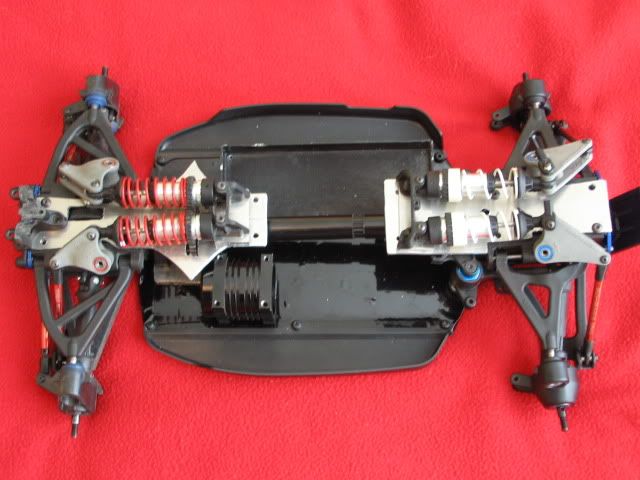

Wow I haven't posted here in forever..moved to Mobile, Alabama and all my stuff has been in storage. Got everything out of storage and I have been able to work on this project here and their and I thought I would share.I have mounted the front end and rear ends and made the upper plates for both. I also got a battery tray mounted and to hold the batteries in it will use two velcro straps like the one in the picture. I'm very excited about how this project is turning out..:nod: and I haven't even gotten to the bodies, wheels, or tires. I will let the pictures speak for themselves..
http://i8.photobucket.com/albums/a2/...8/IMG_0852.jpg
http://i8.photobucket.com/albums/a2/...8/IMG_0858.jpg
http://i8.photobucket.com/albums/a2/...8/IMG_0830.jpg
Next, I will be ordering a Rc8 servo saver to complete the steering and some Revo drive shafts to cut up and put in the center to link the center diff to the front diff.

I got the steering set-up and the mud guards in the mail. I decided to not put the mud guards on until I get the body to make sure I place them so the body fits tight. I did however mount the steering and it fits very nicely. I had to trim the bulkheads slightly because of clearance issues and had to move the steering rack from the tops of the bell cranks to the bottoms. It looks like this will provide good steering geometry. I'm very happy how the steering fits into place.

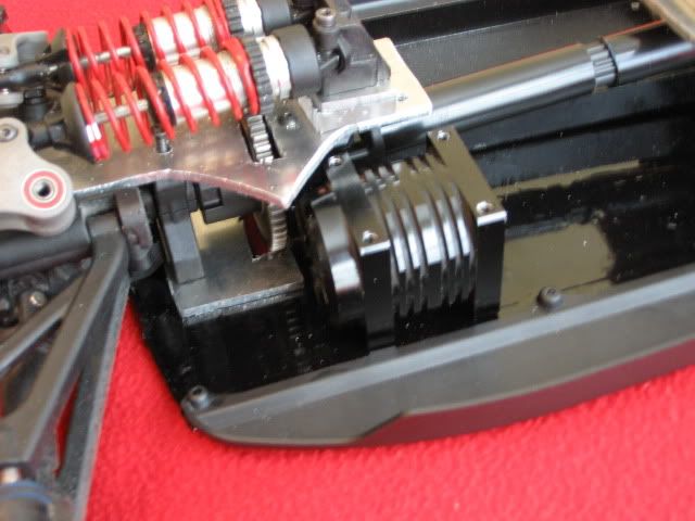

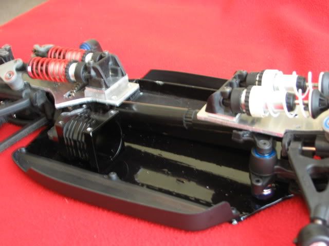

After a busy week of school and soccer and getting a job at a local movie theater.. I made some progress on the Evo8. First I cut up the Revo drive shafts and put a male half shaft in the middle of two female shafts to make the center drive shaft. Then I cut up the Rc8 steering top plate so the drive shaft could fit. I also had to grind a slot in the bulkhead upper deck because of drive shaft clearance issues. After I got the center drive shaft taken care of I took the parts I had used from the Slayer drive-shafts on the center diff and replaced them with the new Revo drive-shaft parts so that I had complete Slayer drive-shafts.
I got the mudguards mounted and had to cut down the chassis slightly in the front to make them line up. I think those turned out great.
Next, I mounted the Tekno motor mount by drilling slots in the chassis. As you can see from the pictures its alittle crooked so I will have to fix that with alittle bit more drilling.
Lastly, I got a piece of black vinyl from a teacher at school for free and decided to try wrapping the chassis in it. Its a little bit shinier than I would like and also has quiet a few air bubbles in it. I figure you won't see too much of the top of the chassis once all the electronics are in place.I didn't wrap the top decks yet becuase I'm still trying to decide if I like it.. what do you guys think? I know on the bottom with the vinyl or with it I will probably be a lexan chassis guard and so I really wouldn't need the vinyl on the bottom since I would paint the chassis guard black.
