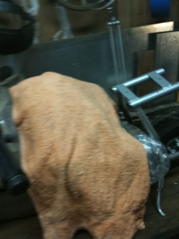

Had to cover the motor in plastic and a wet towel to shield it from welding sparks/heat.
http://i160.photobucket.com/albums/t...1249324574.jpg

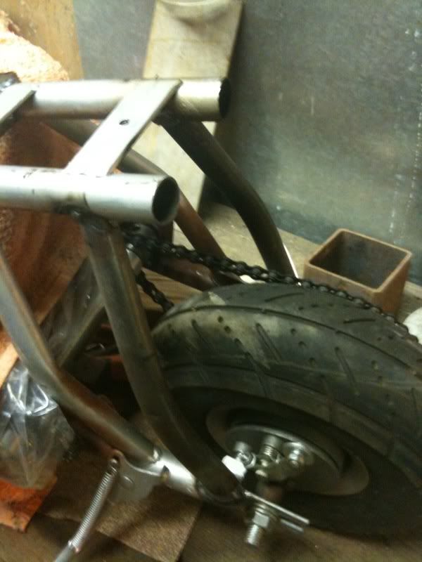

Bent/welded rear frame braces:
http://i160.photobucket.com/albums/t...1249324585.jpg

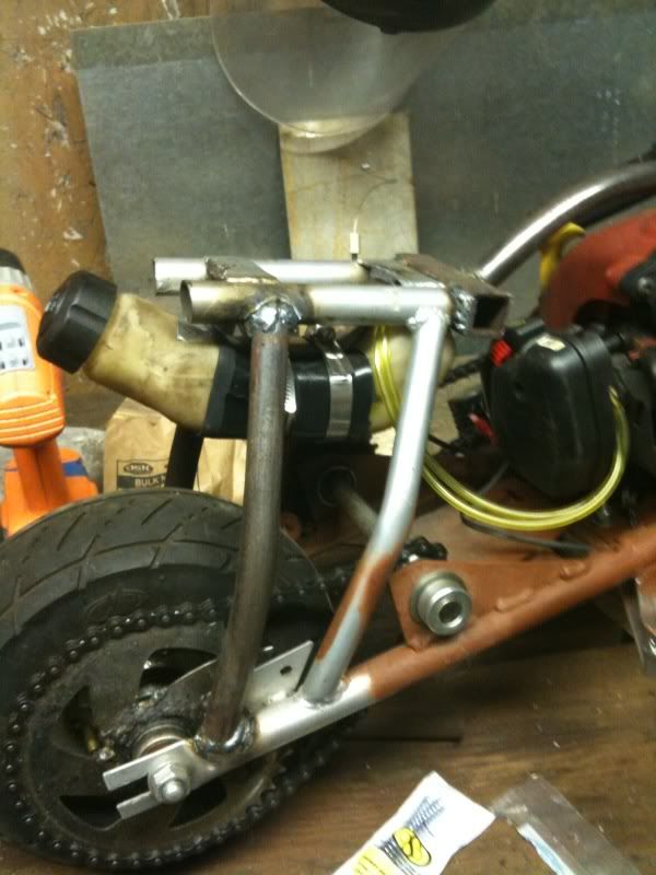

Made a bracket to conform to the fuel tank- welded it, and hoseclamped the gas tank to it, with rubber guards.
http://i160.photobucket.com/albums/t...1249324570.jpg

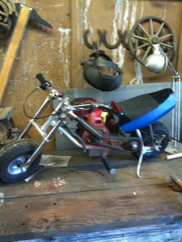

BL_RV0 08.11.2009 01:00 AM
It lives!
Holy shit, I got alot done in 3 hours...

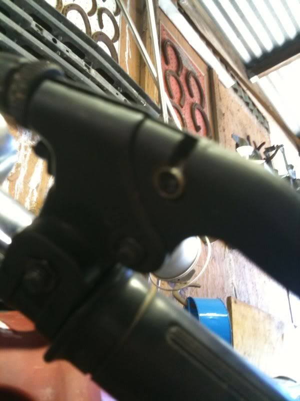

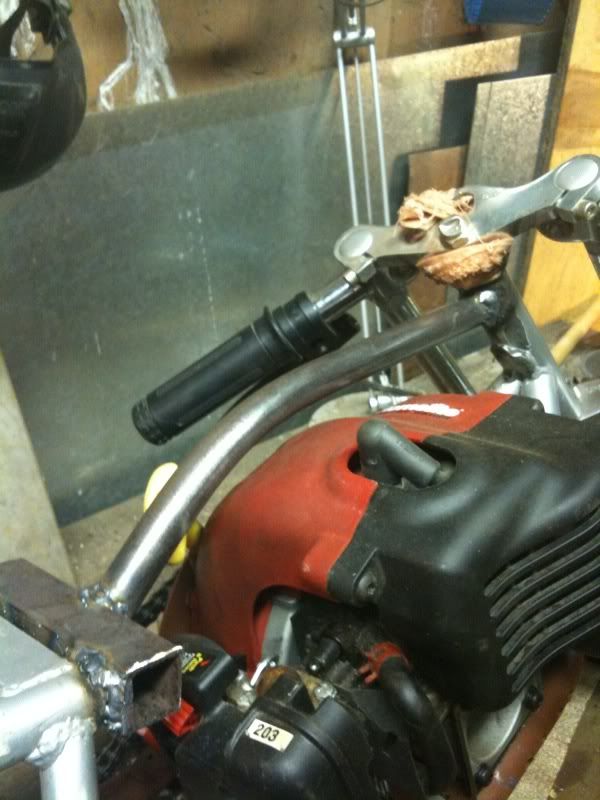

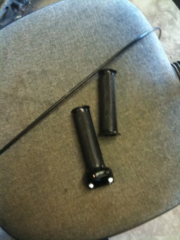

Throttle I got off ebay:
http://i160.photobucket.com/albums/t...1249966322.jpg

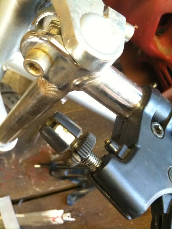

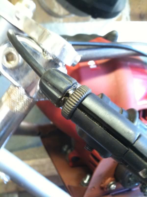

Needed a brake cable tension adjuster, found one on a old bike I had laying around.
http://i160.photobucket.com/albums/t...1249966316.jpg

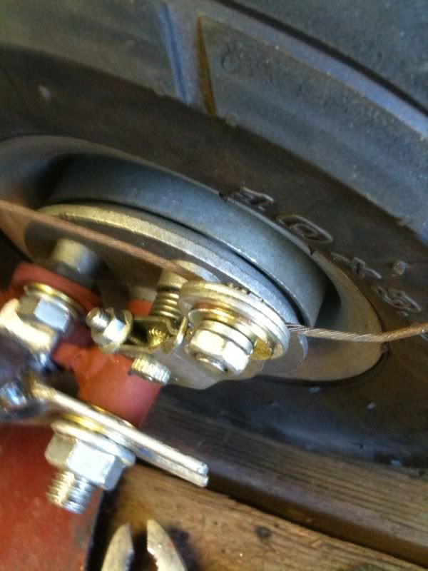

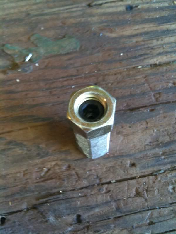

Needed a end for the brake cable so I made one out of some 1/4" brass tubing, and soldered it to the cable.
http://i160.photobucket.com/albums/t...1249966321.jpg
Cable installed on the brake lever:
http://i160.photobucket.com/albums/t...1249966315.jpg

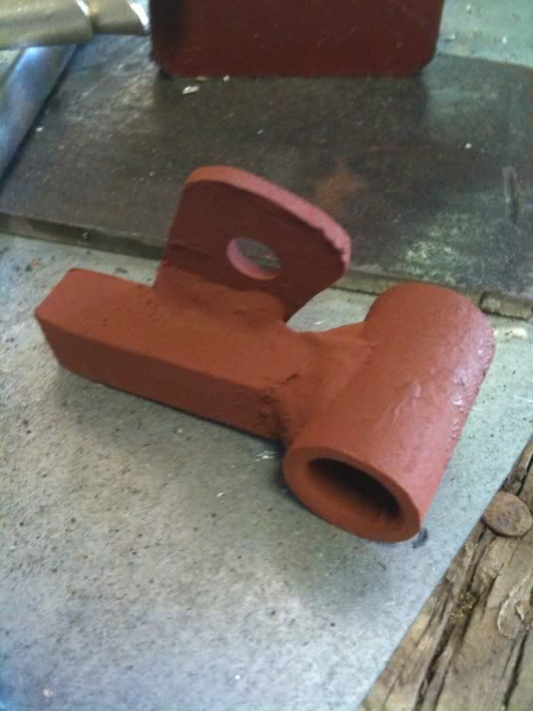

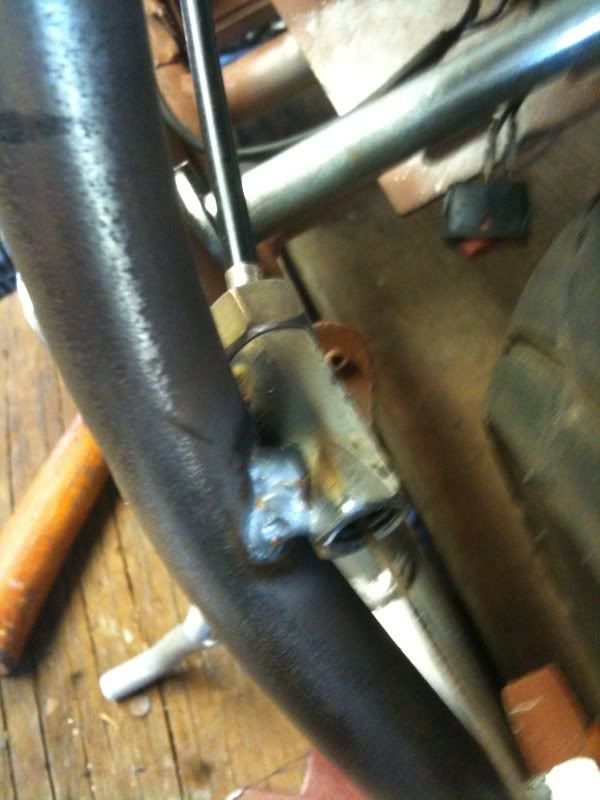

Had to make a guide for the brake cable:
http://i160.photobucket.com/albums/t...1249966317.jpg
Welded it on:
http://i160.photobucket.com/albums/t...1249966390.jpg

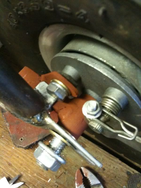

Can you guess what this is?
http://i160.photobucket.com/albums/t...1249966392.jpg
You might have guessed right:
http://i160.photobucket.com/albums/t...1249966396.jpg
Brakes hooked up on the rear:
http://i160.photobucket.com/albums/t...1249966391.jpg

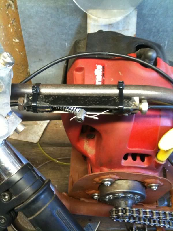

Throttle return/connector I made:
http://i160.photobucket.com/albums/t...1249966420.jpg
All together:
http://i160.photobucket.com/albums/t...1249966421.jpg
