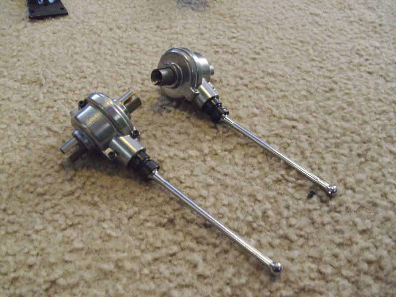

Just ordered some Lst/Aftershock differentials along with some revo stub axles :)
brushlessboy16 07.10.2009 11:17 AM

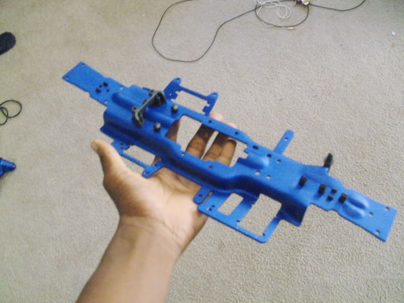

Got my Chassis and diffs, still waiting on revo output shafts and the body...
http://i152.photobucket.com/albums/s...0/revo/008.jpg
http://i152.photobucket.com/albums/s...0/revo/010.jpg
http://i152.photobucket.com/albums/s...0/revo/009.jpg
http://i152.photobucket.com/albums/s...0/revo/015.jpg
http://i152.photobucket.com/albums/s...0/revo/013.jpg
http://i152.photobucket.com/albums/s...0/revo/014.jpg

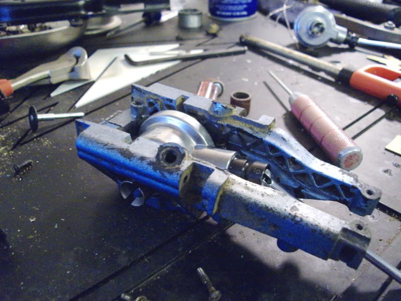

In the last picture you can see some flaws in the casting process.. the set screw of the couple grinds on a peice of slag on the case. nothing a dremel wont fix.

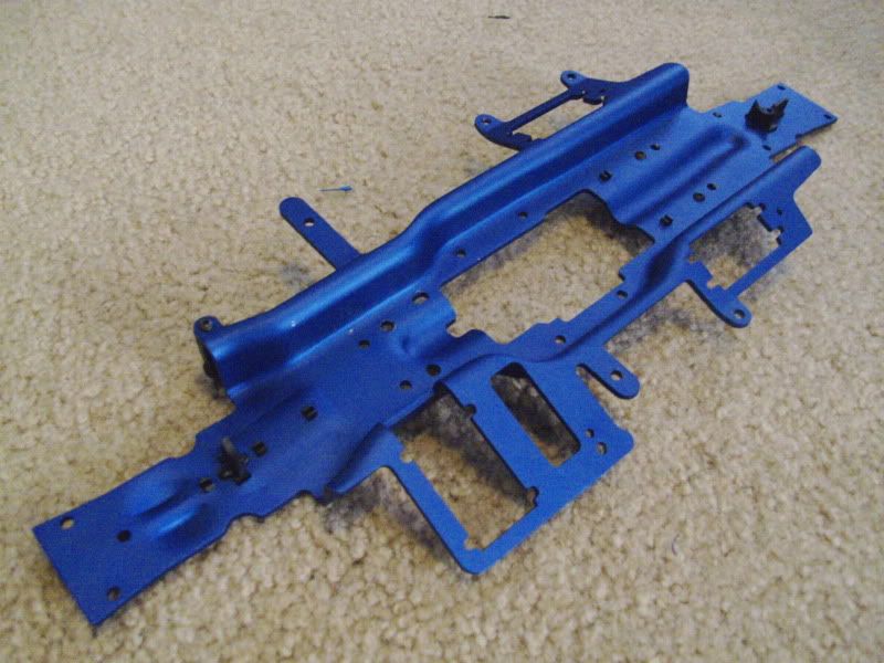

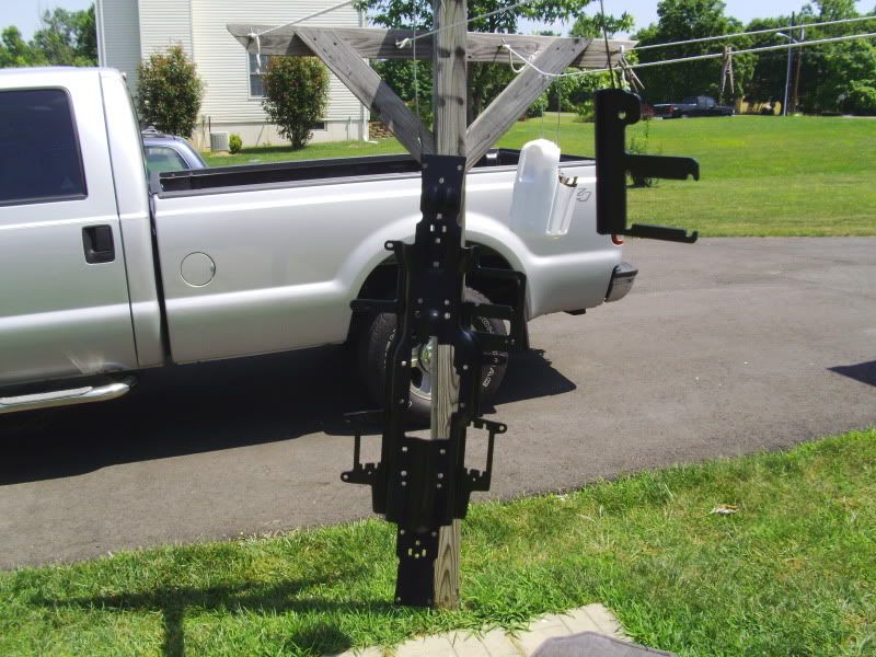

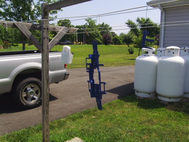

Painted the new 3.3 chassis
http://i152.photobucket.com/albums/s...0/revo/016.jpg
http://i152.photobucket.com/albums/s...0/revo/017.jpg
Modded a spare set of bulkheads i had as a test
http://i152.photobucket.com/albums/s...0/revo/018.jpg
http://i152.photobucket.com/albums/s...0/revo/019.jpg

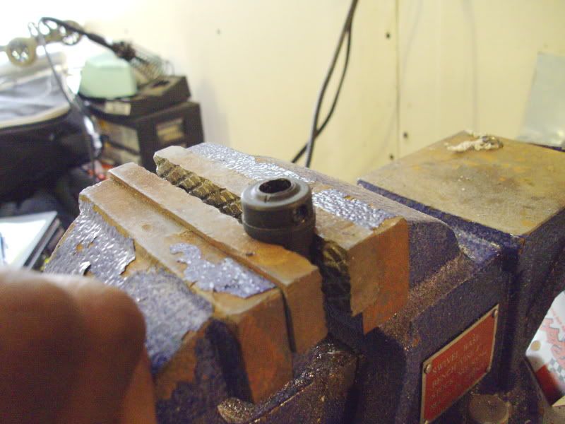

Modified the stock drive yolk to fit until i get my rc monster pieces
http://i152.photobucket.com/albums/s...0/revo/024.jpg
http://i152.photobucket.com/albums/s...0/revo/026.jpg

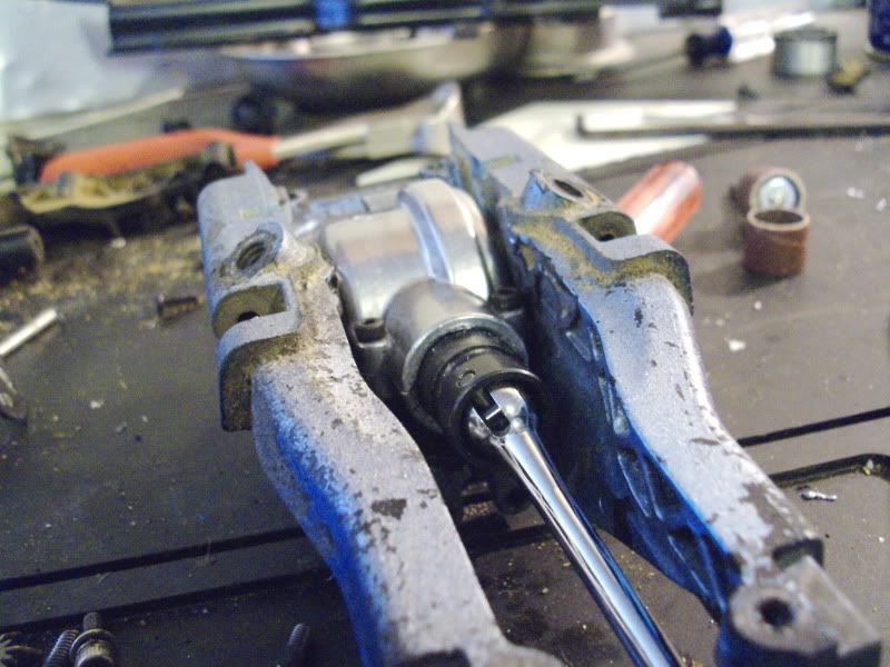

I also took the stock revo wheel output shaft and hacked the end of the piece off, then had to grind it down to go into the case and spin without binding.
started to shave the cases, so far the rear bulks are about 80 percent done, but still need some tweaking..

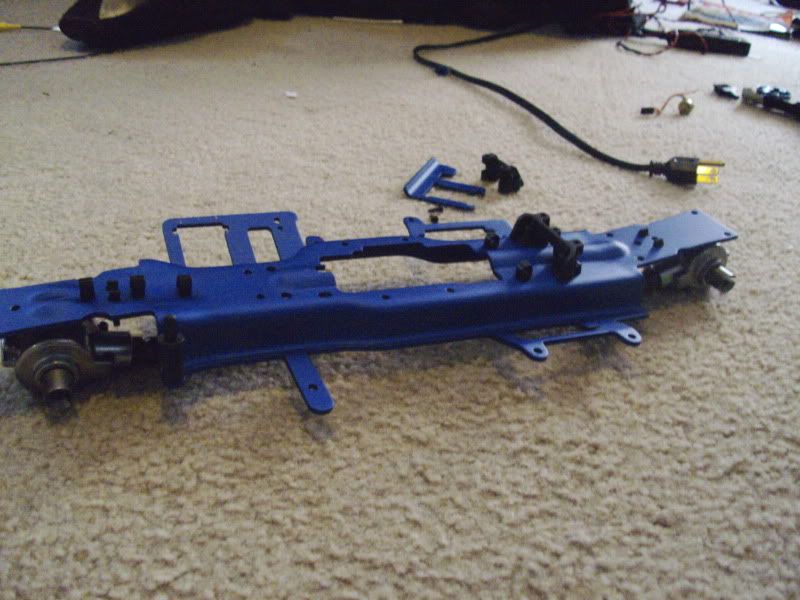

Where to begin.. We can start with
Motor/Transmision/Roll bar

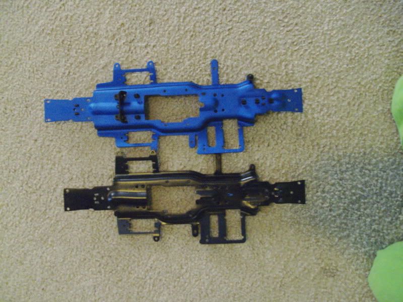

- Well i have come to find the differences betweek the 2.5R chassis and 3.3 chassis. Tthe 2.5r will accomodate up to a 44t spur (what i have) with no clearance issues, the 3.3 is made for the 40t only. I had to raise the one side of my transmission with washers to get the spur to clear the chassis.
http://i152.photobucket.com/albums/s...PICT0004-1.jpg
http://i152.photobucket.com/albums/s...o/PICT0002.jpg
-The motor mount didnt need much work for going to the new chassis, two areas needed to be clearanced, nothing major. For more gearing adjustment and asthetics, i replaced the cap head scews that connect the motor mount to the chassis with countersunk units..
http://i152.photobucket.com/albums/s...PICT0011-1.jpg
-With the original setup the revo was very unbalanced, and had no on-power steering,hopefully with the weight of the battery and motor placed diagonally across from each other I will get more steering and front traction.
http://i152.photobucket.com/albums/s...o/PICT0027.jpg
-The roll bar is just for lazy guys like me to pick up the truck, I had two that werent being used so I modified one to fit. It uses the stock holes but the outer mount must be clearanced so that it does not hit your pinion, I also cut down the roll bar to the highest line to fit lower profile bodies.
http://i152.photobucket.com/albums/s...PICT0013-1.jpg

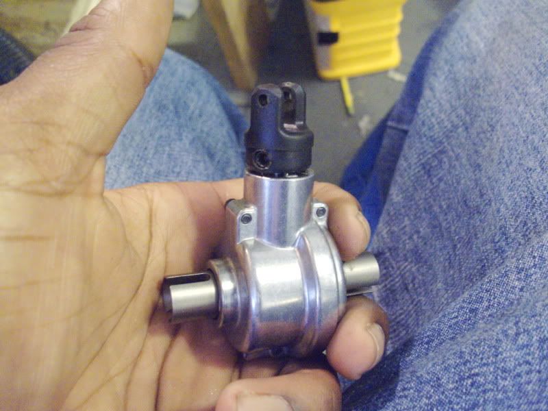

Losi Differnential Mod
First off I'd like to say that all mail carrying services are starting to annoy me.. The revo stub shafts that were do in today were not delivered. and the body that was supposed to be here tuesday came today...

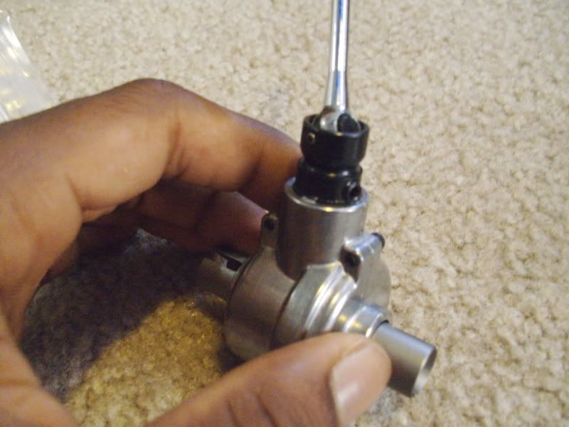

-where to begin... to complete this mod you will need four extra stub shafts... if not you need to make your own out of 6mm stock. These diffs went together smoothly. one came pre shimmed out of the package, the other did not. (i ended up picking up 2 stub shafts at the local hobby shop- that is all they had) The rear diff received the modded stub shafts.. and the front diff was dead in the water when the other shafts did not arrive in the mail.. So after spending an hour trying to find a suitable material- i found an old car hood prop that was 6mm OD.. after some creative cutting and drilling this is what I ended up with.
http://i152.photobucket.com/albums/s...PICT0017-1.jpg
They install just like any dog bone cup would.
http://i152.photobucket.com/albums/s...PICT0018-1.jpg
http://i152.photobucket.com/albums/s...PICT0019-1.jpg
http://i152.photobucket.com/albums/s...PICT0020-1.jpg
http://i152.photobucket.com/albums/s...o/PICT0021.jpg

zeropointbug 07.11.2009 11:39 PM
Sorry if I haven't read the whole thread, but are those Mike's diffs? Or from another truck? They are nice anyhow. Keep up the work, get er' done!
brushlessboy16 07.11.2009 11:40 PM
They are the diffs from a Team Losi Lst
